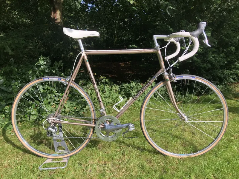

Re: 1981 Claud Butler Colstar #035210
Peachy!":2q9ohhyu said:
I desperately wanted to test out the Colstar today, so when the rain backed off to just mildly moist, we dashed out.. :D
And I wasn’t in the bit disappointed, I’m not sure what I was worried about but this bike felt so good..
In comparison to the Majestic, unsurprisingly its like chalk & cheese, at 23lb & 10 oz, the Colstar is over 3lbs lighter than Madge, and with 73 degree angles and a 40” wheelbase compared to 72 & 43” it was very sprightly in the corners… the Shimano indexed gears of course were a joy to operate sequentially going uphill compared to the friction lever last minute guess on the Majestic.
I’m not so sure about the seat position yet, I’ll take an allen key out with me next ride and try a few different places. :D
So here is what she's wearing right now, in this semi-finished state;
Looking good with the white tape etc.. Silver is not my favourite colour, but having seen this and done the Pro its growing on me. I see the 49 CB Cat list 'the famous CB Silver' for the path models inc the Inter, I could do mine that colour again and have a matching pair. There's several coats of paint on it currently, none look like silver.

Re: 1981 Claud Butler Colstar - Shimano 105 #035210 FINISHED-ish
Yes yes, I know it needs updating!!!
**EDIT** just for you David..... :wink:
Frame: 24” Reynolds 531 Butted throughout
Fork: Reynolds 531 Butted
Dropouts & fork ends: Campagnolo 1010
Headset: Shimano Dura-Ace HP-7410 (’93)
Stem: Shimano Dura-Ace Hs-7410 (’93)
Handlebar: Cinelli 66 Campione del Mondo, 42cm
Bar Tape: Claud Butler
Shifting Brake Levers: Shimano Dura-Ace ST-7801 (’04)
Brake Calipers: Shimano Dura-Ace BR-7800 (’04)
Brake Pads: Shimano Dura-Ace
Brake Cables: Shimano BC-9000
Front Derailleur: Shimano Dura-Ace FD-7800 (’04)
Rear Derailleur: Shimano Dura-Ace RD-7800 (’04)
Derailleur Cables: Shimano Dura-Ace SIS OT-SP41
Cassette: Shimano Ultegra CS-6700 10 speed SIS 12-30t (’19)
Chain: Dura-Ace 10s CN-6701 ('20)
Cranks: Shimano Dura-Ace FC-105SC
Chainrings: Shimano
Bottom Bracket: Shimano Dura-Ace SM-FC7800 (’05)
Pedals: Shimano Dura-Ace PD-7400 (’92)
Rims: Wolber Competition Gentleman 81 27”
Hubs: Shimano Dura-Ace FH-7700 (’99) & HB-7700 (’97)
Hub Skewers: Shimano Dura-Ace QR (’99 & ’97)
Nipples: Chromed bronze
Spokes: Stainless Steel double butted
Tyres: Panaracer 27” Pasela 115psi
Saddle: White Turbo
Seatpost: Shimano 600AX SP-6310 (’84)
Bottle & Cage: Elite
Weight: 22lb 9oz - 10.234Kg

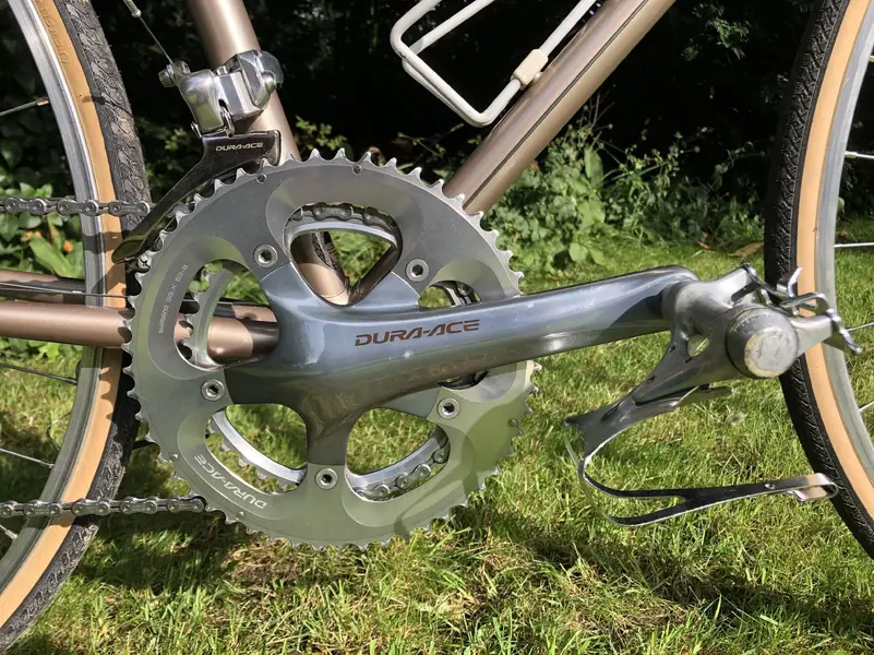

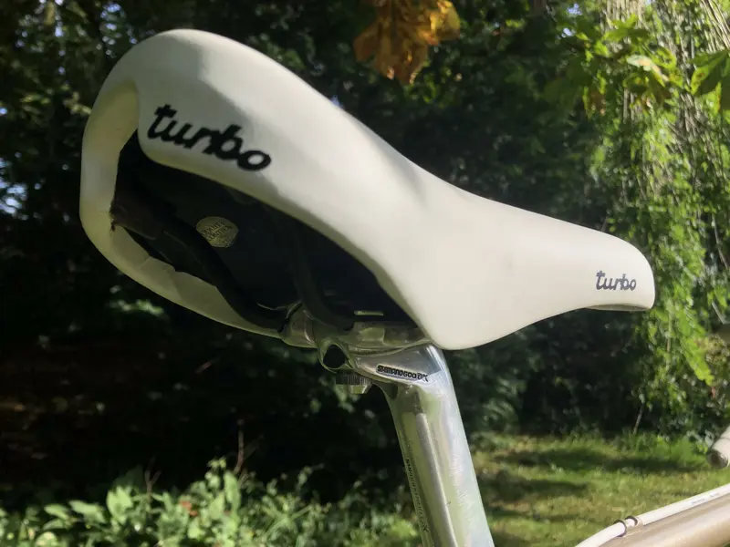

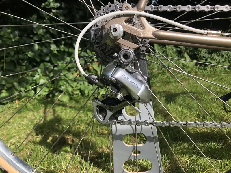

I've enjoyed riding this bike so much this summer, that I decided to go for a re-spray & upgrade....
Possibly more bronze than gold?
And the complete 105 group has been replaced by;
DuraAce 7800 shifting levers, brakes, crankset, bottom bracket, front & rear derailleur & 10sp cassette.
DuraAce 7700 36h hubs & QR skewers.
DuraAce 7400 stem & headset
600EX pedals
600AX aero post
