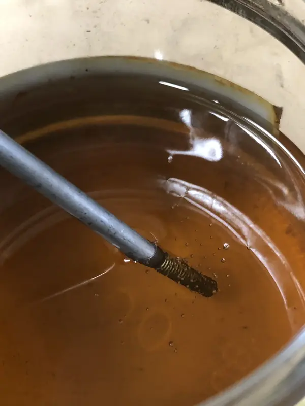

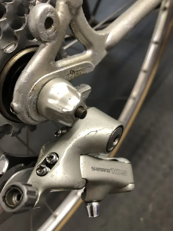

Ah, but first, I just wanted to sort out something that was annoying me… namely the length of the rear QR skewer.. I guess it was made for 130 or 135mm spacing and this frame I think is 126mm. The obvious thing to do is just cut some off, but then that leaves a raw edge prone to rusting, well that is unless you oil blacken the end…
This can be done quite simply and with little fuss, but a few precautions are probably wise, first I use a glass container to put my engine oil in and I make sure I’ve got a fire blanket at hand (much better to smother an oil fire than blast with an extinguisher)
Get the tip as hot as you can, preferably cherry red, then simply quench in the oil, I fumbled a bit with my phone taking the picture, but you get the idea…

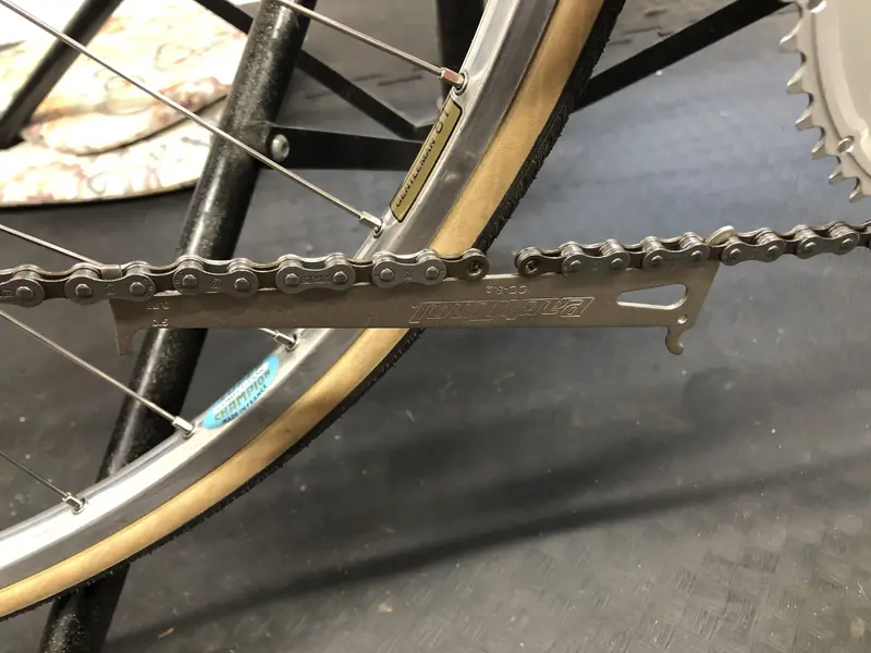

Next “tip” (although I think I might be just late to the party on this one) :roll: That is using a chain gauge to help get a chain the correct length and hold it in position whilst closing the chain… I’ve only just come across this and it worked superbly, I can’t believe I haven’t done it before! :facepalm:

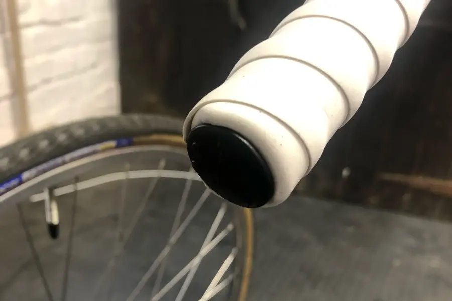

bar plugs are missing
*oh and how does the chain measuring tool go around the jockey wheels?

Bar end plugs aren’t missing... just the wrap was a little tardy...better now :?
Not gonna answer the silly question :roll:
