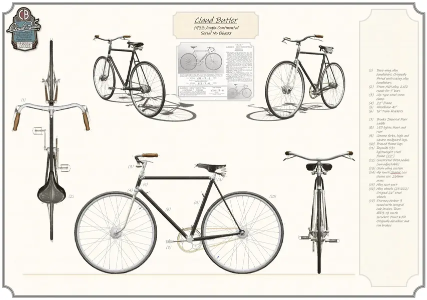

Julian
Well, its got a 2" offset on the forks.
As for the plan...
My plan was to "cheer it up a bit" for its next 10 years.
The bike is a daily driver, I use it to get around my little town.
It has sentimental value to me.
My cheer-up plan was to give it a coat of paint -black), a smaller Brooks saddle and new butterfly nuts for the wheels.
I was also going to make some new LED lights.
Perhaps make some new but old looking brake levers and gear shifter. The aim was to get rid of the ridiculous cables.
Of course I had assumed I could get another chain oiler nozzle- looks like that will be impossible.
Perhaps I can make something similar to the original.
Why my interest at the moment?
I am in the process of making a keep-sake poster for the bike.
I drew it, and then started to annotate it and realized I didn't even know what the bike was.
This led me to researching and then getting stuck.
I'll try to post a picture of my poster so far... please don't be too critical!

Fantastic! Do you do commissions?
