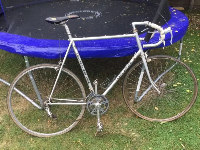

I’ve been building something a little more racy for the lad recently (’89 Condore Astore) and it’s got me thinking I might need something with a little more get up and go than my serene Majestic tourer to keep up with him.. :|
Had a little look through “the queue” and my eyes settled on a 1981 Claud Butler Colstar… Last “racer” that came out of the Holdsworthy Claud stable… after that they were all touring bikes.
Spec was reasonable for it’s day with butted 531 throughout, basically the same frame as a Holdsworth Special with a smattering of Campagnolo.
Top of the 1981 range retailing at £395 so double the price of a Majestic! Can you imagine the look on my spoilt cousins face when he received his Majestic on his birthday (something I was extremely jealous of) and not a Colstar? Apparently, the shop advised my Aunt that my cousin wouldn’t see any difference!
Anyway, this one I picked up cheep a while back with a mix of original kit and some not so original. I’m thinking a Campag upgrade and maybe a rattle can re-spray as I’ve always wanted a Gold Claud…but then I don't own a finished silver one.....2108_001 - Copy (2).jpgp42_43.jpgs-l1600.jpg

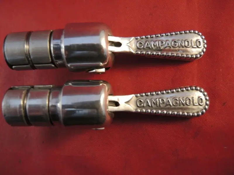

Had a look over it this morning and I think I will leave it in its original state and just try to clean up the rough spots.... so that Gold Claud will have to wait... :|
I'm going to add Campagnolo bar end friction shifters though and route them with the help of a Campag clamp-on down tube double stop. (going to need some detailing though) :roll:

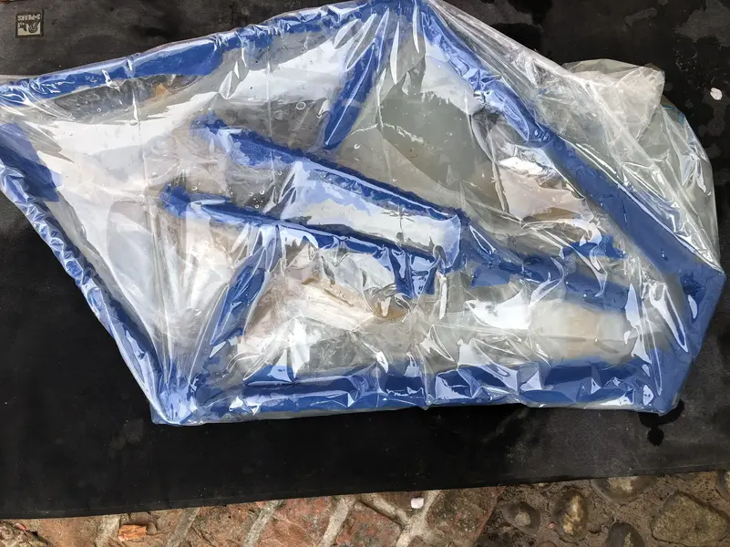

Right, back to the Colstar…
Now, I do like to muck about with different ideas for cleaning and restoring, and although I’m not known for being too precious with regard to original paint and transfers etc (and I hate “patina”)
I do have a rather nice 1965 Claud Butler Torino that I’m thinking of keeping as original as possible (well at least the frame)

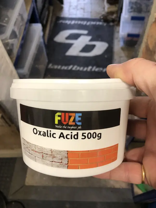

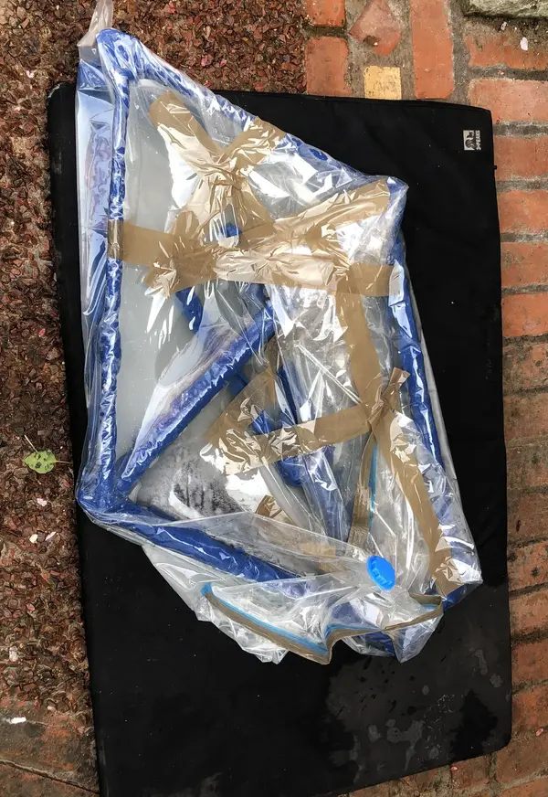

I’ve been on the look out for a less aggressive way of having a go at surface rust whilst not damaging lacquered decals. So, although the Colstar is going to have a re-spray if I find I like and can physically cope with the more aggressive frame geometry, I thought this might be a good Guiney pig.
I’d read that Oxalic acid might be the way to go so I started thinking about a suitable container to receive a frame and ways of reducing the area so as to reduce how much acid I needed.
Then I had an idea! How about a vac bag? You know, one of those things you can store duvets in…
I made up 10 Litres of acid from a 500g tub off of e-bay and then mummified the frame and forks in B&Q blue roll (dipped in the acid first) to make sure of a good contact with the frame and also to prevent the bag bursting.
Left it on an old dog mat overnight.
Then flipped it in the morning.
Quick blast with the jet washer and a rub down and first impressions are ok, its not as aggressive naturally as Evaporust etc, but it did soften/visibly work on the surface rust without touching the old paint or decals.
I spent the rest of that afternoon touching up the scratches and converted rust patches with some silver enamel paint and fitted the Campagnolo headset today.
Conclusion? Not sure…ok if you only want to do one frame, but the bag obviously doesn’t survive and the acid is wasted, so maybe something like an old fibreglass fishpond might work as a bath?
Oh and it stinks like old lobsterpots that have spent their life in the dampest, darkest corner of the harbour (Our Jimmy’s description… he goes potting with his Grandpa in Bridlington Bay)

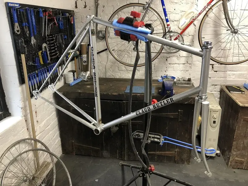

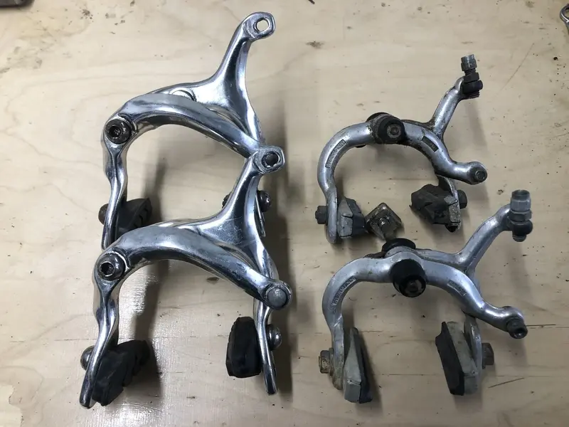

Right.... better start chucking some kit on it!
After the faff I’m having on my sons Concorde Astore, I’m definitely going down the indexed Shimano route, I’ve pretty much got a full set made up from predominantly early 105 (7 speed) with down tube shifters, crankset mechs and pedals.
Gutted I won’t be able to use either the 105 or 600 brakes I have as the fork measurement between the axle centreline and brake drilling is approximately 370mm, (as apposed to either 380 on my touring Clauds and 360 on my sprints/paths) a sort of halfway house between being just enough space for 27” without mud guards or 700’s with guards....something mentioned in the catalogue that I hadn’t noticed.
Anyway, the Shimano brakes just can’t quite reach, so I’ll use the Weinmann 500’s that it came with.

Re: 1981 Claud Butler Colstar #035210
So no braking at all then? :mrgreen:
Tektro do some very shiny longer drop dual pivots that shouldnt look too out of place
https://www.ebay.co.uk/itm/Tektro-R359- ... XQCgpRqdFv
Nutted version
https://www.ebay.co.uk/itm/Tektro-R559- ... Swj0NUmYwM
Yeah I’ve got some similar long drop dual pivots although I’m not sure if they are Tektro.
I do like the look of the 500’s though... nice bit of 80’s plastic on these last versions of such a long running model. (These are stamped August’85)
I’ll clean them both and make up my mind at the end.
But no more buying on this job, not until I decide if I want to keep it.
