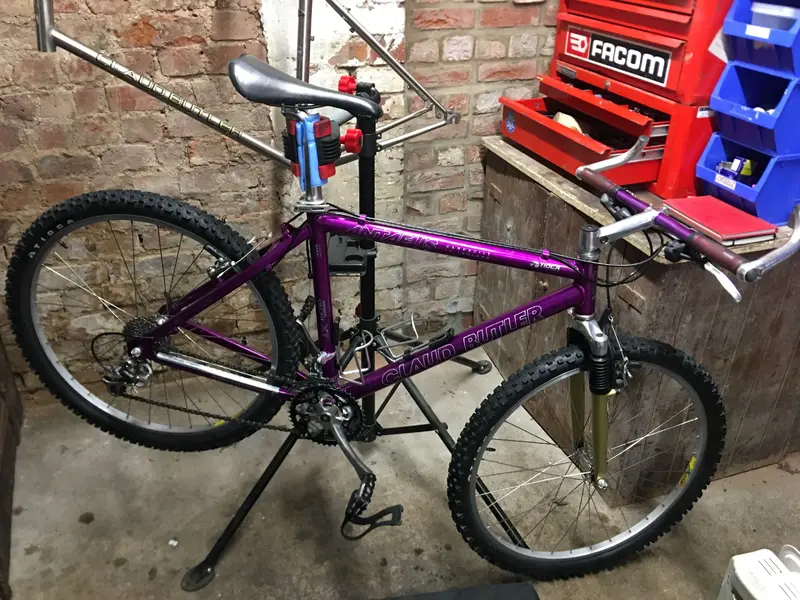

Here you go fine sir... lovely mover, only one previous owner... spent most of its life garaged.. :wink:
All finished, just needs a quick blast around the grounds of Peachy Towers to check cables and chain alignment, then off for a proper ride with the lad...
Re: 1994 Claud Butler Antaeus 7005
Specification for the 1994 Claud Butler Antaeus 7005
Frame: 1994, 18” Claud Butler Antaeus, oversized Aluminium 7005,
Fork: RockShox Quadra 10
Headset: Tioga Alchemy ahead system Licensed from DiaCompe
Stem: Tioga Alchemy Ahead
Handlebar: Kinesis Superlight 5051 Alloy
Grips: Tioga Pro-X transparent
Bar ends: Claud Butler Alloy Unified clamp design
Brakes: Shimano Deore XT BR-M737 (Oct’93)
Brake Pads: Shimano Deore XT
Brake Cables: Shimano M system
Brifters: Shimano Deore XT ST-M737 SLR plus (Oct’93)
Front Derailleur: Shimano Deore XT FD-M737 (Jan’94)
Rear Derailleur: Shimano Deore XT RD-M737 (Feb’94)
Derailleur Cables: Shimano SIS sealed SP
Cassette: Shimano Deore XT CS-M737 (Nov’93)
Chain: Shimano CN-HG90 8s
Cranks: Shimano Deore XT FC-M737 (Oct’93)
Chainrings: Shimano Hyperdrive 42t, SG 32t, SG22t (Sept’93)
Bottom Bracket: Shimano DX BB-UN51
Pedals: VP-Components VP-102A (’93)
Clips: Tioga Power clip
Hub Skewers: Shimano Deore XT QR
Rims: MAVIC M234
Hubs: Shimano Deore XT Parallax HB-M737 (Jan’94) & FH-M737 (Sept’93)
Nipples: Brass/chrome plated
Spokes: Stainless Steel
Tyres: Tioga Factory 26” x 1.95”
Saddle: Selle Italia Flite Titanium (July’93)
Seatpost: Kalloy 31.4mm Dec’93
Seatpost Binder: Tranz-x 35mm
Bottle cages: Elite
Weight: 25lb 1oz / 11.37kg
