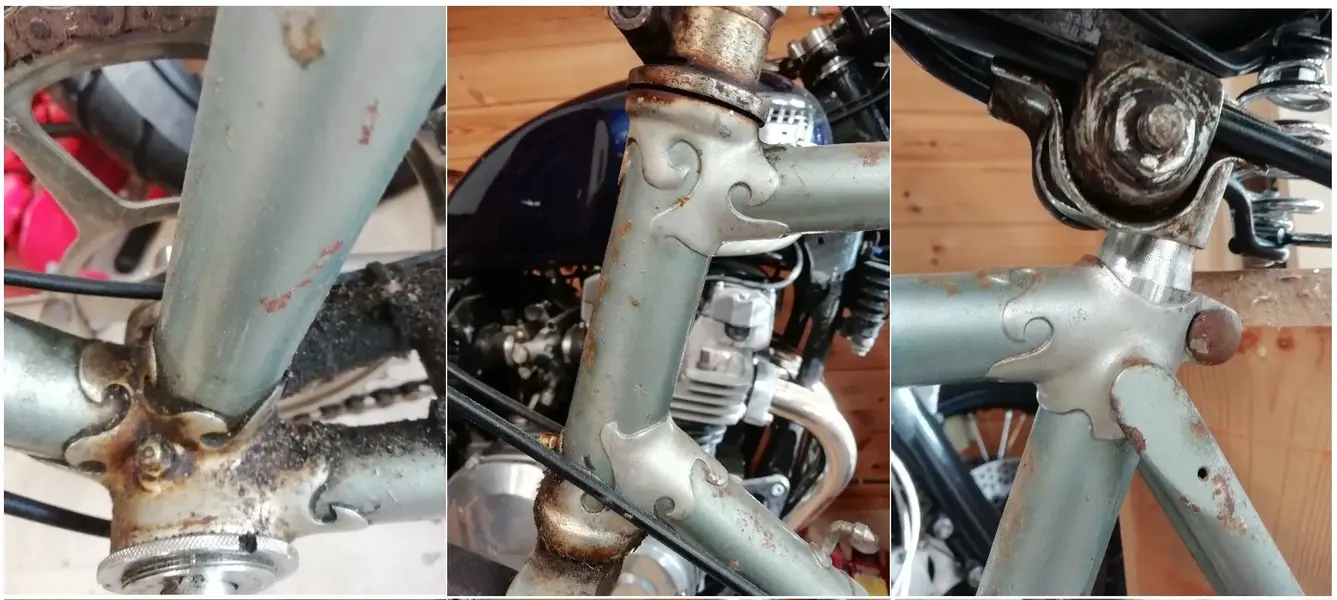

Anyway, I think it might be a “Continental” model, not sure which one.
Things I do know:

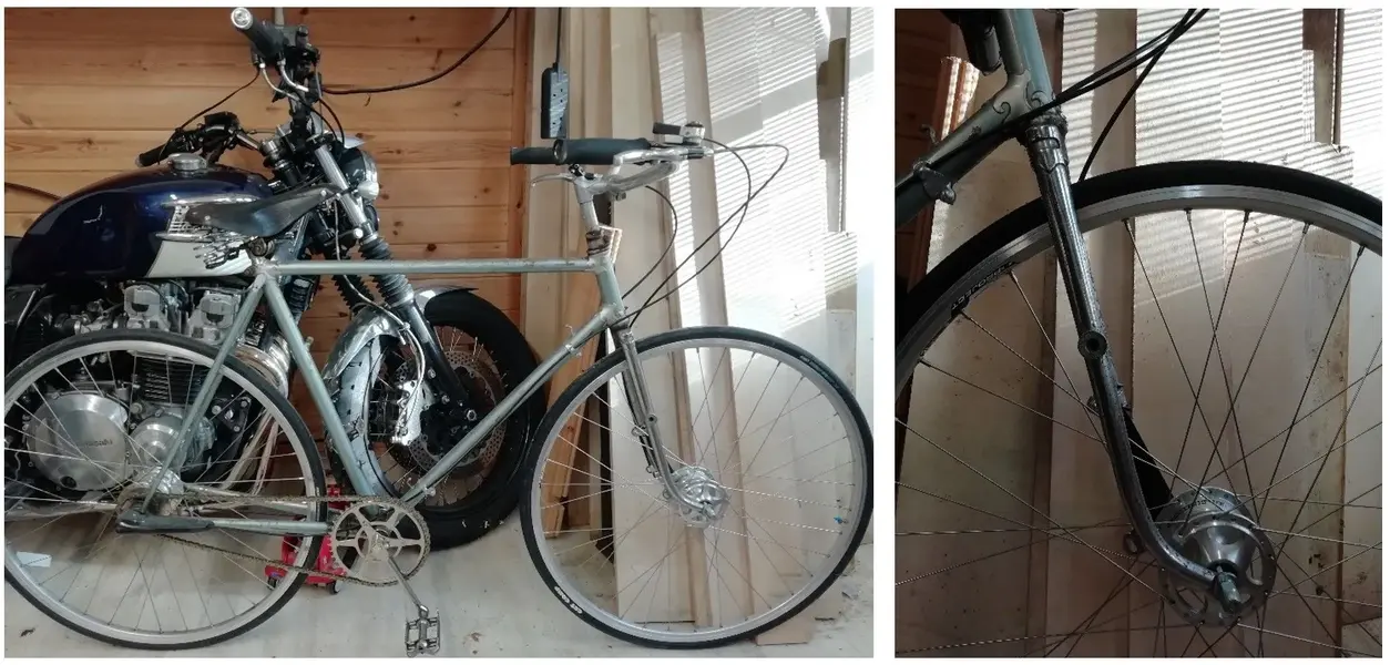

It is a 22” frame with 41” wheelbase and 26” wheels. Inflator mounts are 16” between cones.

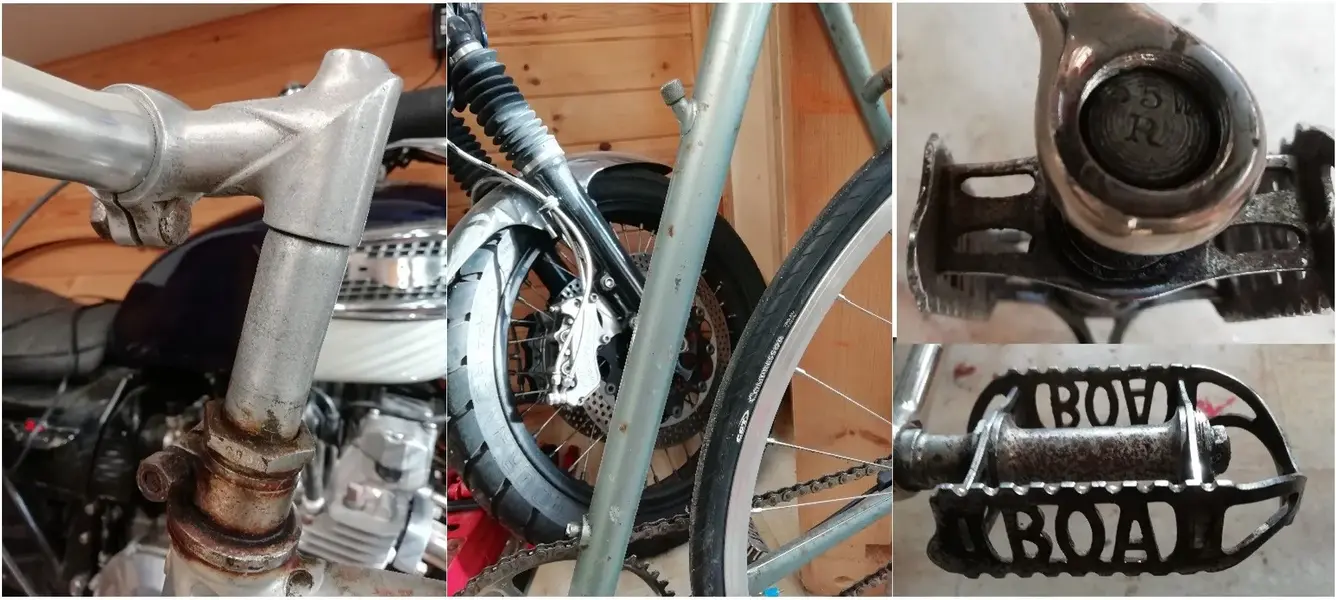

Handle bar stem has AVA stamped on it with a 2.1/2” extension. The stem top clamp seems to be the older style.
The frame lugs seem to be “CB Continental” style.
The rear fork is of the “CB Forward serrated” style.
The mudguard mounts can be seen in the picture are some way up the forks and have slots.
The frame has an in-build chain oiler (nozzle tap missing).
Missing paint all over the frame reveals it seems to have been originally entirely chrome plated.
The chrome forks are round section and have a sharp curve at the bottom.
The have mudguard mounts shown in the picture and a mount for a front light.
Seat post is new, previous alloy one fractured. The diameter is 26.8?
Pedals are BOA and have 55w stamped on the inner ends.
Finally, the frame number is 862567.
June 1948?

My money is on 1938 as these Continental lugs were cast in 1938 and in 1948 would have been bi-laminates... these look like cast to me.

BOA pedals were an option.
