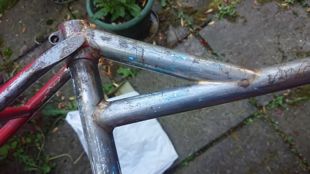

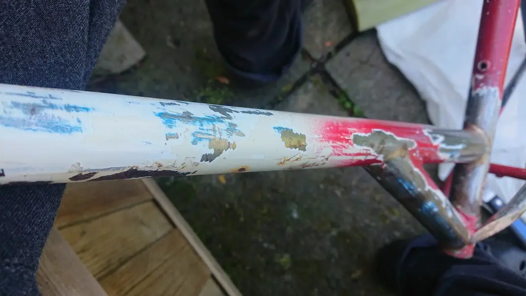

The paint was is in poor condition and the red at least was flaky in places, so I decided to start removing it to see if I could uncover anything else of interest.
There's hints of blue under the top black/red/cream fade. I don't know whether that is from previous paint or just some basecoat:

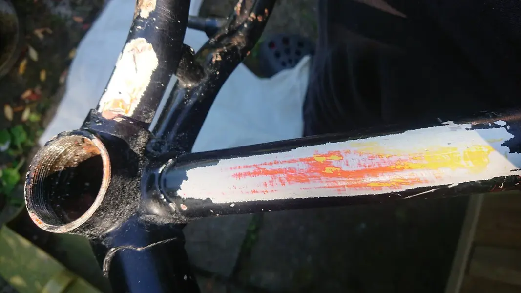

Inside the bottom bracket shell, there is some fluoro orange overspray:

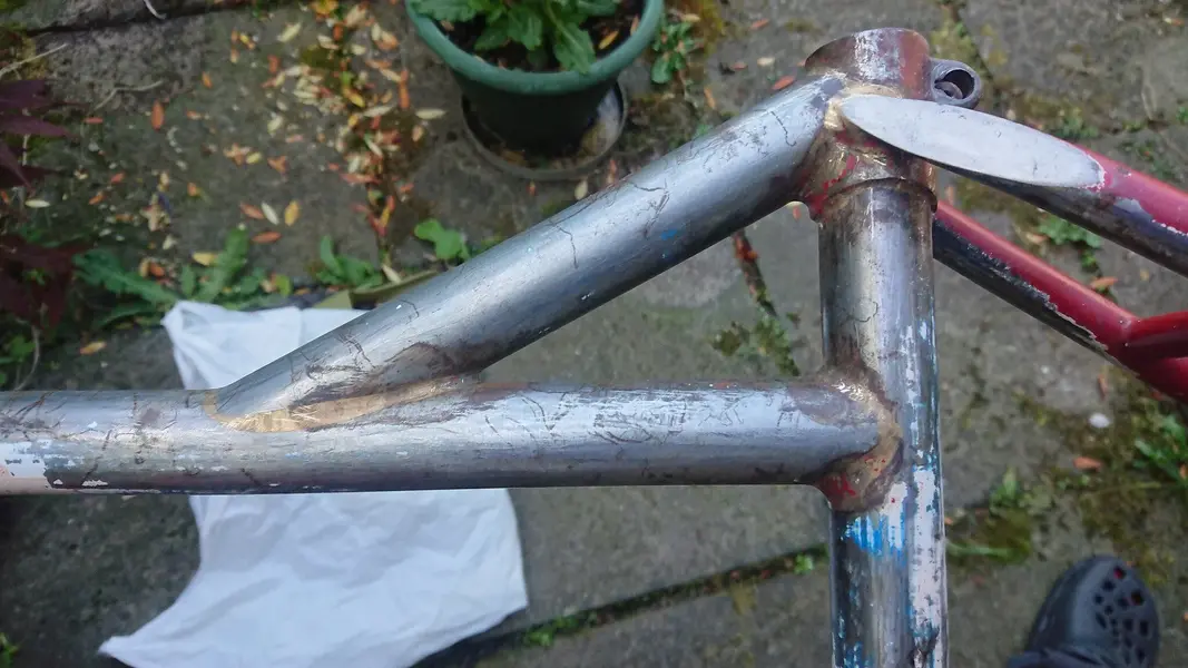

The seat tube reveals this could have been faded into a yellow:
Given the location of the paint in the BB shell, I would be tempted to say it was the original colour. However, the frame number shows it was built in 1988 and I haven't seen any evidence of Raleigh using fluoro colours before the Lighweights in 1990.
Hopefully, someone else can provide some more insight.
Still pondering over questions raised by this. I don't think I'll ever have an answer for the biggest question, which is: Why did someone go to so much effort/pay someone to go to so much effort to make this Raleigh frame into a smaller frame, rather than have a custom frame built?
The colour is puzzling me though. The frame was built in December 1988, so I assume it was a 1989 model. However, I can't find any examples of Raleigh using fluoro colours before 1990 ... and even if they did use them a bit early, you would expect that to be towards the end of 1989, rather than a bike built at the end of 1988. The orange inside the bottom bracket is very bright and matches the fluoro they used on the White Lighning in 1990. It's possible it was professionally painted after the modifications were made, but the orange looks very much like original paint, with no evidence of any previous paint.

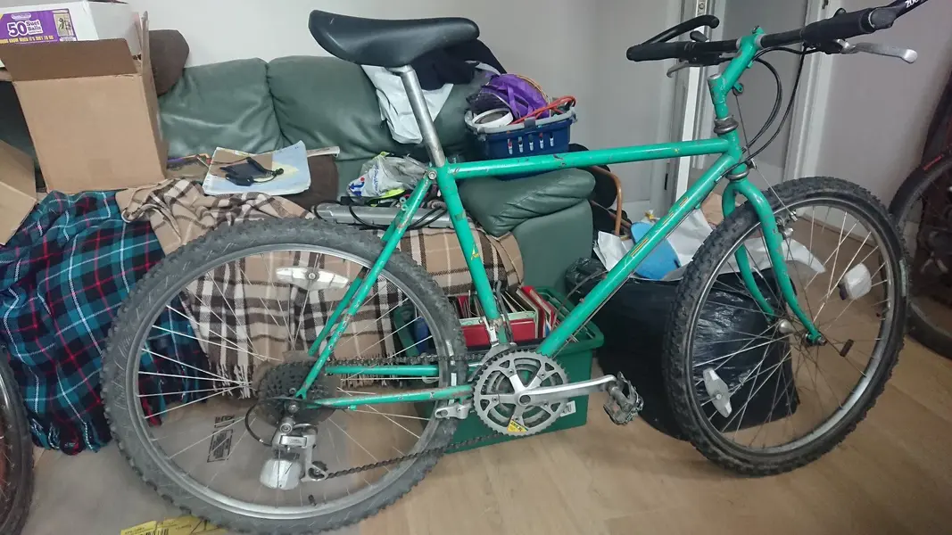

I did buy this Fisher with a view to using it as a donor.
However, having test ridden it I don't think the stem/bars are going to give me enough reach forward, so I'd probably only end up using the derailleurs and brakes, which doesn't seem worth spliiting it.
I may move that on complete instead, but I could possibly throw everything across to the raleigh just to test it and get a feel for how feasily it's going to be - assuming I can find a very long seatpost in the correct diameter.
