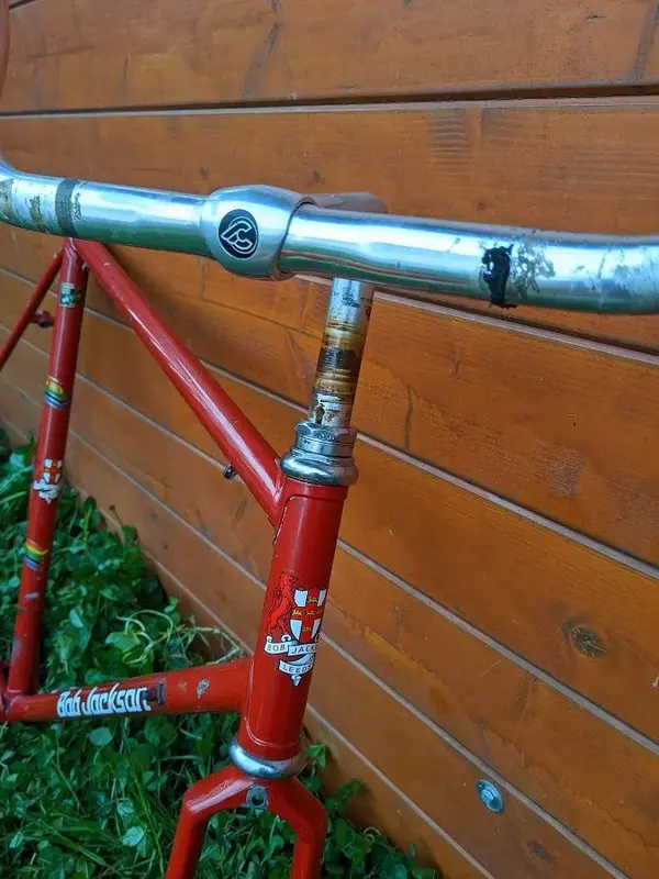

Bought the bike, brought it home, had a good look over it - to my horror found a seatpost crack just under the lug! Seems to have been caused by a too short a seatpost.
I believe in fixing things rather than throwing them away, so can you knowledgeable sirs kindly advise me whether this can be repaired?
I don't expect to be hammering downhill at 45mph on this bike and the damage so far does not seem too critical. I suspect that with a wee patch and a long enough seatpost, this can last for years of commuting. Steel's supposed to be real, right?

That's a bit of a heartbreaker. I'm no expert on this, but as its a Bob Jackson and lugged frames are relatively easy to replace entire tubes is that an option? Obviously it would need paint repair if you went that way. I suspect you can get a welder to patch / repair it and it would be fine, but I'll leave it to others with more experience to chime in on that.

I'm going to ask locally if I can get someone to weld/braze a patch on it. Failing that I'll do a carbon wrap myself (got the supplies handy, always wanted to do it!). Assuming the frame is sound, she's in desperate need of a respray.

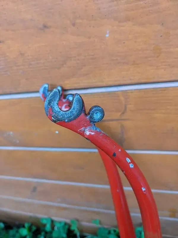

Rear dropout's 120mm so I'll probably need to widen it before I do any more work. And there's some truing up to do on the dropouts, but I'm feeling confident after the Romani experience. Might need some more brazing if that doesn't go well 🤣

If you're getting someone locally, at least make sure that they know what '531db' is and that they have experience of working with it- and remember, this could easily be 531db that's half a century old, which is also something to consider before you start tugging at the chainstays. I totally disapprove of this fad of trying to fit 130mm into a 120mm space, especially a 120mm space that's been there minding its own business for fifty years..

The 120 has been there holding a 126 hub for years by the looks of it. I'll be happy with a 6x1 drivetrain for the commute, so not going for 130 unless it just happens to spread really easily. I wouldn't say no to a cartridge bearing hub on the commuter though.
The rear needs to be trued up a little, and by the time I'm done, it should be around 124, which is where I might leave it.
For the Romani, truing up took it to about 128, so she's asking for a 130 hub and a 9x1 that I'm running on my current road bike.

It's a shimmy exage, and it's a 126mm... With a 6mm spacer on the axle. So if I take the spacer out, it goes back to the more natural 120.
Not sure if the 6 speed freewheel is going to still fit in the frame though. Wasn't 120 for 5 speeds max?

Yes, you won't get more than a 5-speed block (or a Suntour Ultra 6-speed) into 120mm.

The frame number is 576*(8?), which should put this into late 1960s.
After a soak in plusgas and a long fight, the stem came out just about as I was eyeing up the grinder to cut it off.
Plusgas + bench vice got the ds bb cup out. Next on the menu - drilling out broken bolts from the guards eyelets. Maybe I won't break another drill bit tomorrow.
Strap-on it is then, even though I'd much prefer to put the real thing in there. The reason I've asked about the extra bosses - the ones on the downtube are clearly alloy rivnuts and must have been retrofitted by a previous owner. It also appears that the bike might have started its life as yellow, but was professionally re-painted into brick red.

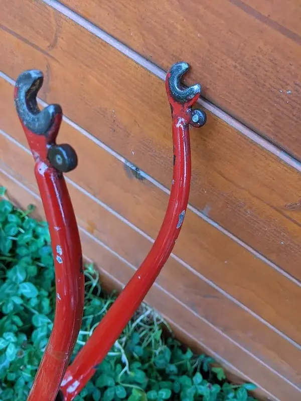

The fork is a boat anchor at 850g. The Romani is just over 700g. The Reynolds 531 frame, however is about 150g lighter than a slightly smaller Columbus TSX.

Yes those fully sloping fork crowns are heavy.
