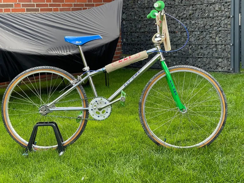

Do any of you remember the Elf BMX bikes from the late 80's? The Mini's and the 24's had sweet wheel proportions. I had an early 80's Hutch, but as a kid drooled over the guys at the BMX tracks with the 24" Elf's. Example:

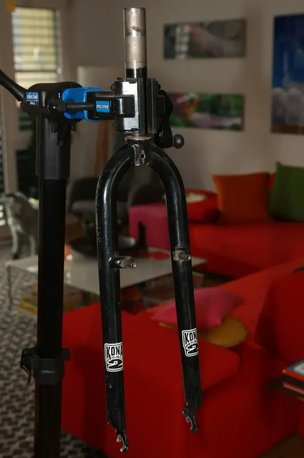

I bought this A'ha frame and cranks only. I have on hand a P2 fork, but it's currently painted black. I don't know which version of P2 this is other than it's rather heavy and a steerer tube that is 263 mm, non-threaded 1-1/8". In the aforementioned Cruiser thread, MattiThundrrr posted some sweet photos of cruisers with front suspension. I really like the look of the Noleen/Girwin fork on a beach cruiser frame as well.

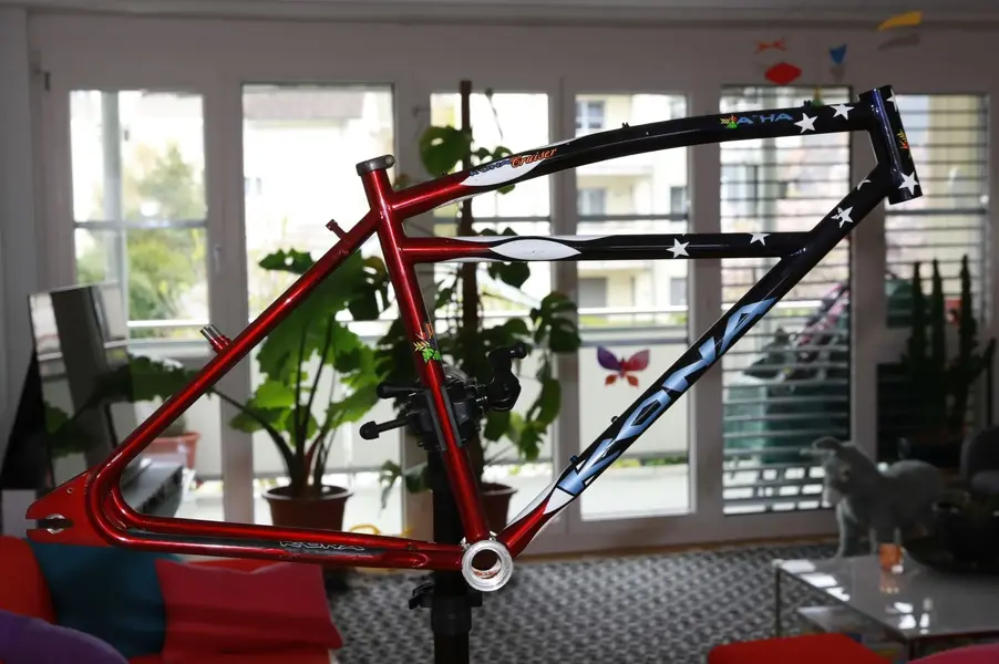

:Frame:

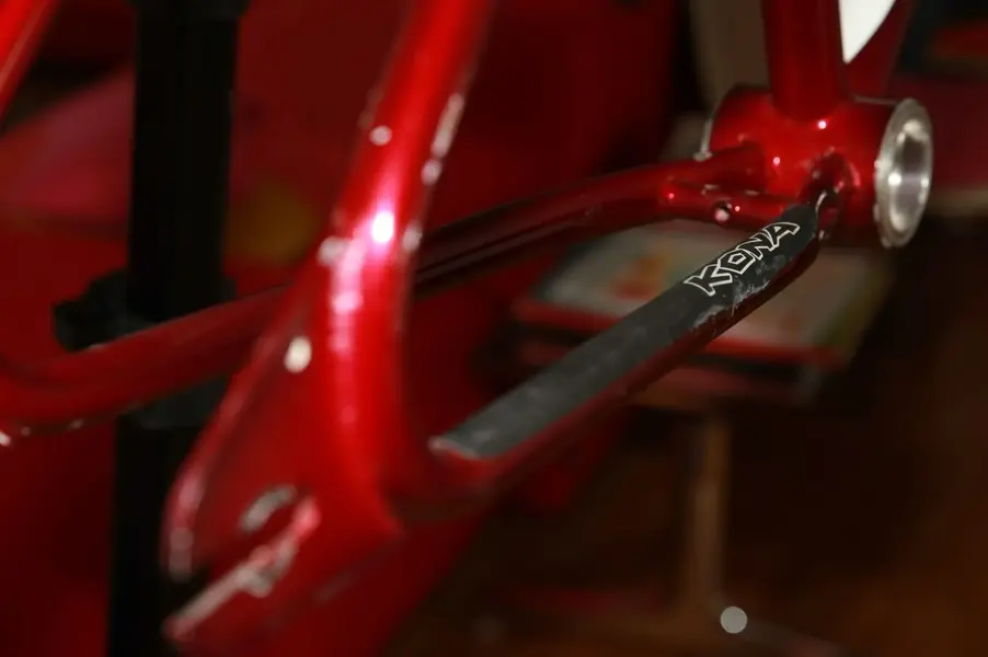

This is how she sits currently. There is talk in prior A'ha threads about rear fork spacing being 110, 112 and 120 mm on these frames. My particular frame measures (I think) a 20" (maybe an 18"). I can't really tell. 1997 catalogue hints more like a 20" but I don't know. Rear forks measure 112 mm (but are technically 110). I think those who have 120 mm have spread rear forks after the fact.

1997 Kona A'ha in Stars & Bars livery
SN: 7040199

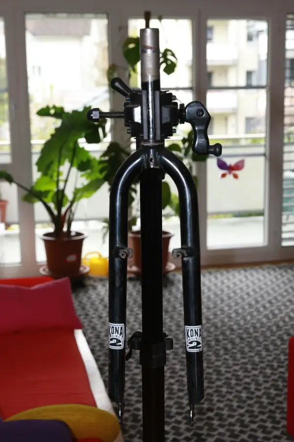

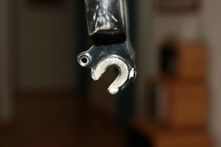

Fork: says something like 1998 CM/OM and a stamped picture of a whale or fish above the date
Edit: MattiThundrrr cleared up the forks. They are CM/CM. Mahalo!
If you look just above the crown race the forks might have either… CM/CM (plain gauge) or CM/TB (triple butted) stamped on the steerer tube

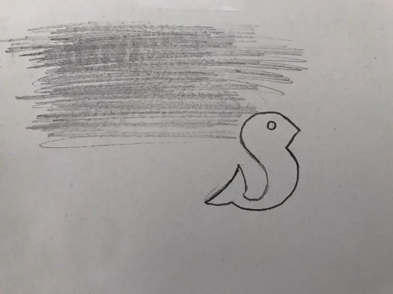

Ah...ok. I thought there was CM/OM, but you just cleared that up. Is there anything special regarding the little whale stamped into the steerer tube?
It is very faint in the black paint I barely caught it. Tried to massage it out with paper over it then rubbing some pencil. Measures about 1cm high by 1.5 cm wide. Looks like a roll mark. Also, maybe not a whale but a dolphin. Looks like this:
I suppose it doesn’t matter too much if that is relevant or not. Thanks anyhow!
Could the ‘whale’ maybe be the Columbus bird?
