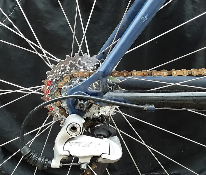

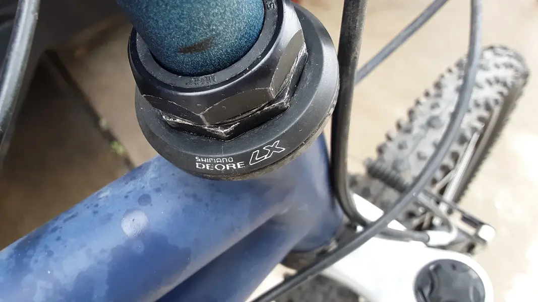

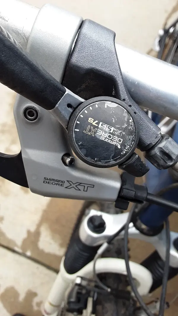

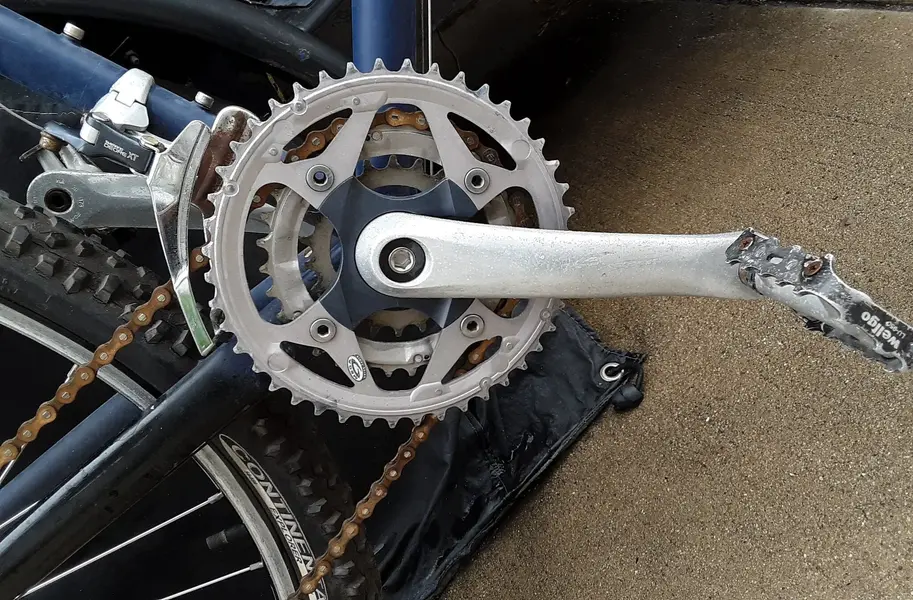

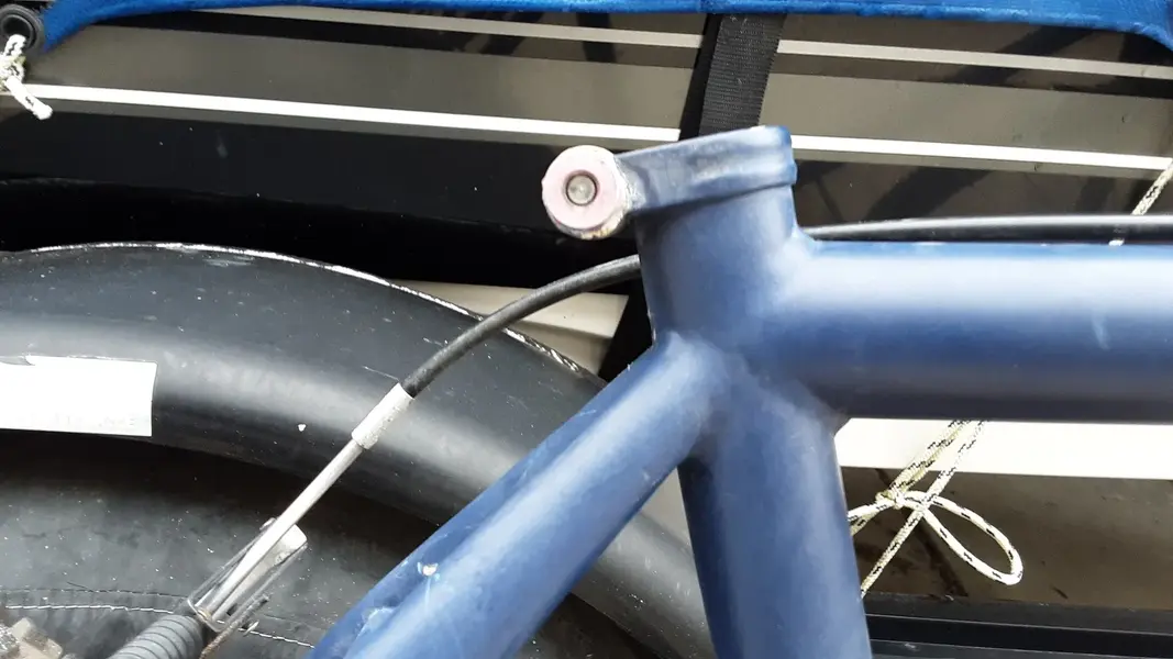

I have an even more mysterious Stumpjumper steel frame model, no eyelets and with a 1" steerer, take a look, perhaps you can tell me what it is. Yes, someone erroneously painted this over and perhaps upgraded the components.

Is there any chance of a serial number? Or has it been obscured by paint or perhaps removed?
Tomorrow, I will remove the bottom plastic cable guide as the number runs underneath the length of the BB. I did scrape paint and "89" are the first two digits, but it is barely legible. So perhaps it's a 1989? I've researched other BBs online and I see most serials run on the edge of the BB. So strange.
I would look at the drop outs and how they meet the chainstays. Usually the brand id is strong in those details.
I will take more pics of the dropouts without the wheel. Dropouts are centered at the end of the stays and like I mentioned before, no eyelets nor evidence that they were removed.
Obvious observations to me:
-sloping top tube
This makes the frame a 1990 or younger but also not an Epic.
-affixed seat post clamp with the center area indented around the circumference
This excludes M2 frames or composite frames where the seatpost clamp is milled; i.e. your bike is steel frame (do the magnet test to confirm). The actual bolt going through the seat post clamp is also not original.
-lack of eyelettes
The only non-eyelette chromoly frame they made in the early 90's were the 1992 and 1993 S-Works Stumpjumper steel frame.
-components
I suspect the thumbies are original. Check the date codes on the thumbies.
-rear dropouts
The triangle hole makes the frame chromoly. M2 frames have solid dropouts.
-rear cantilever cable stop arch
Your frame doesn't have one, unless that too was ground off with the (maybe) eyelettes. The arch went missing in 1993 and some people claim a missing arch on their 1992's. Catalog pictures have the arch, but tons of photos of 1993 Stumpjumpers do not. Rather, the frames got a metal noodle welded onto the non-drive side just below the seat post clamp. The only other frames that did not have the arch were also the 1992 and 1993 S-Works.
The serial number should have an S or K in the third digit to be an S-works.
Ultimately, I am stabbing in the dark. So take this summary worth a grain of salt.
