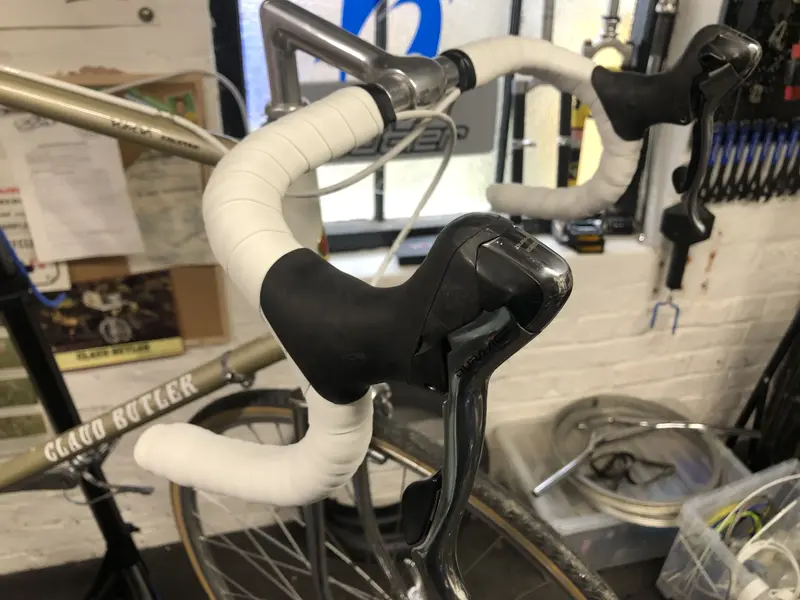

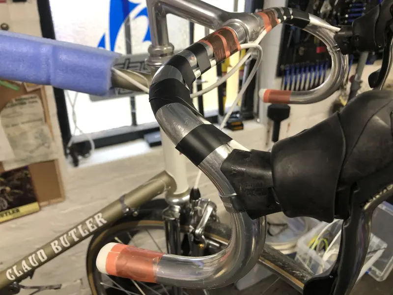

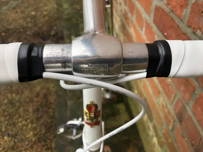

Shimano Aero end caps, strange little things. Obviously designed to have super thin 80’s/90’s Benotto tape so I was sure how this fat soft Shimano stuff would work out.
I added a layer of VHB double sided Stab tape to either end then got stretching. Reasonably happy.

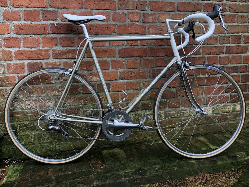

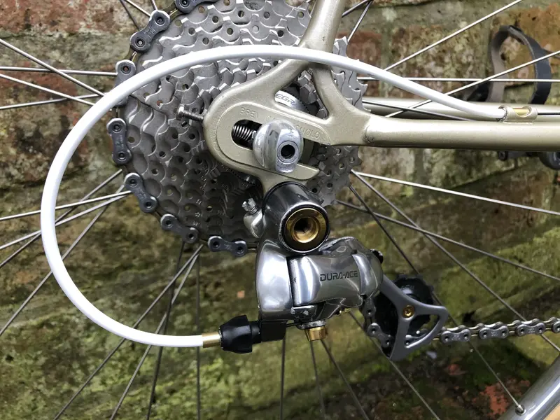

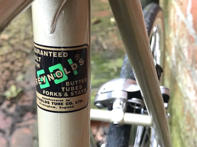

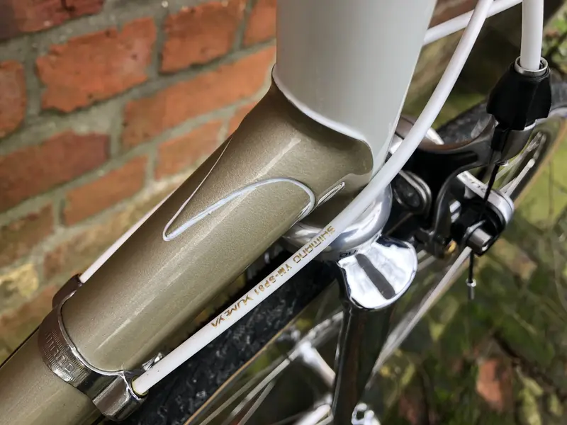

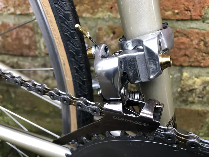

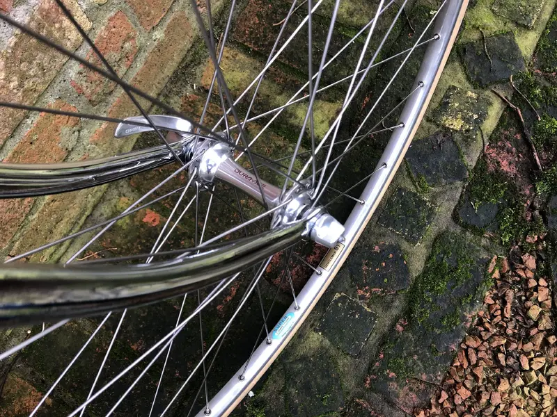

And it's done... for now ;) The Yumeya & Flite Titanium have got it down to the magic 10kg. Can't wait to get back out on it.
Here's the new spec sheet; and a few photos. Light wasn't great so I'll probably re take a main photo before it goes into a rBotM

Frame: 24” Reynolds 531 Butted throughout #035210
Fork: Reynolds 531 Butted

Derailleur Cables: Yumeya Aluminium Hybrid Shift Outer Housing YM-SP81(white)

:cool:

Fantastic! It is certainly one very special Claud Butler.
It has come together perfectly, I was a bit worried that even after all the really special Dura Ace and Shimano goodies it wouldn't look quite the sum of it's parts if that makes sense, but need not have worried because it looks amazing and exudes class.
Jamie

Thanks Jamie, I couldn’t be more pleased with it. Not so pleased with the main photo though, it looks much better to me in the flesh so to speak. I think I need a sunny day to get the best from it.

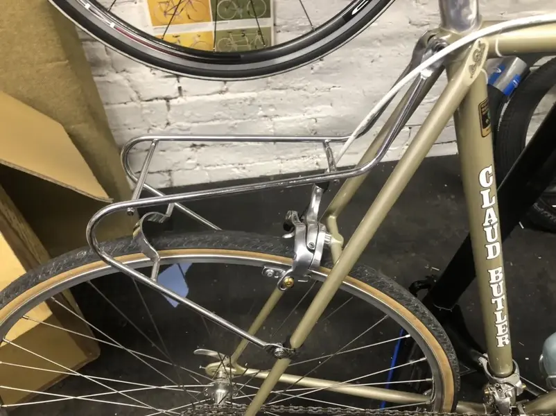

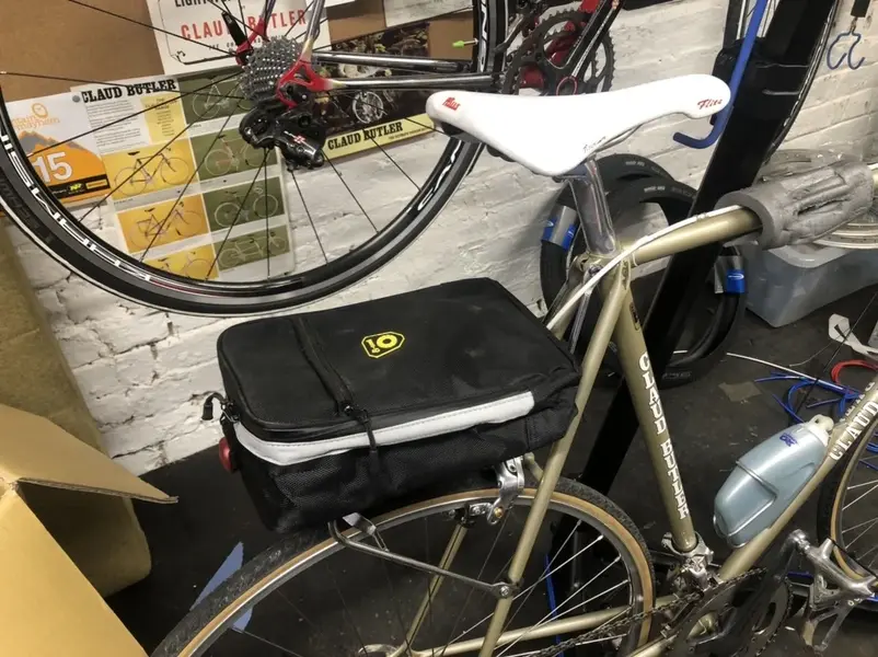

Found this half rack I guess originally from a kids bike? On that there eBay for a few quid. Fits perfectly at the clamp bolt and a couple of P clips have it secured to the stays, perfectly flat like it was made for it!
I’ve got a small under saddle bag that’s big enough to hold my keys, card wallet and inhaler, but this will allow me to carry something big enough for a spare inner tube, half pump & levers etc & a waterproof layer for those longer sojourns into the wilderness (the plains of Holderness) :DA1A9E06F-7064-4E0F-B09C-8322871CA9C3.jpeg12FFE318-DA06-4709-9A42-203F75D29AC4.jpeg623960A6-4354-41AF-8373-26CA49B8204C.jpegEAAE0D93-614F-4739-9D3B-33E3A90CCE56.jpeg

One, well, two last additions... a pair of Yumeya jockey wheels. Designed for the XTR mech but fit perfectly into the DuraAce and run silky smooth. 😎E797A9C8-75E1-4126-AC5B-70BA1ED116C2.jpeg76FC8268-3C00-41C1-84F4-DB83A3A151D2.jpeg
