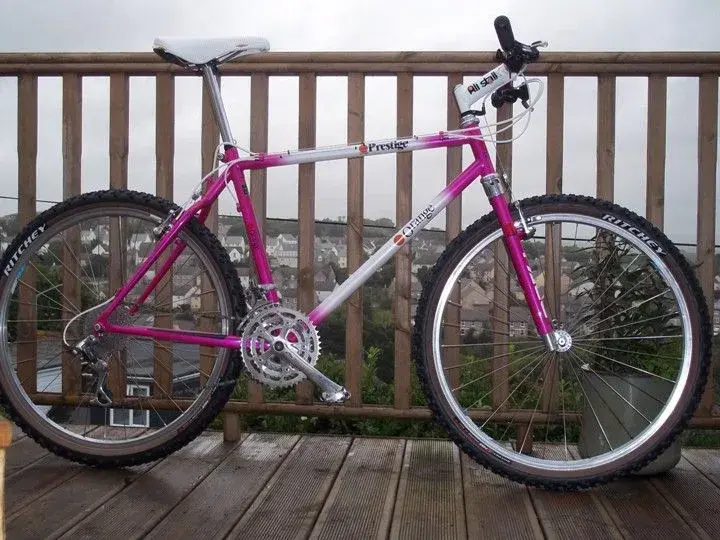

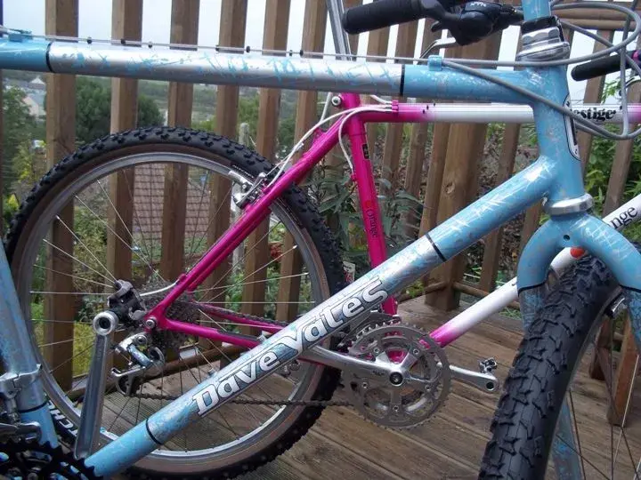

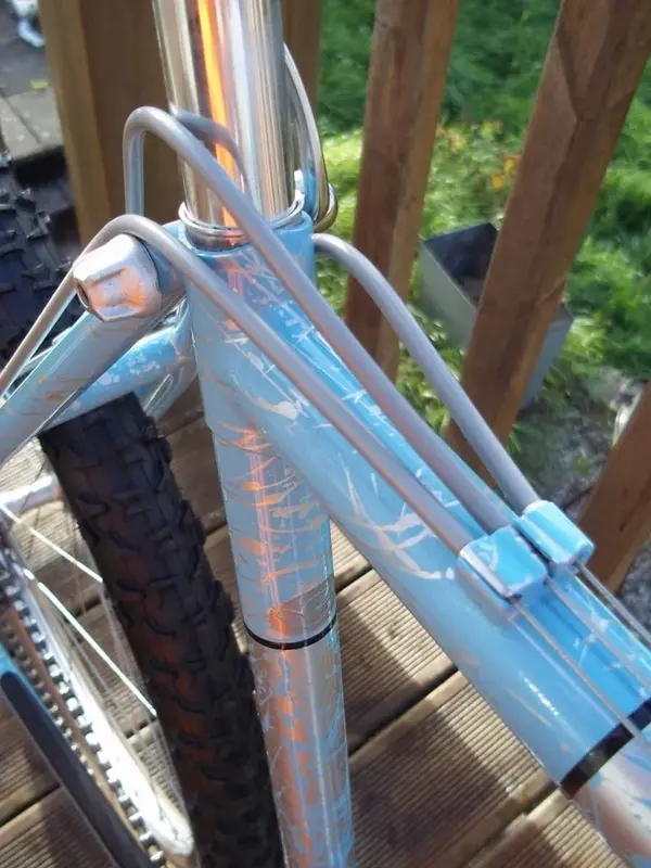

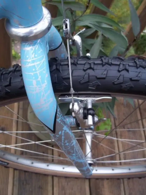

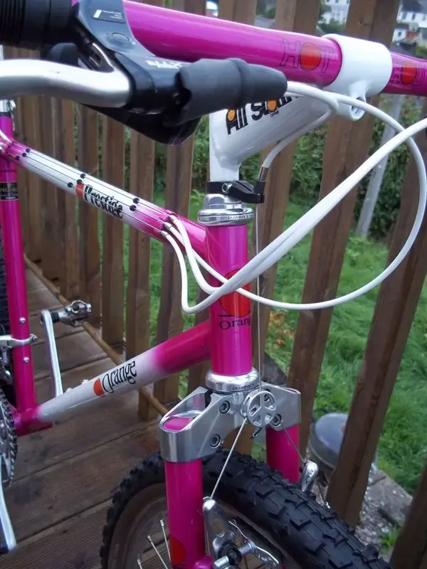

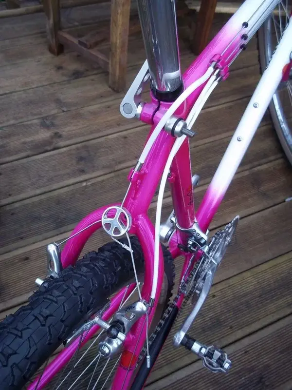

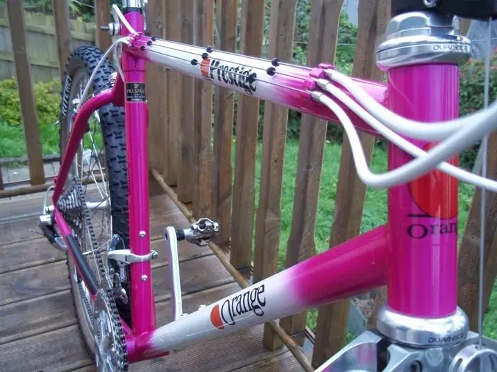

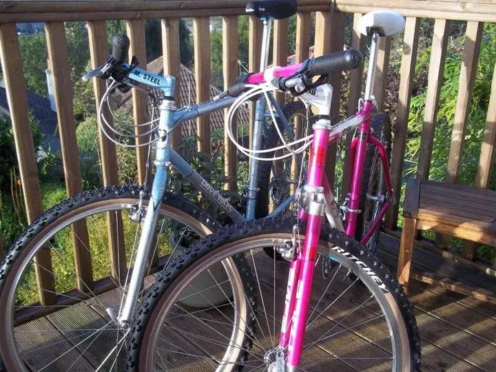

Well after six months this project is close to completion. Period correct..? I have lost track tbh, certainly the paint for the orange isn’t.
I had already powdercoated the orange frame “black” at least twice since i have owned it. This time i had thought about silver, but it didn’t do it for me, so i have done something i said i would never do.......i back dated the colours and went for an option from the previous model years, “pink and white”, but took it a step further and used a hot candy pink and an Oyster white pearl, then a lot of clear coat over the paint and decals.
The Orange frame was by far the worst condition of the two frames, it clearly has had a very hard life, but hopefully this time round, it will be treated with a little more care and a lot less abuse.

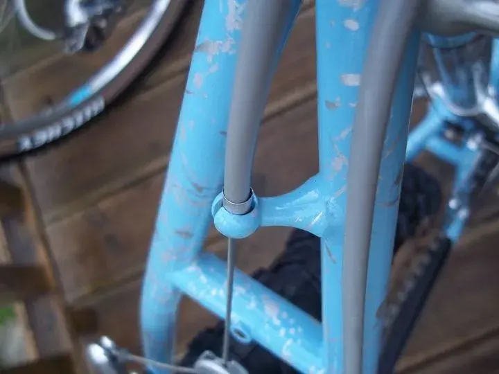

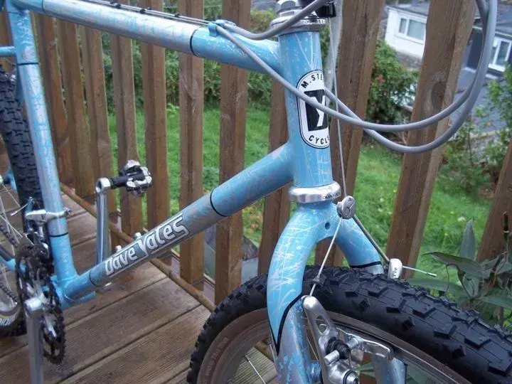

The Dave Yates.....when this arrived i was a little relieved it wasn’t as bad as i had expected, although the colours were bloody awful, actually it hurt my eyes to look at.
I clearly didn’t want to replicate the original paint, and to be honest i really hated the decals too..!!!

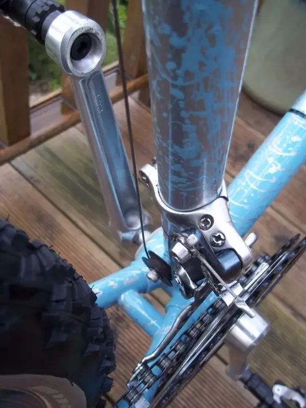

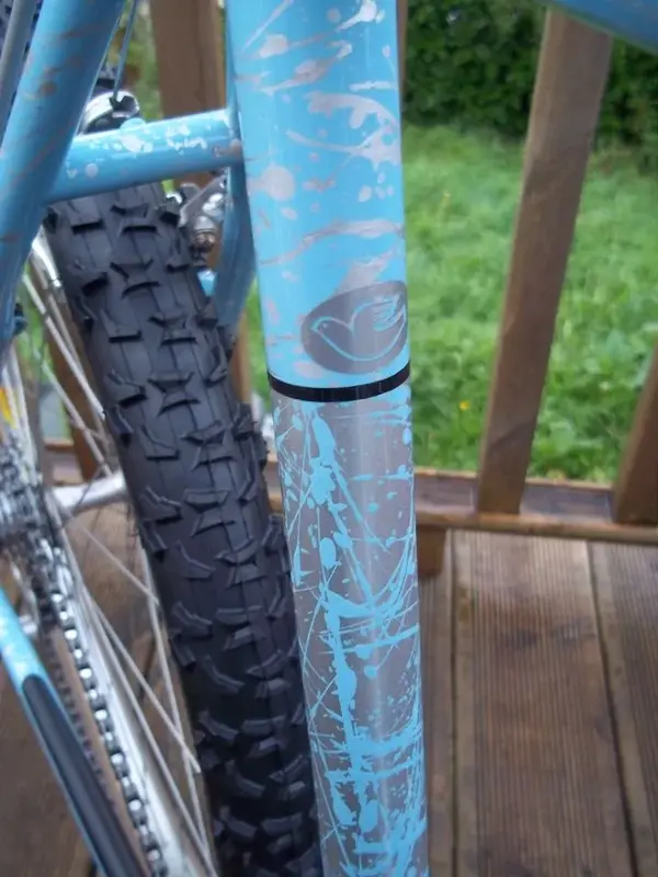

I didn’t want to stray too far from the original paint “splatter” look, or change the decals, but i did want to try and show the quality of the fillet brazing, and somehow make it more appealing to me.
I teamed up with Garry at graphic shack, and between us we came up with the new paint schemes, as you can see its probably pretty clear where my influences came from,....lol.
Personally i like the way the Yates has turned out, its now a bike that inspires me to want to ride it, unlike the original paint. But then, even if i had ordered this from Dave Yates as a new frame, i would have perhaps chosen a similar look even back then....who knows...!!!!

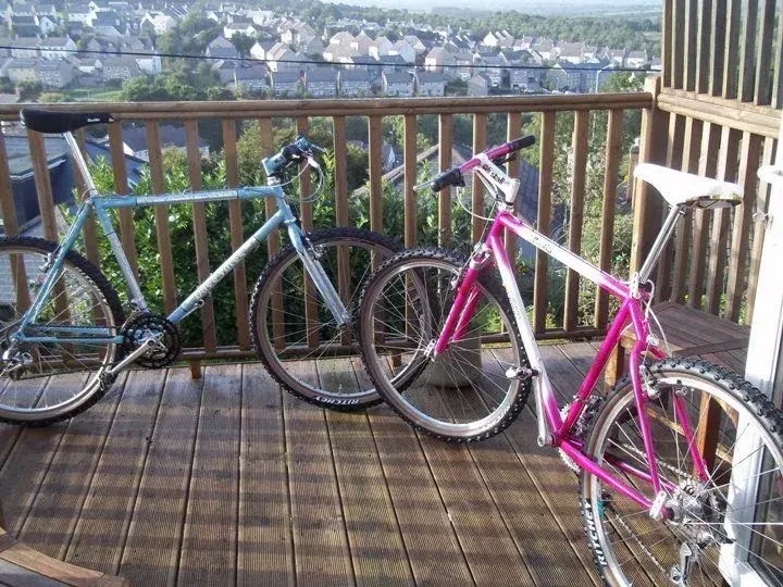

Both of these frames are of a similar year, both are made by British companies, one is made in the far east and one is handbuilt here in England, neither i would consider top of the range or particularly special from a collectors point of view, and both were hammered old nails at the start of the project, and neither are big money frames.
With a very low rigid budget, i was attempting to build two bikes with a similar spec, to be able to compare the frames, and their differences, to answer the question ..”Handbuilt or not” “far-east or England”...........??
But above all both bikes had to be able to be ridden and remain reliable. For a starting point i used the archives here on Retro-bike, and the Orange scan, to give me a base and specification list/options for the builds.
The simplest way forward for me was to try and build both bikes to an “ORIGINAL” retail price back in late 1992/93. The retail budget i chose was approx £1500, (remember this would have been 92/93).
I have tried to achieve this and keep both bikes as close to period correct as possible, obviously as both bikes are riders and not garage queens, Brake blocks/chains/bottom brackets are new and used in an attempt to keep the bikes reliable and low maintenance, and the tyres used are new but in-keeping of the era of the bikes.
There are certain items that i am unsure are period correct, for example “was the middleburn Rs1 chainset totally superseded by the Rs2 by late 1992/93...??? or was in in the glass cabinets of bike shops sat side by side..??? I was unsure but presumed it was available.
Also little things like brake cable hangers...., im blowed if i can remember what i was using for this back then.....!!!!
Anyway with a lot of perseverance, i have finished both bikes.

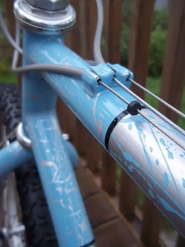

Cable hangers—to me, the cable hangers i have used are not appropriate and stick out like a sore thumb, ideally i would like to source two very nice aluminium jobs, that i think will “LOOK” more inkeeping with the builds.
Anyway, they are roughly in budget, and finished and ready to ride....., let me know your thoughts.!!!

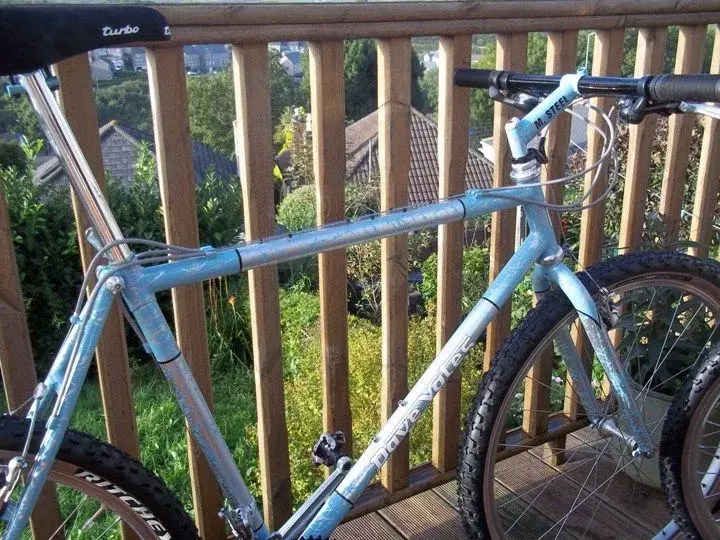

DAVE YATES “DIABLO”
FRAME... Columbus Cromor OR. “Fillet brazed” Handbuilt in England.
FORK...O/E spec Project II.
PAINTFINISH...”TRUTH” (Sky Blue and Lightning Silver) Custom Decals.
CHAINSET... Middleburn RS1 (Polished)
CHAINRINGS...Middleburn
REARMECH...Shimano XTR m900
FRONT MECH...Shimano XTR m900
BRAKE/GEAR LEVERS...Shimano XTR m900
CANTILEVERS...Shimano XTR m900
HUBS...Shimano XTR m900
SKEWERS...Shimano XTR m900
RIMS...Mavic M231
SPOKES...D.T double butted stainless
TYRES...Ritchey “Z-MAX” evolution.
SADDLE...Selle Italia “turbo” black suede.
SEATPOST...U.S.E, (ultimate sports engineering) polished and painted.
GRIPS...O.D.I attack (black)
CABLES...El cheapo. (silver)
HEADSET...Durace 1” threaded.
STEM...M.Steel (cro-mo)
HANDLEBAR...X-lite ( refinished in cosmos black)
BOTTOM BRACKET... Shimano
PEDALS...what ever i have spare at the time.
CHAIN...shimano

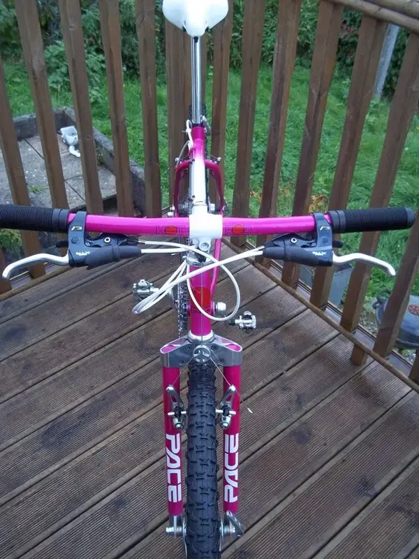

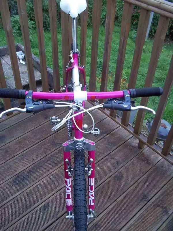

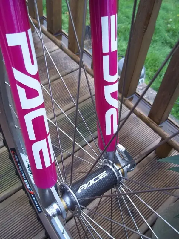

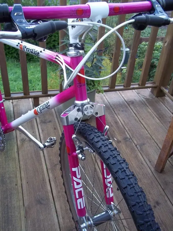

ORANGE “PRESTIGE”
FRAME...Tange Prestige, “TIG welded” Made in the far east.
FORK...Pace Rc30 second generation. Custom Painted.
PAINTFINISH...”DARE” (Hot Candy Pink and Oyster white) Custom Decals.
CHAINSET...Shimano XTR m900
CHAINRINGS...Shimano XTR m900
HUBS...Shimano XTR m900 rear and Pace CARBON xc front hub, radial built.
RIMS...Campagnolo Atek
SADDLE...Selle Italia “Rolls” perforated white leather.
CABLES...white
STEM...Orange “Alistalk” Custom painted in Oyster White with new decals.
HANDLEBAR...Orange “HOTROD” Custom painted in hot candy pink.
CHAIN...shimano
