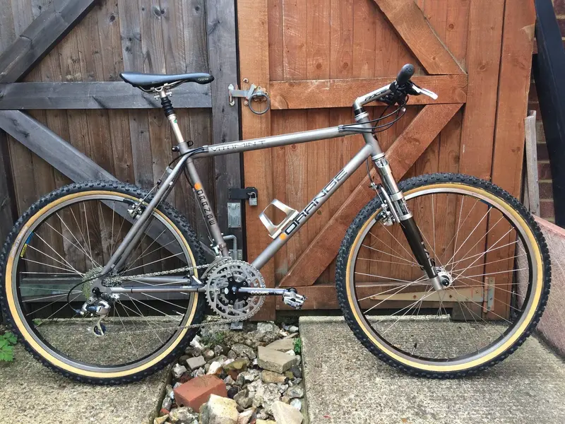

Here's my 1994 orange vitamin t

It came with a 1" threaded headset, but luckily Sandvik the manufacturer had seen the sense of using a larger diameter for the headtube, to avoid that horrible mitre where a larger tube is cut to fit into a smaller one, so I could move forward with fork technology, as long as it's about 80mm travel😄.
In its current guise it has custom shortened sids (tft👍) running 9 speed xtr/xt with IS hydro tabs fitted by Vernon Barker about 20 years ago.
All other ongoing changes have been made at my place of work - Bikeworkshop in Bristol (est 197:cool: mostly using second hand parts.
No cracks yet🤞.
Still riding where I live in the wye valley and black mountains. Still fits me like a glove and rides like a magic carpet😍

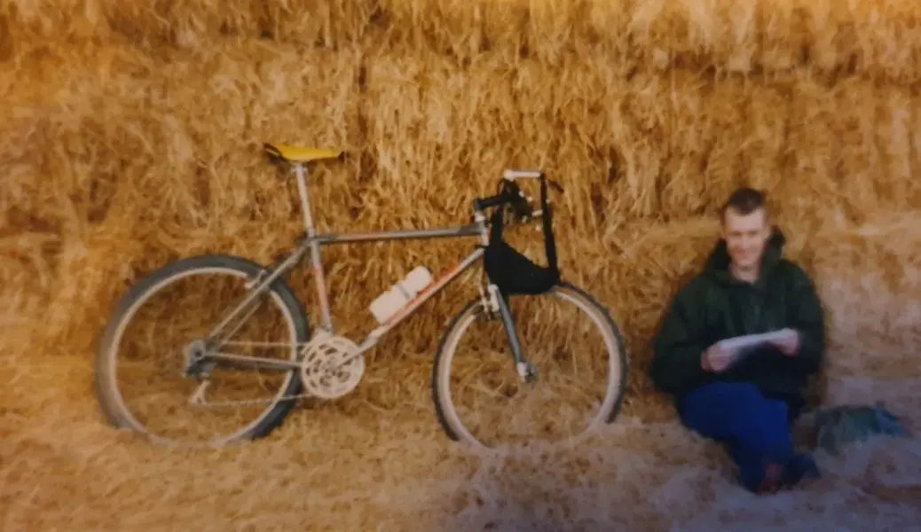

Here it is again, around 1997?
20240209_170739.jpg (Still got the cantis) Shame the bumbag (stylistically unacceptable now obvs but surprisingly handy for a repair kit, snack bar, house keys and a couple of tenners) is covering the crown of the magnificent Amp Research Forks.
They were:
Light, with killer looks.😎
They were also:
Uncomfortable, vague, delicate and quick to wear out.😵

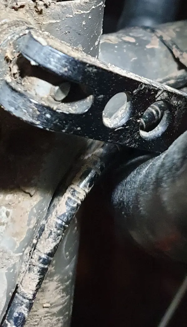

Just noticed the Nokon Track Pearls whilst photographing the ringle seatpost qr skewer...
Much more expensive than shimano SP51.
A little bit lighter.
Many, many more pieces...
Needs cleaning daily for good shifting in the mud, as there's a little gap within each ball and socket joint, of which theres half a dozen every inch🤣
Fitted around 2000?
