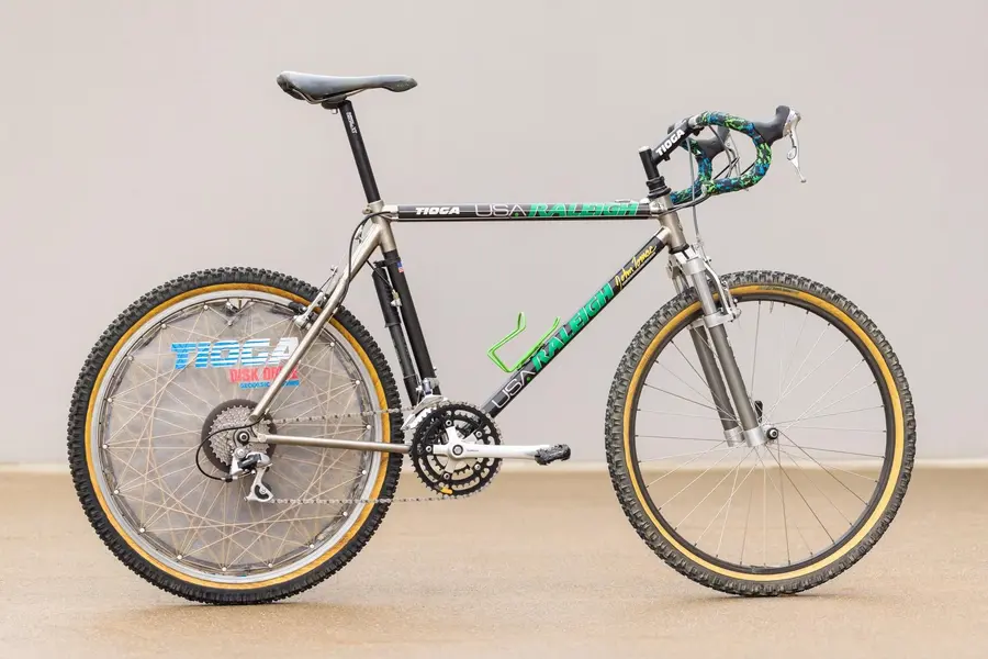

The John Tomac Raleigh 1991 team bike gave me the idea für the left shifter.
Post a photo of drop bars on a mountain bike, and chances are, someone will reference the American rider John Tomac. In the late 1980s, this BMX racer turned full-on MTB superstar and became known for sporting a style never before seen in the growing sport. Drop bars, Tension Disc, and...
theradavist.com
He was using a brifter on the right side and a bar end shifter + aero brake lever on the left side.
I'm guessing for the same reason: to have more control over the front derailleur?
