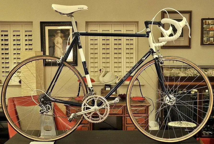

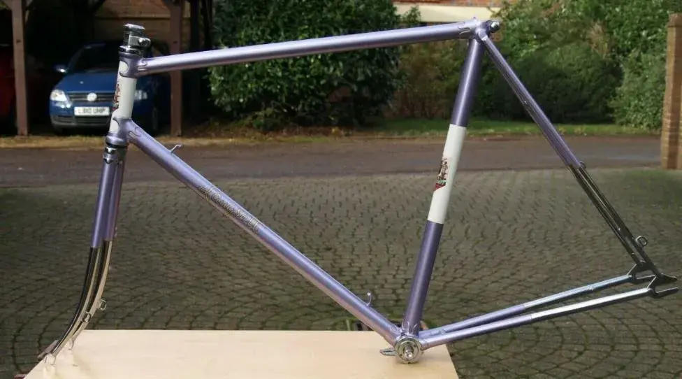

Excellent. I thought it might beone of these:
This is a very late, '77 or so, bike produced when Langsett tried to revive their brand. But your dates rule that out. Didn't last long though. It's for sale here:
https://www.ebay.co.uk/itm/Sheffield-La ... %7Ciid%3A1
Or, if it's one of the bikes produced between 1952 and '64 it can be identified from the frame number register in Stuart Smith's super little book about the history of Langsett bikes. When you retrieve it send me the frame number via this post and I'll look it up for you. Should be under the bottom bracket. And start a thread yourself - with pictures, 'cos we do love pictures!
And this has just popped up on ebay too, here:
https://www.ebay.co.uk/itm/Vintage-Lang ... Sw59Jfur8Z
They're just like buses - you don't see one for ages and then 2 come along at once :lol:

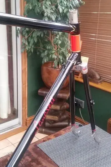

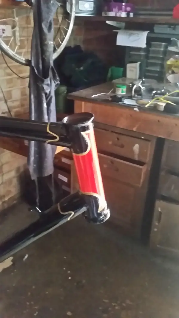

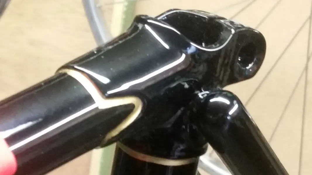

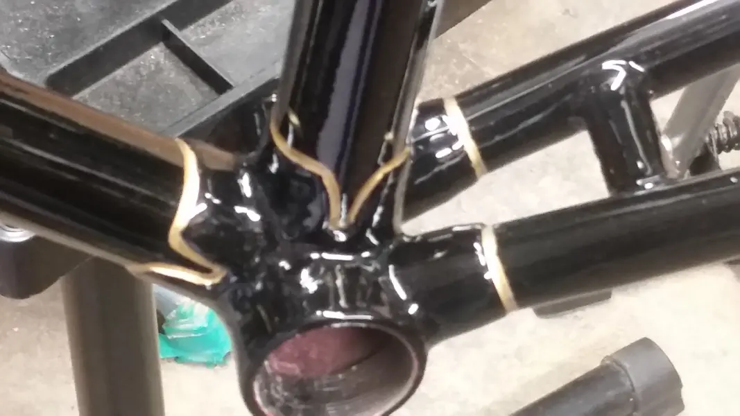

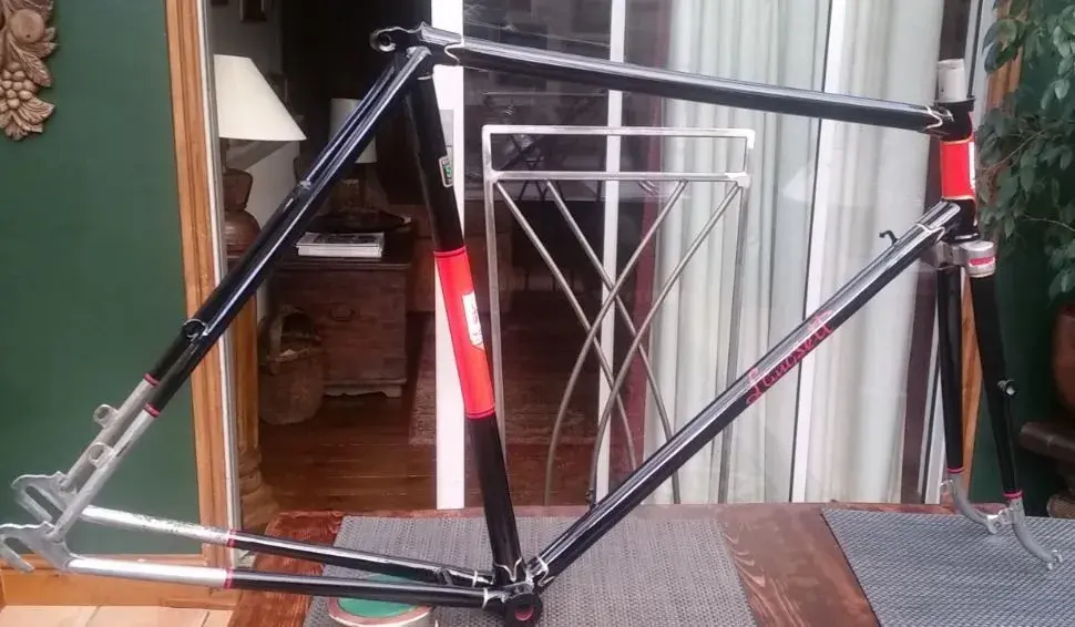

The lining is perhaps a little thicker than I would have liked, but with these lugs quite a long brush stroke was needed, compared to one I did with nervex pro lugs which had much shorter bits to cover with one stroke. Overall I'm happy though - and the decals will lift it a bit more.
Stickered and clear coated. I think I'll probably have to start rebuilding it now.
Too late now, but I should have gone for the gold down tube decal. Hey ho...
And I set the 531 a little lower than is usual - to leave adequate space for the SA seat tube pulley.
