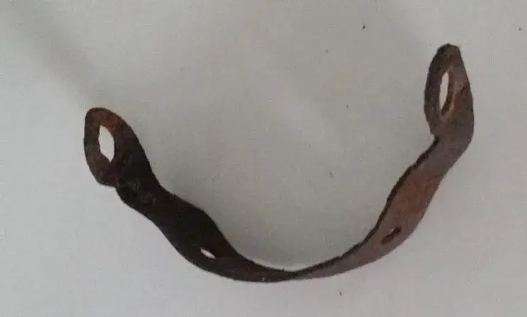

The bike has Bluemels "No Weight" mudguards. The bits that are riveted to the guards (I don't know what they're called) where the stays attach, are as rusty as anything I've seen. I'd like to replace them if I can find spares. I'm happy to rivet or bolt on new ones. Anyone know 1) what they're called and 2)are they available anywhere? Pics attached. If no luck here I'll post to the wanted ads.
I guess I could buy a cheapo pair and remove them?
Let me know what you think.

Hi, check out Graces Guide, it's a brilliant resource, you'll see that Bluemels Noweights were made from 1904 and still advertised in 1955! although the shape changed over time
Raleigh Record Aces were fitted with these as standard in the 30s/40s/50s.
I have a set of Bluemels Tuflites which I can't find any information on - nowhere, nohow and never!
https://gracesguide.co.uk/Bluemel_Brothers

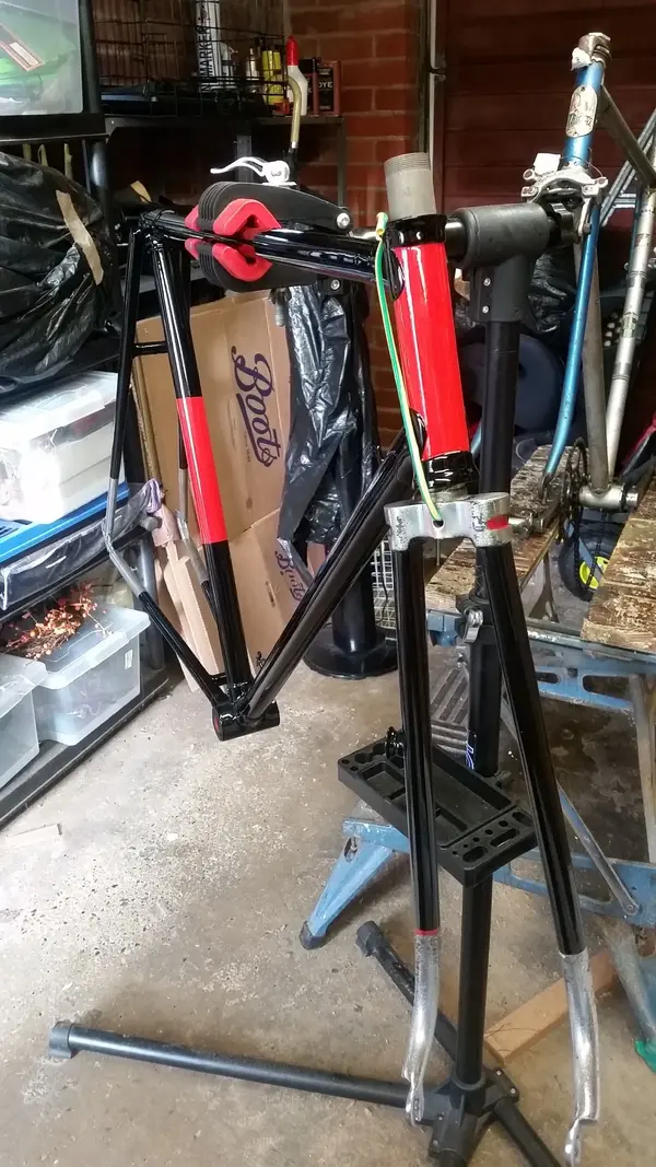

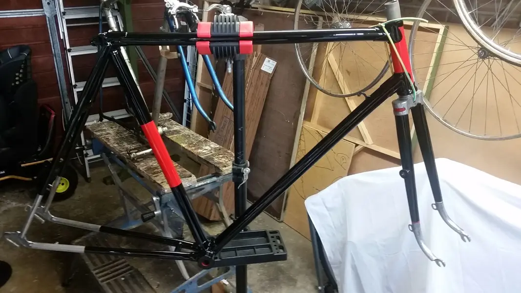

Back (or should that be black) from the paint shop - wet paint this time. I think the old thing deserved a proper job. There are some decals winging their way here from Steve at hlloydcycles and the painter will clear coat when I've fixed them.

Thanks Jamie. It is a great job in my opinion too. I have some red/black bands coming that will be useful to "punctuate" the joins, if you know what I mean.
As to who? "Lustre Coatings" here in sleepy Norfolk. If I said they do work for Porsche you'd be able to guess they're pretty good - although I was unaware of that when I took the frame to them!
I'm planning to do lug lining in gold (paint not leaf :lol: ). Hoping I can do justice to their work...
