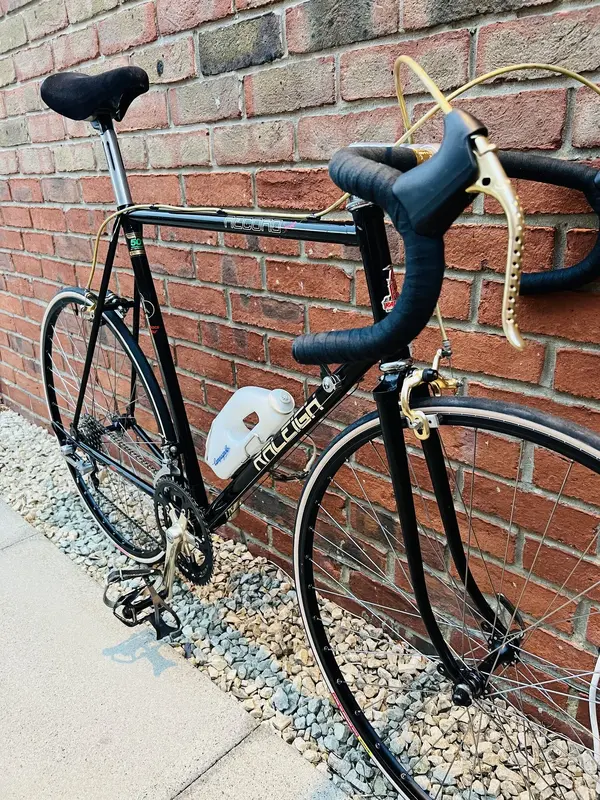

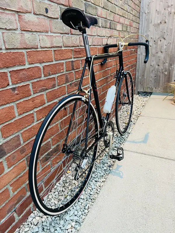

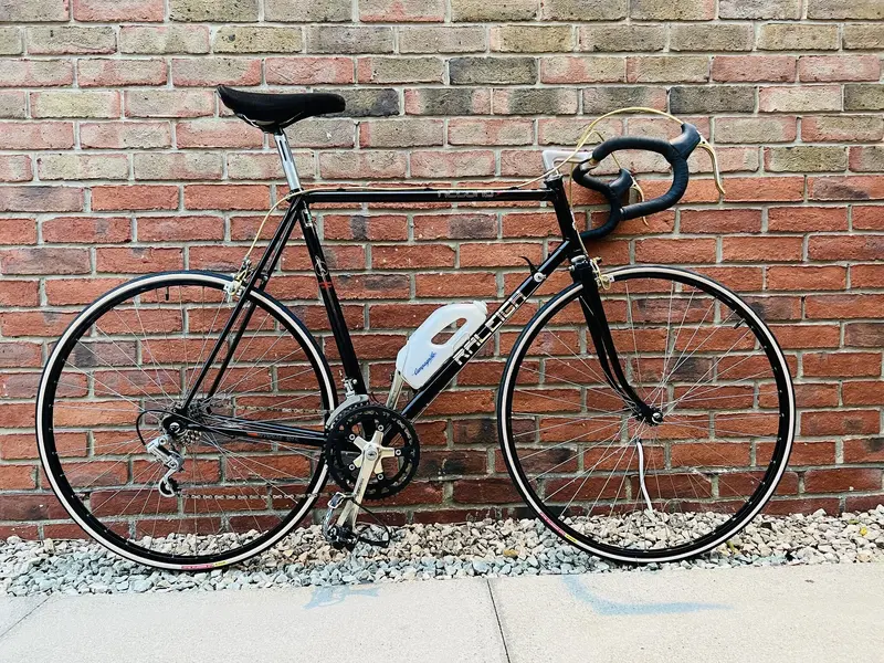

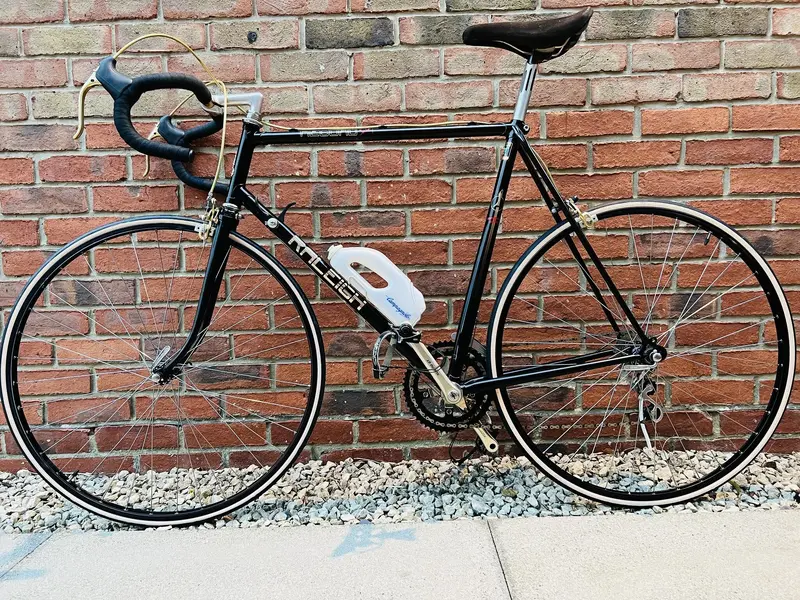

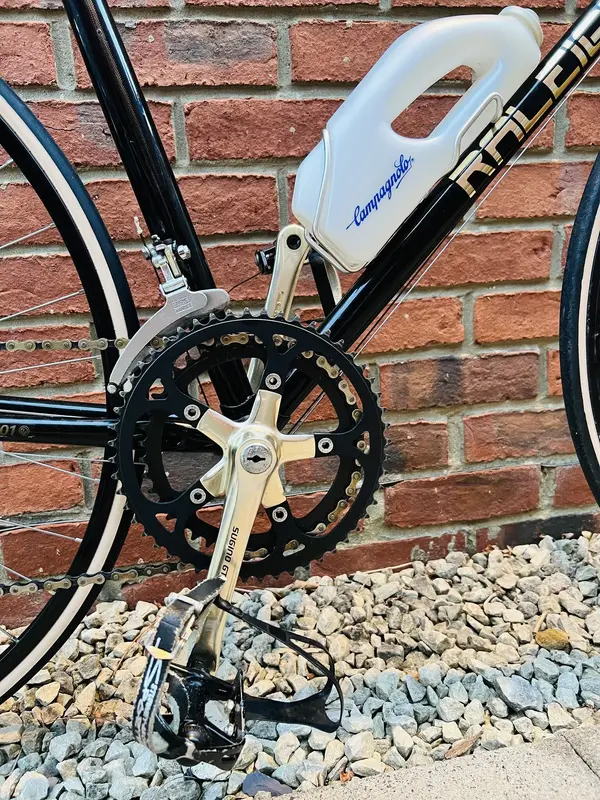

And so it is done, and consigned to the Ceiling of Nostalgia.
An amalgam of three separate bikes. The only brand new parts are the brake cable inners, and the spokes and nipples. I went DT DB on those which is not original spec, but it was one of the first things I changed when I had the bike back in the mid-'80s.
I feel like I had the bike for a long time, but if it was really 1986, then by 88 I had bought my first MTB. There must have been a crossover period before I finally gave up road bikes for good. After repatriating it from my Dad's shed, sometime in the 90s, complete with trashed frame. I then rebuilt it all with the Raleigh 531 frame my brother reluctantly had to give me as recompense, and 600 gruppo. Of course by that point, it was probaby only the bars and saddle from the original Record Sprint.
Still, all in all an enjoyable rebuild/resto and not too expensive. Probably under £300 all in.
