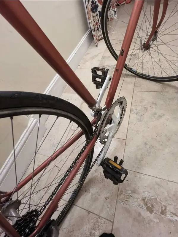

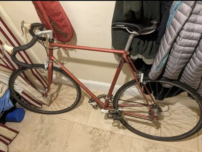

That’s probably the best idea! Any ideas what model this is?
update so after being messed about red collection of the record race I’ve decided against it. Picked up the “unknown” Raleigh above and it’s way too big for the mrs. It rides well and is in good condition with two brand new gator skin tyres which are worth more than what I paid.
Now the nerd in me needs to know what model it is. Theres some frame number under the bottom bracket one I can see has no letters just numbers and the other is covered by the protective plate that the shifter cable runs over.
Reynolds 531 frame with internal cable routing on the top tube and Shimano RX-100 components.
