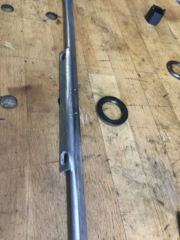

On Sunday, I made a tool (Haynes manual "...or you may wish to fabricate your own tool") for the Suntour lockrings, so I could tighten them down off the wheel.
The ends of that bit of angle, I flattened in the vice by using a length of scaffold pole to turn the handle. I didn't need to flatten them but I just thought it would look better. Of course, immediately I realised I can't use the tool when the freewheel is on the wheel, which I would need to undo a ring. However,
