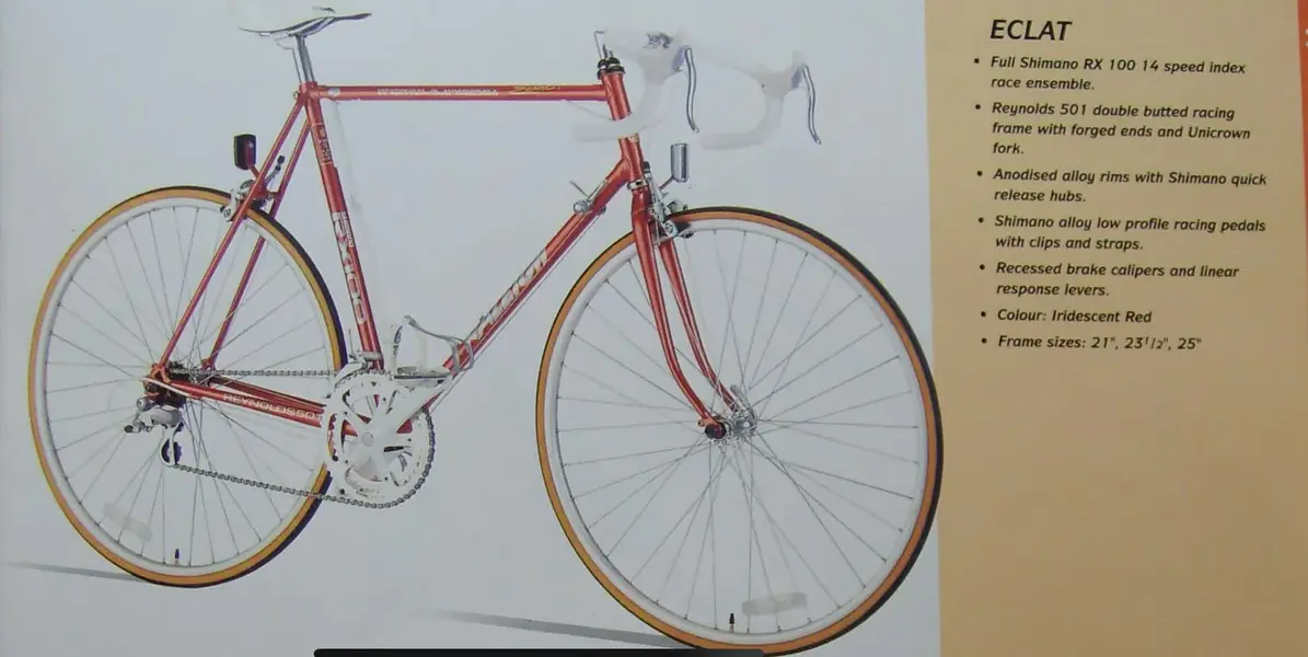

Here is the original from a 91’ catalogue my plan is to build her up with new parts in the same colour scheme (white seat 🤮) but with a more modern theme as a do it all comfort cruiser. Recommendations welcome
