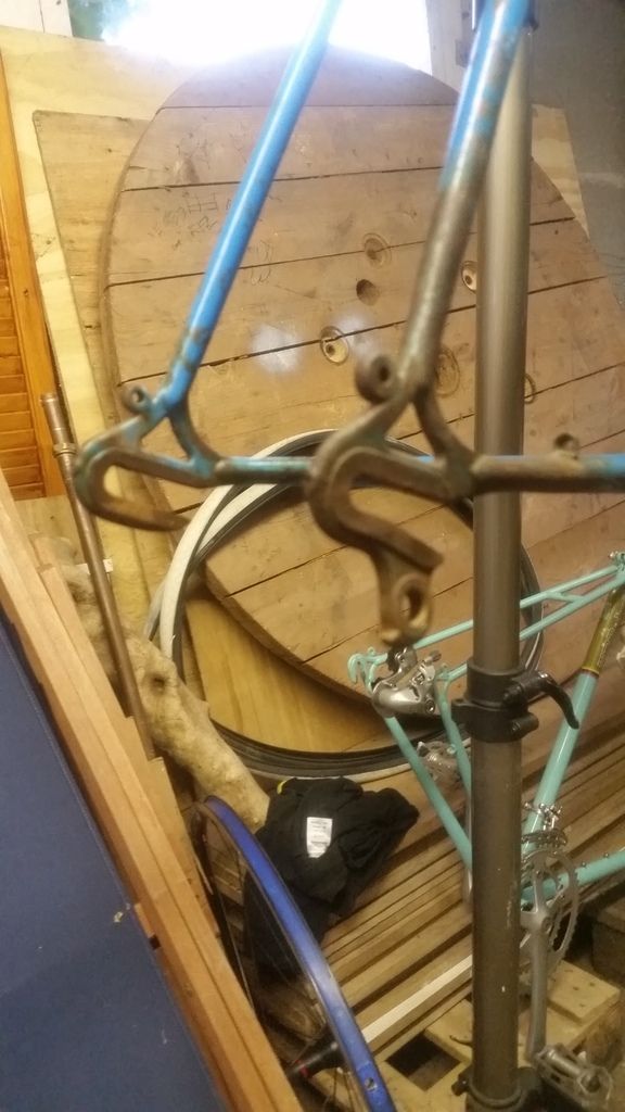

I've had a good look today when I stripped the frame down-I wasn't going too but I couldn't help it!
The only other number is on the forks and that's 0 111 (frame is 0 110). So still no clearer!
The only frame I saw with a similar seatstay design was an Ernie Clements. But everything else was different. Maybe we'll never be certain!

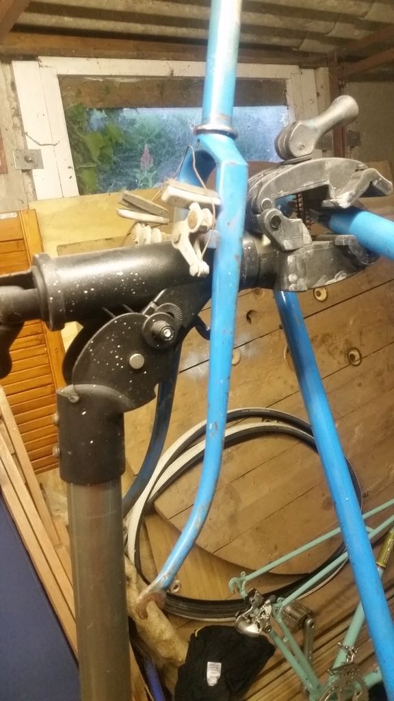

Whilst looking it over the only damage I found was to the rear dropout
Are there and Shropshire based frame repairers so I could get it looked at?
From there I'll plan the rest of the rebuild!

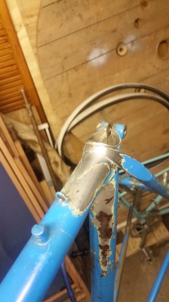

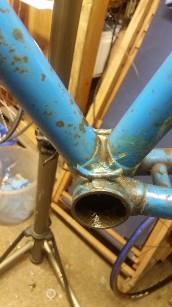

Are you talking about the curved bridge, or the seat cluster, or both? Curved bridges are usually a sign of a 'good' frame, in as much as they are obviously more trouble to build than a straight one. Taking some close-up pics of lugs, bracket shell, seat cluster, fork crown, braze-ons, etc. from a few angles might generate discussion as to likely provenance, but equally likely you've got a standard set of Prugnat lugs, Campag. ends, and all the other bits that '70s framebuilders were using to join their 531db, which could have been put together by any of several 'likely suspects', or indeed by Mr Bufton himself, or an acquaintance of his with the relevant skills.
Fwiw, the curved bridge, plus what I can see of the seat cluster, actually looks a bit 'Major Nichols' to me..
I meant the top around the actual seat post Is the only similarity.
I'll take some better close up pics later, see if someone can figure it out!
The reason I opted for Harry Quinn was that they seemed to make more CX frames than most at the time and advertised widely in the press.
The narrow wrapover and slightly pointed stays where they end at the dropouts remind me of Mercian but could be any quality frame builder :)
