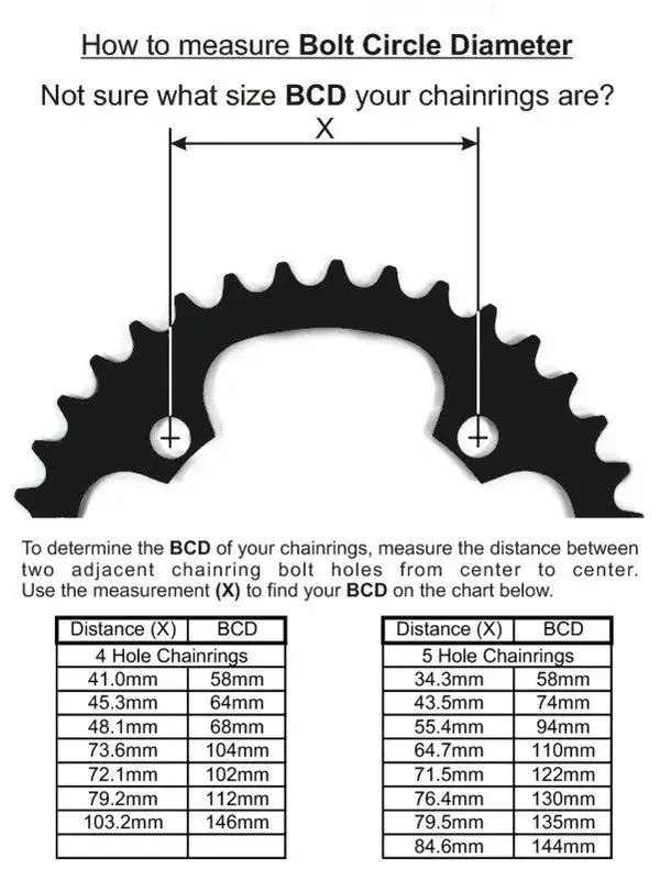

The link was for brake blocks? The rings are likely 48, 38, 28. You don't need to replace them with bio pace, round will be fine.
Different chainset, yours are square taper those are octalink which is splined, wasn't that long lived and bottom brackets while available, can be difficult to source. You can buy just the rings once you know the bolt circle diameter. This way you can just hopefully clean re grease the bottom bracket without having to buy a new one.
