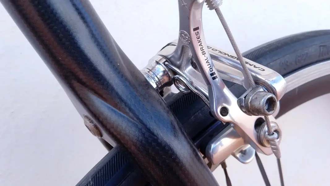

quick update, split the bike this afternoon to give it a good clean and put back together. Probably didn't really need it, but I prefer to know it's been built correctly. All came apart as if it was built last week and not 15 years ago or more, so that was a nice surprise. I've measured the seatpost at 29.0mm.

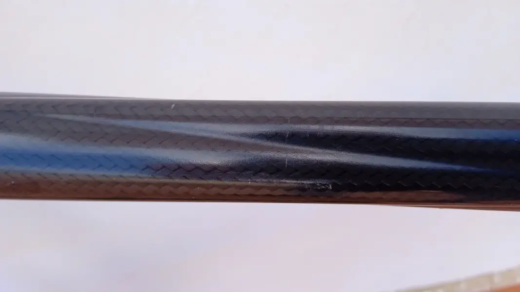

Looking for info on the ITM Millenium Wing Shape carbon bars. The sound of them, thinness of the tube walls at the ends, and a scratch test at one end have confirmed that they are alloy with a carbon wrap in the centre, so I will probably try them and see how I go. I have a set of alloy 3T belgian drop bars I could use instead though.

Weighed frame and fork earlier, must say I was pleasantly surprised!
Frame (large), fork, headset, stem and seatpost clamp, 1670g. Not bad for a frame at least 15 years old with threaded BB shell!
