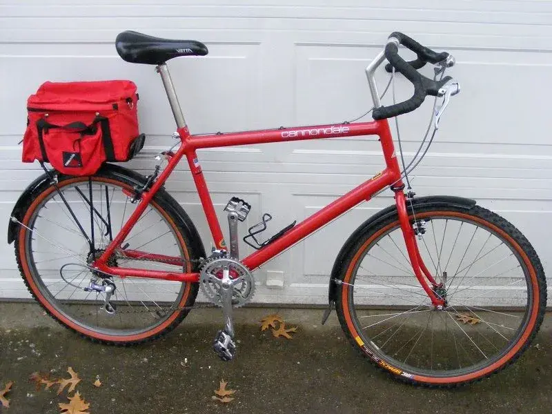

I have a drop bar Cannondale as well, an '88 running Specialized RM-2's, our frames look to be the same size, I'd be interested to know how tall you are. I too am not keen on bar-end shifters-your solution was simple and clean, well done. I went with 7-speed Shimano RSX brifters, not period correct, but so far reasonably effective. This bike is my commuter, but my commute has some dirt:
As you said it's not as harsh as expected, and there is a certain directness to the ride that is really enjoyable. I think they were using more ductile aluminum then, with greater wall thicknesses than the lighter-but-more-brittle stuff we started to see in the '90s.
I am still working on my setup and riding position, I am not in the sweet spot-yet. I've been looking closely at your pics and also the Bridgestone, I think they will help a lot.

That 88 looks in great condition and about the same size: mine is 20" c-t with a 22 at the beginning of the serial number. According to the frame stamps it was put together by SC and RS: who did yours?
You're right about getting things dialled: ideally I'd like a position a bit more like my son's Brodie in the pic: sitting 'in' the frame with drops around saddle height, but even though I'm only 5 10 ish, long old legs make that difficult with off the peg frames.
I was drawn to the 'Dale because of the high front end and generous head tube: but they also have high BBs, so I'm still a bit tail up.
The RM2s look a bit more flared than the BB1s: how wide are they?

It's in decent shape, quite a bit of touch up in various spots. The paint seems to be getting a bit more delicate as time passes, but it also gets used in the winter, and lives in a cold garage. I should be nicer to it.
My frame measures the same as yours, and is stamped RS and JD, so we have one employee in common. I'm about 6'1", I think this frame size is better suited for a DD build at your height than mine. After posting in the thread I decided to dig it out for a ride around the block. The setup isn't too far off as it sits, but the stem is flexy at this extension length and the width of the RM-2's (57cm) exacerbates that.
I guess the long head tube makes these frames look relatively larger than they are, and what I truly need is a larger frame to get it proportionally correct for me. I don't think I would have believed that if I didn't see your bike!
