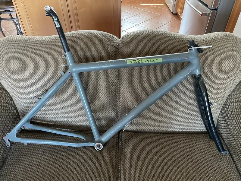

At the swap meet I noticed a Klein frame/fork advertised as “early 90s Rascal $100”. Very temping…
Why not? Frame is my size.
Needs all new paint/decals but don’t see any issues except: pressed BB axle is strangely offset with longer side on the NDS and 130mm long! More on this later

Not a Rascal but a Pinnacle. Please let me know if I’m off but all the Rascals I’ve seen are rear entry drop outs while Pinnacles are vertical drop outs. 1989 Pinnacles had under chainstay U brakes so it’s a 1990 or newer. I believe it’s a 1990 as there are no pre-threaded holes in the frame for the newly introduced anti-chain suck thingy for the 1990 catalog.

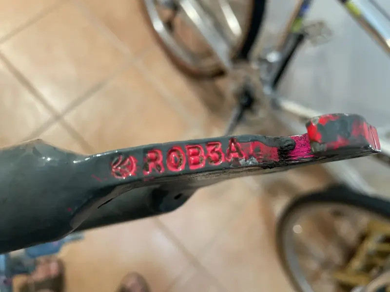

Serial number: drive side dropout found: ROB3A and 30 on the NDS. Any Klein guru’s able to weigh in?
Sizing? “18, 20 or 22 inches”. Mine measures 16” to center of top tube and 19” to top of seat tube. Does anyone know if the frame is 18 or 20”?

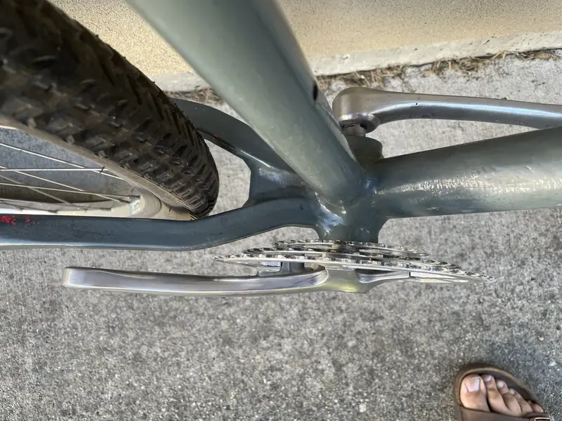

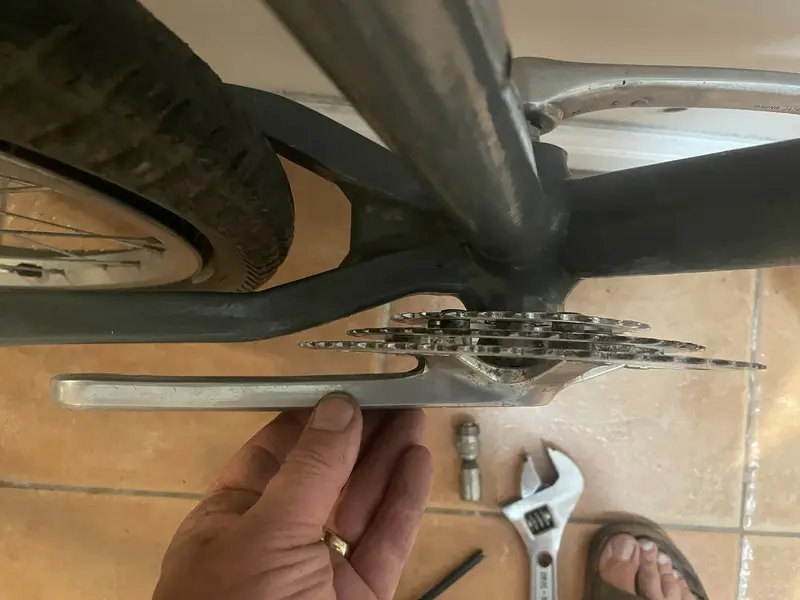

Okay, bottom bracket. I started by fitting a set of Suginos and ended up with much more clearance than I would ever want especially if narrow Q-factor is factored in. Also tried a DX drive side arm which seems better especially regarding the chainrings lining up better with the rear cogs (see below pictures). The NDS being out a few extra mm doesn’t bother me too much.
The pressed in bearings feel very smooth and solid with no play, part of me does not want to mess with the BB the way it is. Thoughts here? I really welcome input on what to do here. I figure M730 cranks are my best bet for fit.
If I did go down the bottom bracket swapping road. Can I just tap out one bearing side by tapping against the opposite side axle end? Will a shorter axle be difficult to source?

Nice score, especially for the money, Bonus you already had the MC1! It is indeed a Pinnacle (you already mentioned it: Rascals have the horizontal dropouts). IMO the Pinnacle is the nicer bike to ride, a bit more relaxed geometry due to the shorter TT. From the looks of it it should be a 20" (or shall we say "M").
Yours should have 130mm dropout spacing, as indicated by the "30" stamped in the NDS dropout. Pinnacle Elite presumably had "additional detailing", but I never managed to see what that was about. Or I never saw an Elite frame. Maybe Gary sprinkled it with Holy Water.

The BB spindle is press fit, so you should be able adjust the the chainline either with an improvised tool (I used a piece of pipe and washers with the crank bolt) or a rubber mallet if you´re brave. 130mm spindle would fit a Cook crank for example, XT 730 would need 120-122mm if you want it by the book. Maybe find someone to swap, the 130mm axles are much harder to come by.

Are you saying there are no internal shoulders on the spindle inside the BB shell and that the chainline can be gently forced back and forth with the correct tool (or improvised tool)? It would seem odd to rely only on a tight fit between the inner cartridge bearing race and spindle's outer surface.

If it´s an original spindle there are no shoulders, the press fit is really tight. Come to think of, maybe they also used some bearing retainer? The spindle on mine began to wander after 25yrs, could be failing Loctite. In my experiece it is easier to draw the spindle with a pipe/washers/crank bolt.

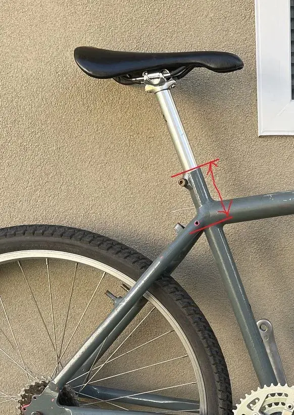

I would advise against spreading an aluminum frame, regardless of age/make, but you are right, especially not a Klein. The Achilles heel is stress cracks on the seat cluster due to using a too small diameter and/or too short seatpost and then really cranking the seat QR tight. These frames were heat treated to stiffen up the material and release tension after welding so are fairly stiff and don´t like continued tension.
I'd heard about seatposts that were too short causing damage to Kleins. I'm thinking of using a Syncros post that is only 250mm long. When I measure the frame insertion depth after setting my maximum seat height the bottom of the seatpost would end up just below the seatstay/top tube junction as in the picture below. Would you say the post would be deep enough to not put unusual stress on the frame?

I have the seatpost on my Pinnacle round about the same length inserted and keep telling myself that this is enough. But ideally it really should extend a couple of cms further down. I even sourced a post which does just this, but it´s in the queue for anodising and I´m being lazy with the prep 🙄
