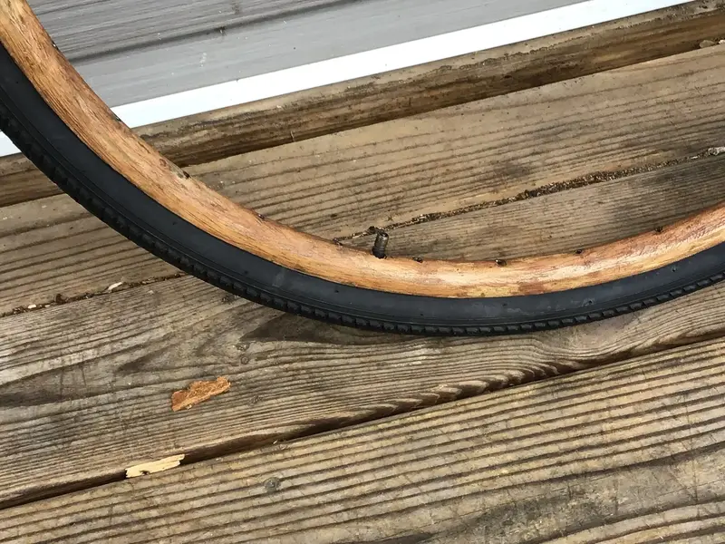

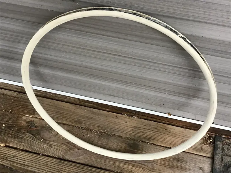

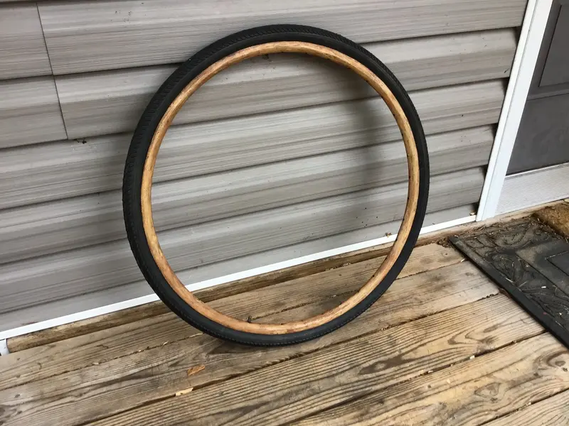

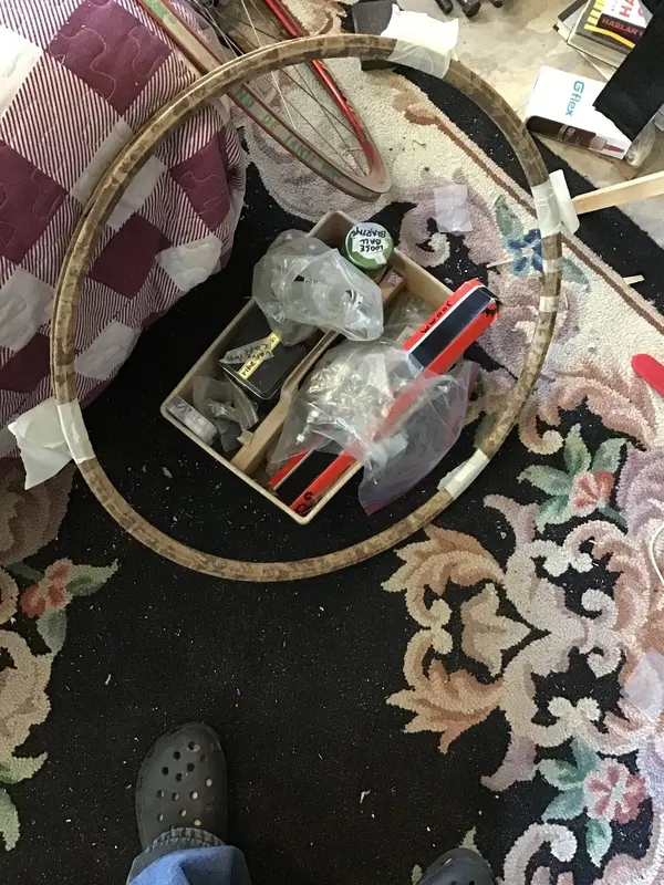

If anyone is interested I can post the method I used to form these rims from outdoor stainable flexible marine epoxy. It’s formed around a standard alloy rim. No more worrying about the spoke tension getting soft as the nipple head washers sink into the wood. It’s a slow process as each coat has to dry and the stain takes several days to dry. It has a paper fiber underliner. The main lamination is made from wood flower reinforced epoxy and is easy to sand and stain. It didn’t chip when I mounted the 700c x 38 tire. It’s a thin coat so the tires were pretty easy to mount. Next I’ll lace them up with vintage hubs. Someone with more skill and patience could do a much better job. Since I’m skill less I thought I just go for faux old. I didn’t do any research, I just tried it. 3555D657-6BA0-4885-8294-B5DD247796A3.jpeg 53384986-6851-4877-858B-A059E7373F1D.jpeg

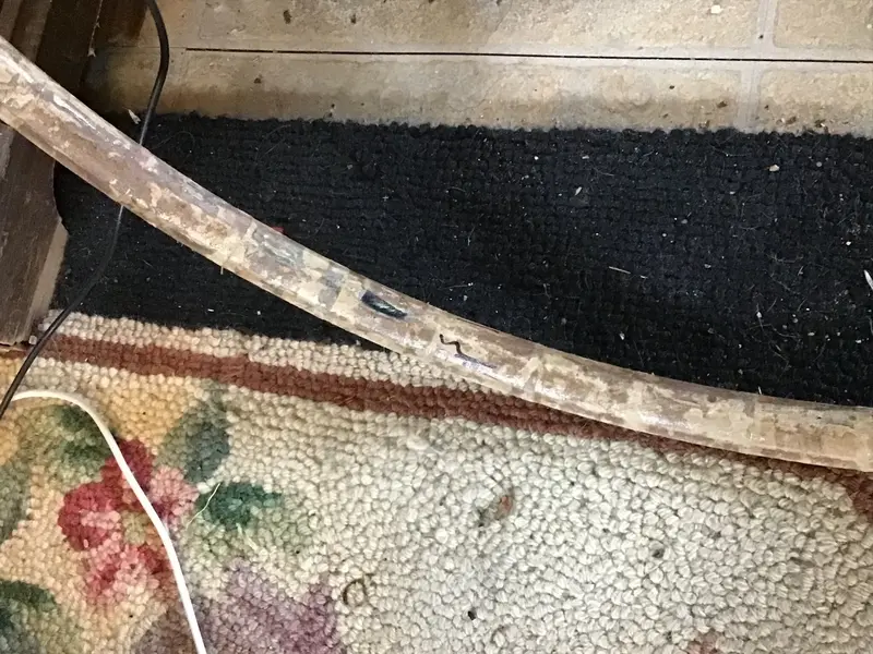

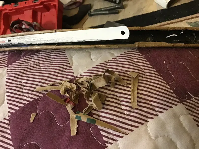

Look at my third picture in the above series of photos. The black magic marker line and the place where the black alloy are showing is where the wrapping wasn’t glued and made a hollow sound when tapped after the flex epoxy dried. You have to use a razor knife to slice through the wrapping, lift the paper, squeeze in some epoxy and wrap tape around the bandage. It’s important that the paper is well glued to the rim with no bubbles. Here is the photo again. F45A40C5-0D9A-4DB5-A375-91233A94BA4B.jpeg
