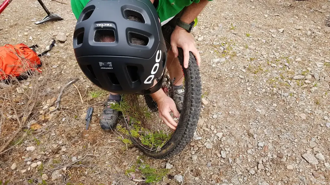

I have managed to get off the hill using heather instead of a tube (twice) when the tube was DOA when pulled out of my pack, but . . . more of a last resort type of thing ;-)
2manyoranges
Ah the Jo Burt method.
