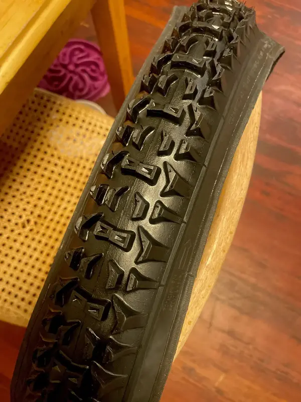

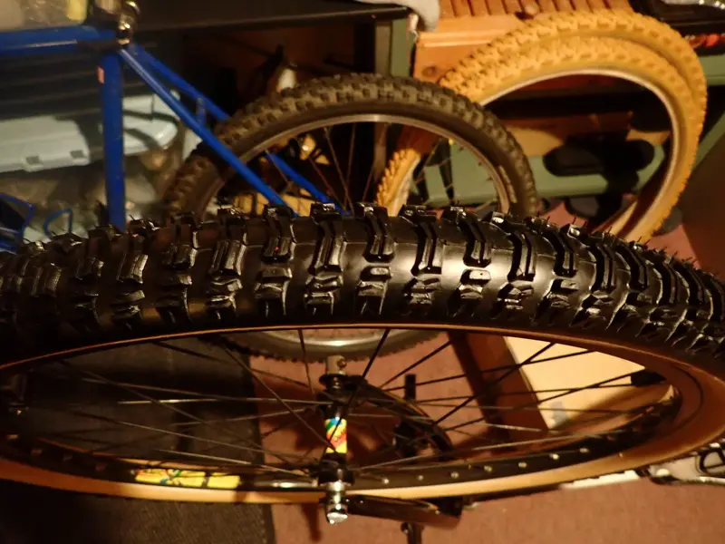

FireMountain95":2runj4mh said:
Look awesome, only needed about 10-15mins of baking....
Bravo! My education costs weren't completely misspent! :p
Thanks for sharing. Science doesn't lie.
John Deere Ultra Guard works great, I use it on 19th century bicycle tires up through to my modern bikes. Tires that seem spent often are brought back to life.

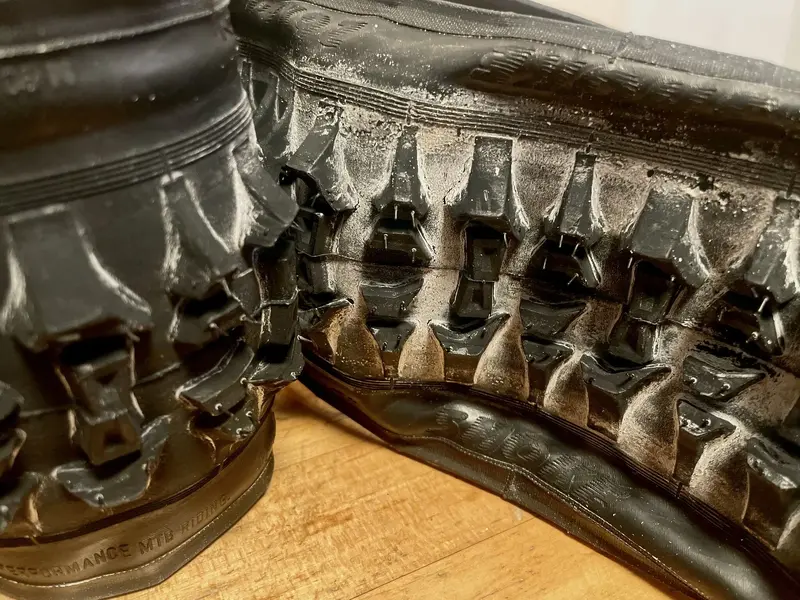

After previously using the sauna tactics, I've found that the fastest and easiest way to get the dust like compound back into the rubber is to use a hot air gun to the surface. This will though work only on a otherwise flexy and healthy tires where the only issue is the dusty white surface. Takes only a few minutes to blow a pair of tires through, and won't compromise the tires as it takes only a really short blow on each part of the tire to get the surface 'clean'.
Just did this on a set of Michelin Wildgripper DHs and they turned out nice and fresh!

Before and after with a heat gun. P1010057.JPG P1010060.JPG P1010087.JPG P1010088.JPG
Slowly spun the wheel and held the heat gun 10-12 cm away, after the wheel had rotated 6 or 7 times the white stuff began to liquify and was absorbed into the surface of the tyre, the tyre never got hot, just warm to the touch, and you can see by the moulding hairs that no rubber was melted.
