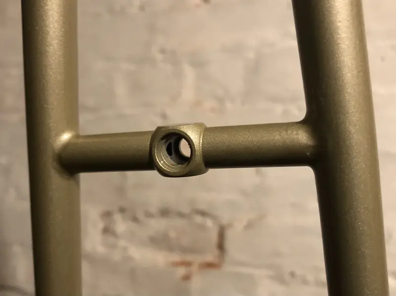

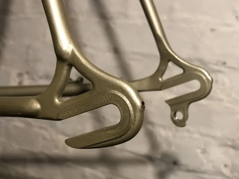

Something that did surprise me this summer was just how good this frame had been put together... I’d always assumed the big differences in the Holdsworth/Claud ranges would have been tubing and spec, but the frame builder at Bob Jackson’s who worked the changes I’d asked for (recessed Allen key brake drilling’s, new rear drops, clearance removed and re-brazed to the chainstay for 10 cog cassette, 130mm re-spacing and new brake bridge) came out of the workshop to talk to me about it when I popped in to collect the frame. He mentioned how precise the angles and measurements were, and how balanced the brazing was, he was full of admiration for it and suggested it was much much better than most of the Clauds that had come through for refinishing. Something I can attest to after riding it all summer...
It makes me realise that the shop sale person who suggested to my Aunt that my cousin wouldn’t tell the difference between it & a mass produced plain gauged Majestic really didn’t know what he was talking about... 94EB837C-8C68-4785-B756-40564510EF55.webp 43E85F19-3EED-43C1-ADE9-FE17AFB82254.webp 4D389223-1060-4AB1-9A07-0BCC48F87C05.webp

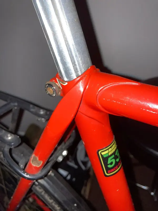

Hi, I wonder if I could pick your brains? I've been riding my Claud Butler on and off for 35 years and I've started to wonder what model it is. My father gave it to me - he brought the frame second hand but was too big for him. I've worked out it's a 1980 model from the frame number, but the model eludes me. I'd try the wheelbase but the forks (and thus rake) were replaced after and Audi 80 tried to remodel the frame in the late 80's - it was a nice short flight for me!! The treatment of the top of the seat stays suggest to me it could be a Colstar. What would you suggest looking at the attached photos? Many thanks.

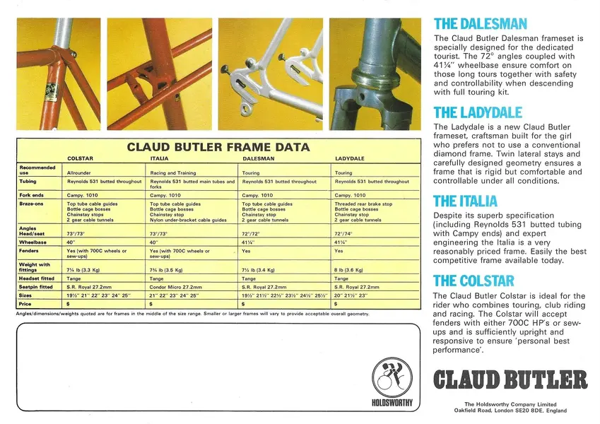

I'm not sure but that looks more like an Italia to me, the main difference was the Colstar was butted throughout, but the Italia had plain gauge rear stays and this allowed them to be thinner and a bit more elegant (in my opinion) with pointier wrap-overs, the other marker is the front of the head tube lugs (which I can't see from this angle) the Italia has a little point in the middle, the Colstar doesn't.
Also the Colstar has cable guides on top of the BB on both sides, the Italia doesn't. Hope that helps
