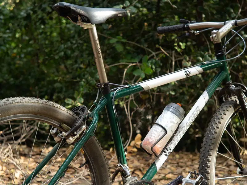

This bike was tuned for front susp: it´s geometry throws a lot weight up on arms and front wheel
Was it? We don't even know if it is a suspension corrected frame or not. The comp fork that came with this frame(from the original to the previous owner) and was on offer the same year as this frame was made had an AC of 395-400mm.

Susp corrected Bontys have a slightly shorter top tube: 22.6 x 22.75. Never saw a post 93 Bonty non susp. Beautifull bike, congrats.
Most people don´t feel any difference between curved or straight forks w/ 700x23 tires pumped to 100 psi...nevermind w/ 2.1 tires at 30 psi. Supple steel forks use lighter gauge tubing like the Fat Chance box crown. It´s more comfortable but won´t track rightfooted under power over heavier trails. A Potts P2 has a stiiff crown and light gauge blades. Bonty forks came w/ different gauges to chose. I suspect those experiencing shimmy have the lighter gauge. The yo eddy fork has big diameter non tapering blades and it tracks very well. Later on, Chance opted for smaller diameter, the BOI and the ride became more supple. It looks the Igleheart you have.
Bontragers have steeper seat angles and shorter rakes. It moves your weight over the front wheel among other things and then the feel from your forks becomes more noticeable.
