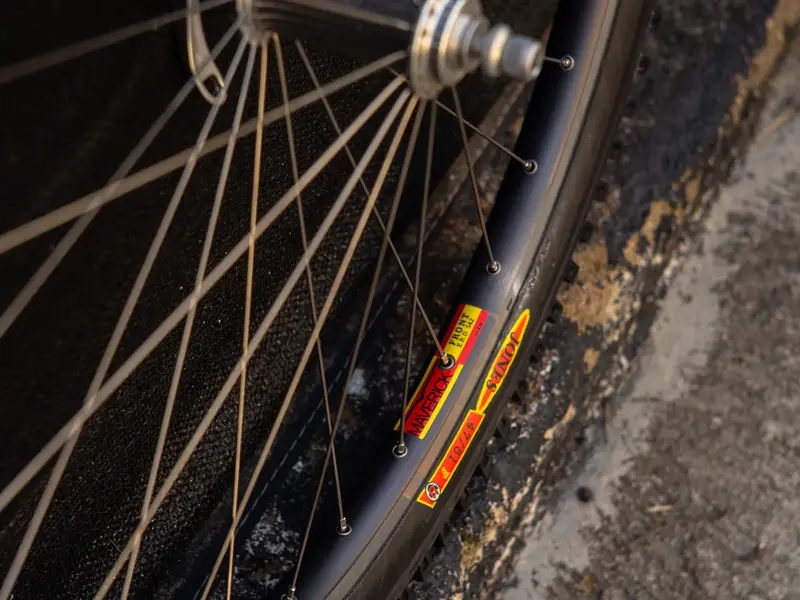

Sorry, last photo was pretty lazy...
the tire/rim logos lined up on the front and I hate it but I struggled getting the tires mounted and I can't be bothered to fix it yet. _1002166.jpg

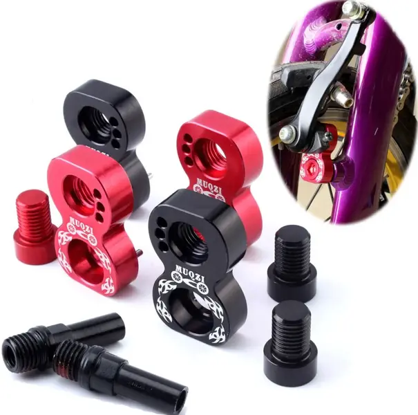

also would love a bonty cx , but if you can explain how to convert a 26” frame to accept 700c I might have a new project…
interested to learn more what parts are needed?
All you really need is to find a 700c canti post fork and move the rear breaks. Mine came with this little contraption from a brand called Muqzi.
It moves the whole caliper up though they also make one that just moves the pads. The rear brake would very easily lock up still though it felt really squishy which I'm not sure should be attributed to the little converter or the cheapo plastic levers/cables that were on there.
Mavic used to make a converter but I couldn't find one anywhere.

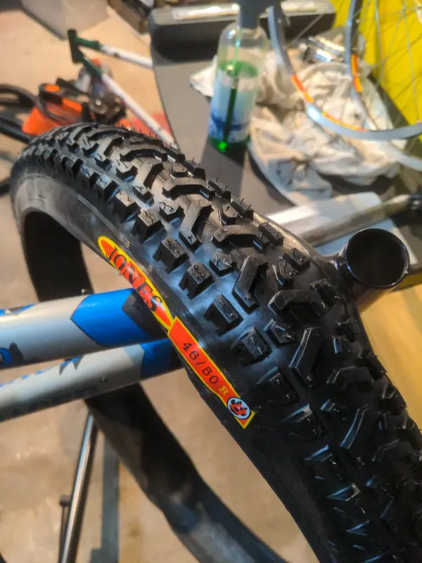

the tire/rim logos lined up on the front and I hate it but I struggled getting the tires mounted and I can't be bothered to fix it yet.View attachment 702953

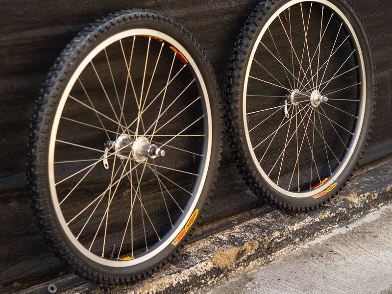

Nice! You have my wheels! Same ones I'll be building for my Race Lite. But you also have the tires, whereas I have mismatched pair: a skinwall Jones front and a black wall Jones rear. It's driving me nuts!
I know ! I'm still keeping an eye out for Jones tires for you.

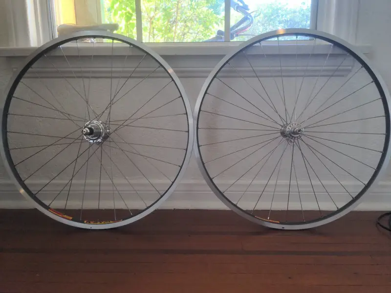

I found my mag 21 was only holding air on one side so I've got new valves that just arrived. I need to figure out how to replace them and see if that does the trick. Then it's just a matter of building the bike!
