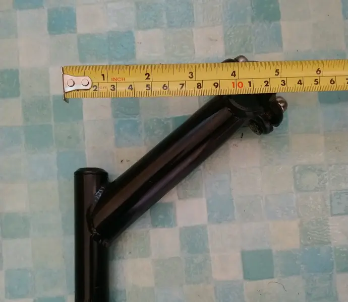

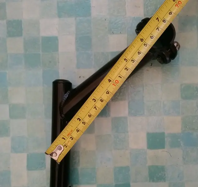

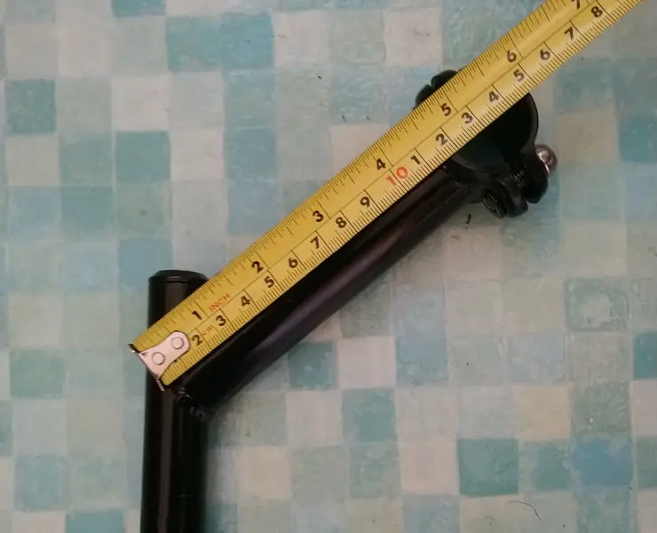

@Tootyred here you go, 105mm horizontal, 135mm centre to centre along the extension and 165mm from the limit line to the centre of the bar clamp, let me know if it's any good or if you need other measurements. I have no use for it, you're welcome to it if you think it will help. 👍 😁

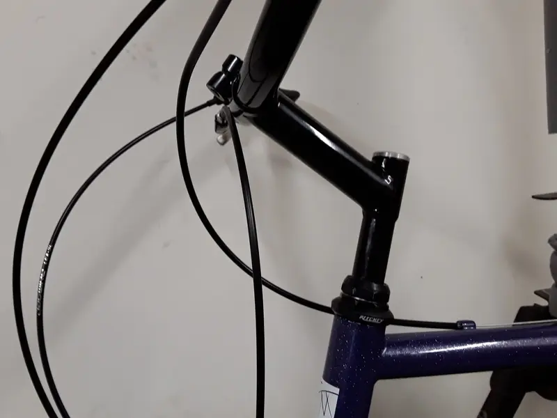

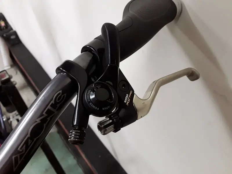

@benjabbi kindly sent me the above stem....thank you. It allowed me to set yo the bars and see where we were at. I even gave the brakeless bike a tentative ride up the road and back, having wound the rear mech screw in, to give me a usable gear!
It provided an excellent point of reference for the height, sadly, it didn't have quite the reach....annoying!
So, I've opted for the 88 marin roller stem, which has a decent degree of rise, a long quill and the correct reach. To get the bike running, ive put the Azonic bars in and have just about got the controls on....Its not perfect, as they are a bit close together ( levers too close to grips, thumbshifter a bit close to my hands at 3 O'Clock etc). Also, there is no space for bars ends, which i going to need, just to allow a bit of movement to ave my hands and wrists.
The plan is to wait it out like this (it is winter after all) and try to source some bars before spring.
The good news is i can at least now set up the gears and brakes!

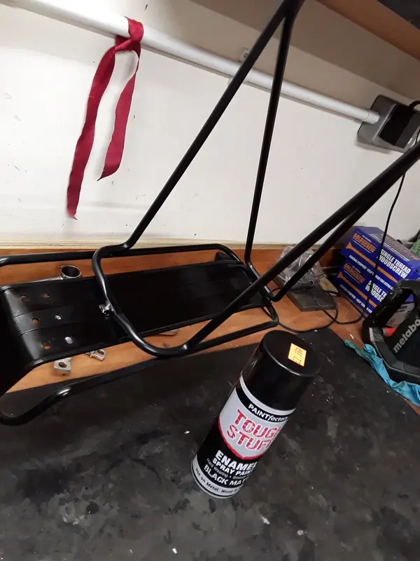

Back at home working on the rack for it. Was going to go with a front rack....but im just not trendy enough!
So, dug out an old rack, pretty chipped and tired, so, rubbed it down, coat of "tough coat" mat black, bobs your uncle. Stays are in the rust removal tank for a couple of days, now I've scrubbed the old paint off. Will bend them to shape then spray them up.

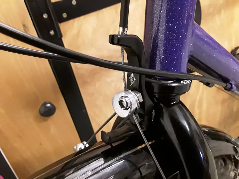

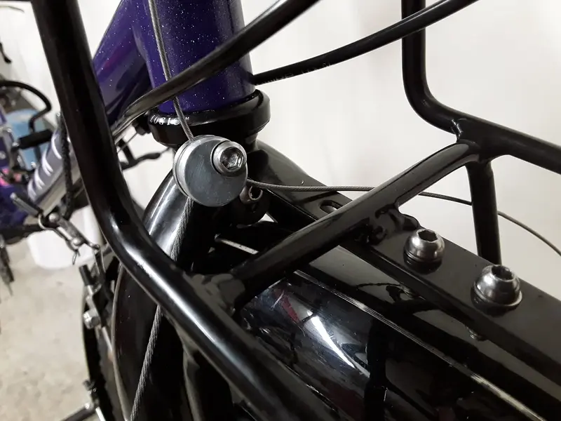

Second was the front brake cable routing; I love a roller stem....i think its a marin owners thing, but the problem comes when there is just too much length of cable from the hanger to stem to the hanger.....in this case huge.
I was getting some strange brake shudder.....tried a stem mounted hanger, then realised that i could alo solve the problem of not being able to easily shift bar height at the same time.
So i fitted an Origin 8 fork mounted hanger.....now i know this arrangement is not best liked, but the Origin ones are super stiff....i had one on an orange prestige and had no issues.
Brake judder gone and now im free to shift the stem as i wish. So if i want to do a bit of slightly more aggressive off roading whilst touring i can drop the quill right in and get the control back. Stem was divested of its roller and guide and re finished....as im unlikely to use it on anything else!

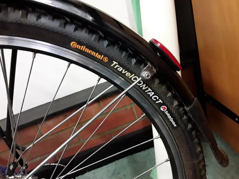

Finally, having tested the continental travel contacts and liked them, i decided to bite the bullet a get myself a folding pair with duraskin side walls. Lighter and a bit more compliant to ride on.
As soon as i get a chance to clean it i will pop up so e pictures of it finished with a full spec sheet.
