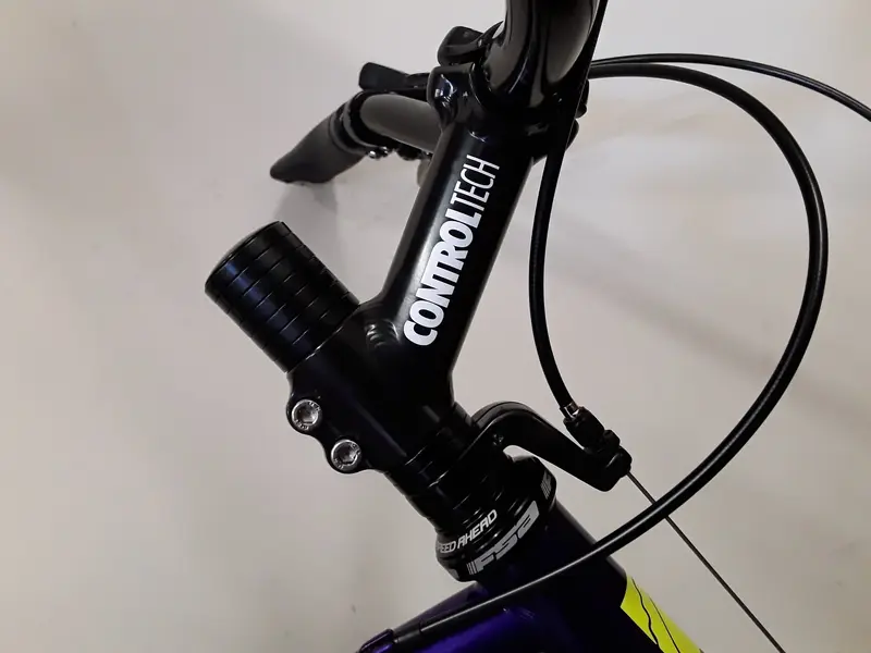

Here is the finished stem height / length arrangement.....
Ive chopped the steerer down, but ive left a fair bit so I can revisit the height now or in the future.....which is very likely......sadly.

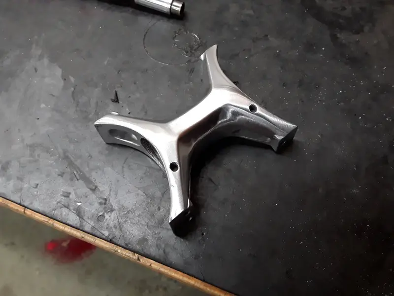

Last but not least is the pedals.....ive started work on some suntour xc9000s. Nice big platform, for big feet. Plus, sealed bearings.
The shafts need new chrome, the cages black cerakote, new bearings and seals, the bodies fettling and repolishing, oh and some new spanner flats.....other than that they are fine..🤣

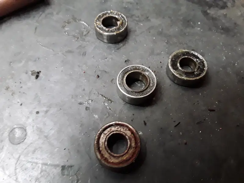

These were stuck in some cranks and the previous owner rounded off the flats trying to remove them. They were also pretty chewed up from use too.
Bearing removed, seals binned and replaced.

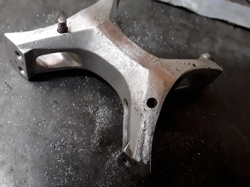

Ive filed out the worst of the damage to the bodies and sanded them ready to polish.
The damaged spindle flats ive milled down from 15 to 14mm to get the flats back.
More pictures to follow when finished.
