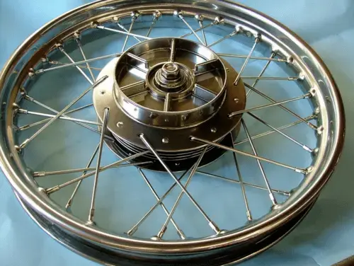

Try aeromax coatings....im about to get a frame "nickel" plated by them....
They have done motorbike frames and wheels for us....its very good.
The guy who runs it actually came up with the formula they use....he really knows his stuff. Its much shinier than the prismatic stuff I've seem......
