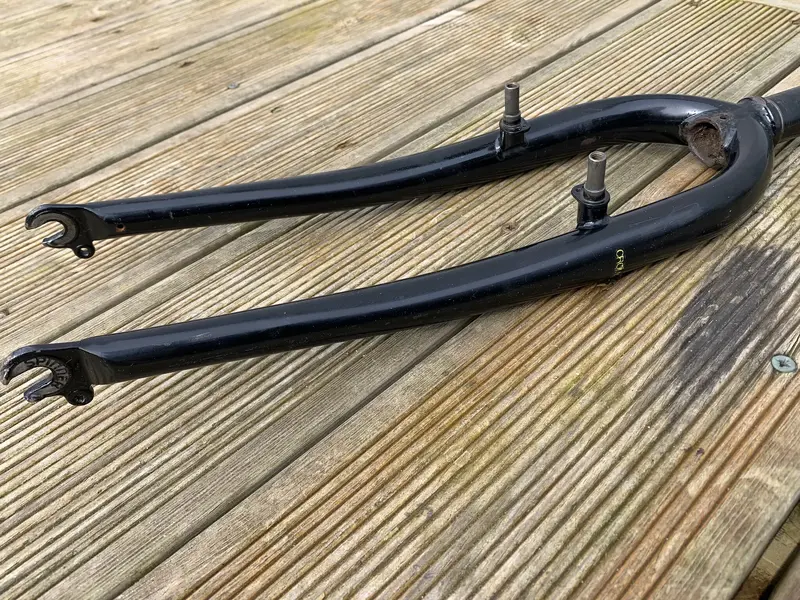

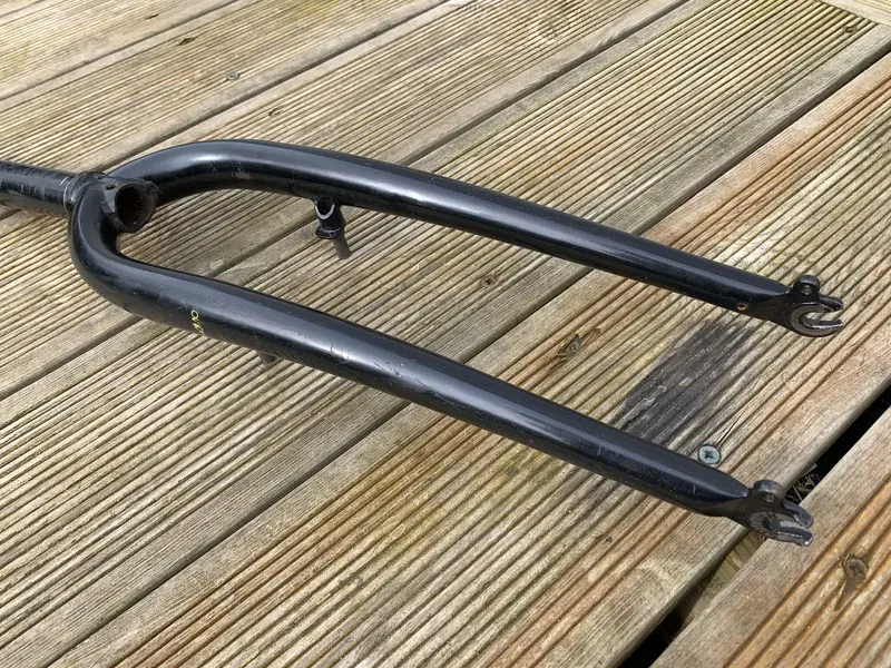

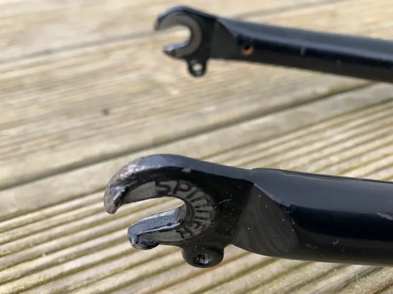

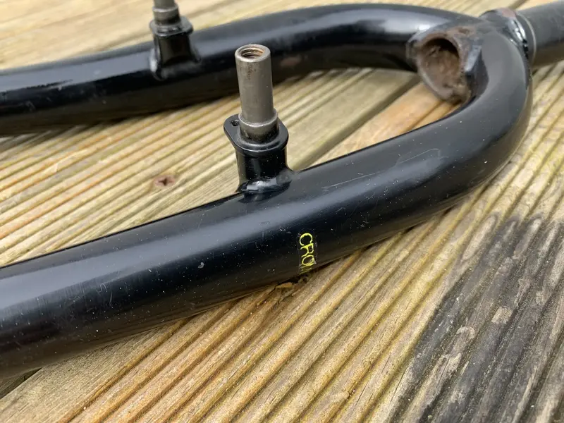

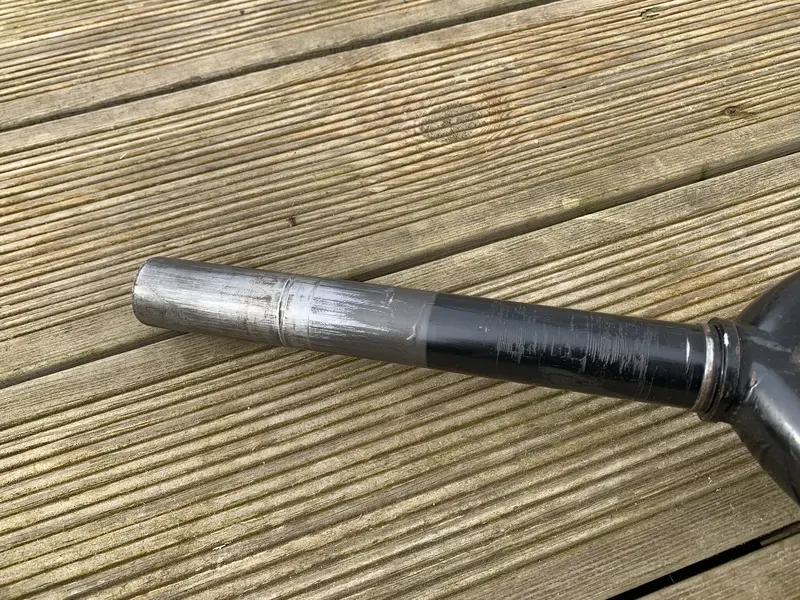

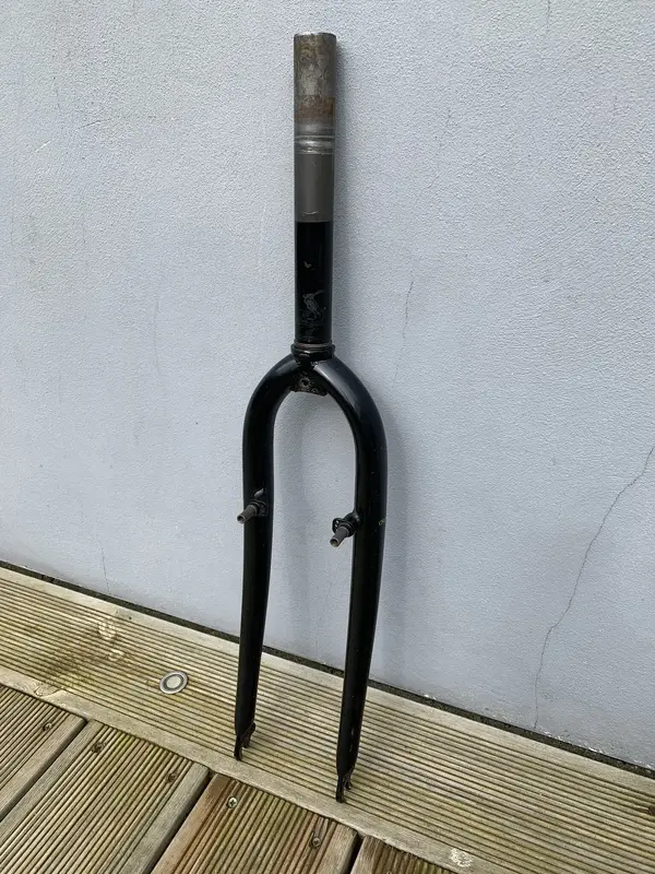

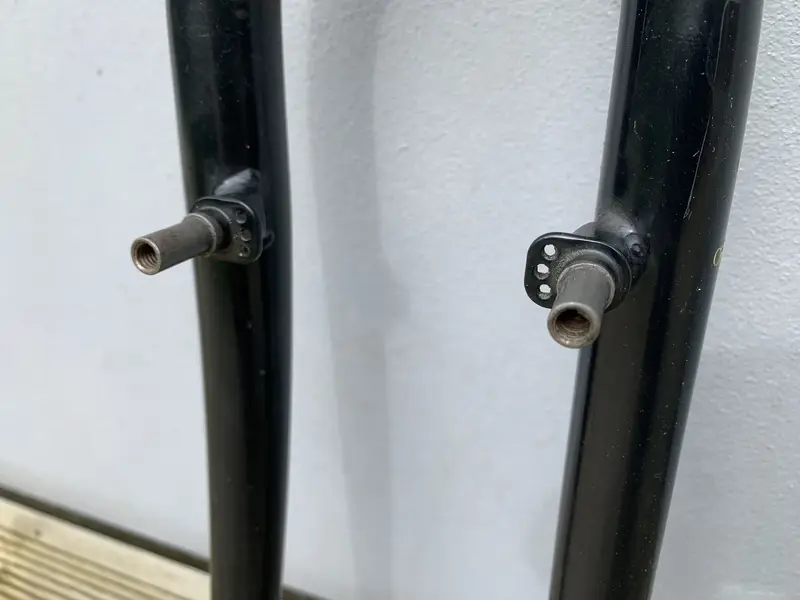

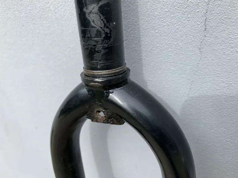

I have a pair of forks that might be ok for that depending on your steerer length (Not Project 2's though).
Black Cro-Mo Spinner, 210mm Steerer, 1 ⅛ Threadless and they're off a 97 bike.
I'll chuck a picture up if need be.
Yeah definitely would like to see them when you get a sec please mate!
They measure 40cm a2c. There’s a slight groove on the steerer (pictured) but it’s barely anything at all From a stray bearing or loose headset I guess. £23posted if any good.
They look like they could be pretty spot on, would you recommend giving them a once over with rust converter/T-Cut before i put them on?
I'll drop you a PM
