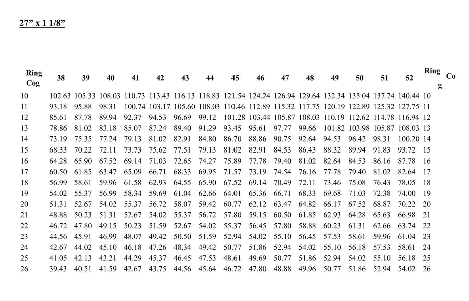

(Chain ring teeth / sprocket teeth) * 27 = gear size in inches.
Actually means nothing at all, it's just a way of comparing gear ratios without the awkward 2.1564:1 stuff as you can relate that <60" is really low while >80" is high and anything over 100" is really high. Our continental friends used to use 'development' (maybe they still do) in which they would use the circumference of their wheels in place of the 27 in the calculation. So a (say) 72" gear would actually be 5.629metres development for a 700x25c tyre, assuming the tyre circumference to be 2111mm - which again is an approximation as it depends on the tyre pressure and the weight of the rider but then if somebody is worried about such things they should take a deep breath and get a life.
Here's the gear inches for 27" wheels, 700C will be a bit lower and 26" lower still.
