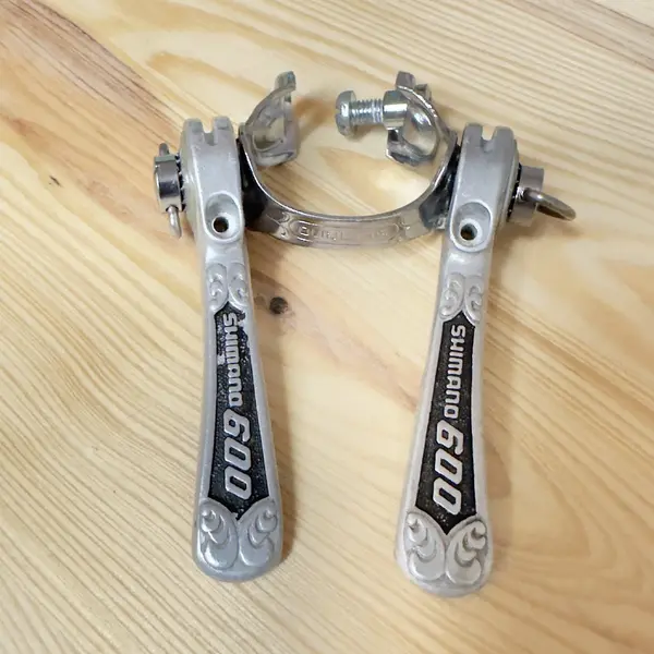

I made time and stripped, cleaned, lightly greased and rebuilt the Arabesque shifters, ready for fitting later on. The front and rear mech’s will get the same treatment nearer the time.

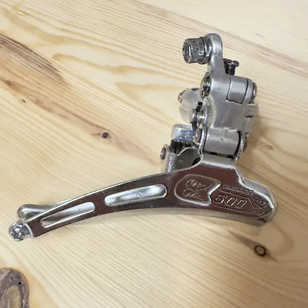

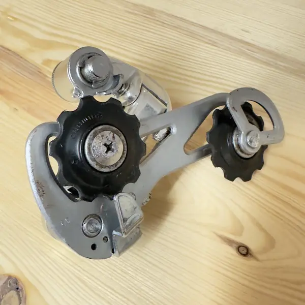

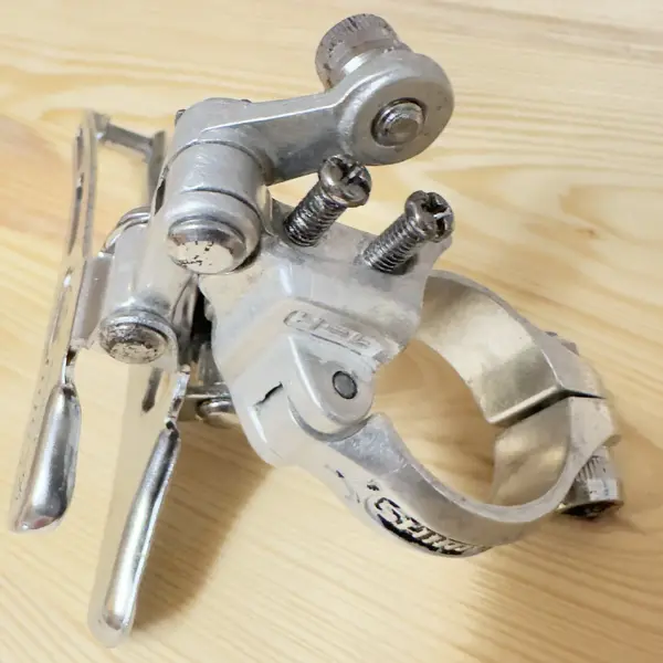

This evening I thought I’d strip, clean and reassemble the Arabesque front mech. That didn’t take long and it went smoothly enough, it looks better for it so well worth the effort. So I thought why not do the rear mech too, what a bloody ball ache that turned out to be. The strip down and cleaning was a doddle, the fun started with the reassembly. Long story short, I had to persuade the tab that keeps the mount and body spring tensioned back into shape to prevent it from slipping over the other tab. I got it sorted and it cleaned up pretty well too.
The gear set is now ready to rock and roll. I now have to dig out the chainset and bottom bracket I know is hiding in the garage somewhere.

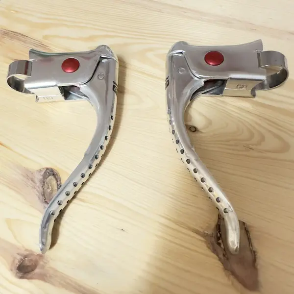

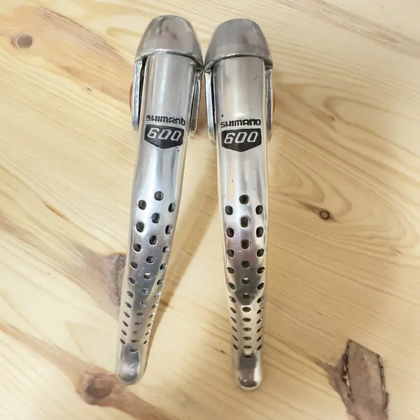

I guess you guys like pics, so here’s a few of the gear set and levers. Not perfect but clean enough and usable. The alloy parts might get a very light polish, just to brighten them up a little.
