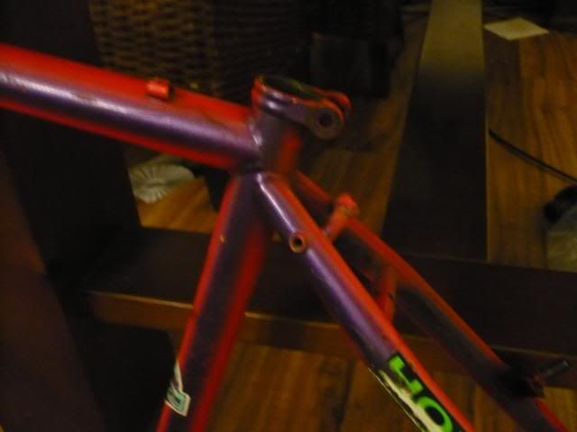

Need help with the ID of a specialized + seat cluster pics
I have just had a look at the seat post OD, without verniers it looks to be around 25mm, looking on sheldon browns site the only thing listed that seems close is the 92 stumpjumper FS.
Which fits with the serial number, although it leaves me puzzled with the build the bike came with M900/cooks which is a lot fancier than the DX spec it is listed as in the 92 catalogue.
Any way, cheers for all the assistance and please feel free to add any comment agreeing/disagreeing/questioning the ID.
Stumpy

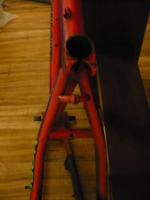

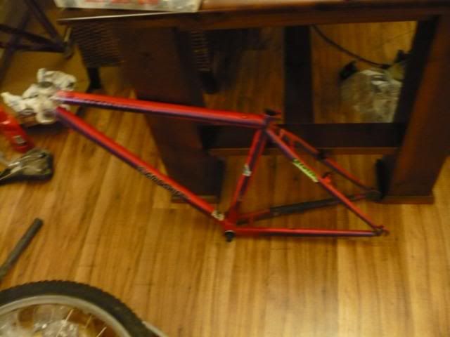

If you strip to bare frame and weigh it accurately that should give the game away as off memory the frames weighed 4 pounds and less for small sizes, the rockhoppers being single butted were way heavier than this. early Stumpies had a captive seat clamp tho, a shot of the seat cluster would help a lot.

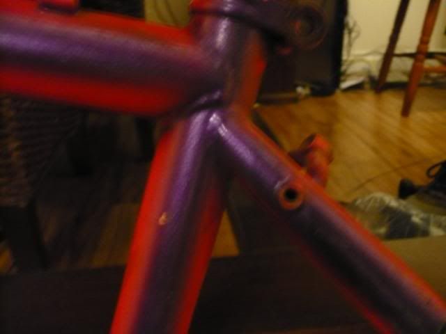

I reckon that just about sews it up as a '92 Stumpjumper. Everything matches the picture that pic that Pete posted, the style of brazed-on seat collar is right for the date, the serial number matches, and the rack bosses are brazed in, rather than on.
