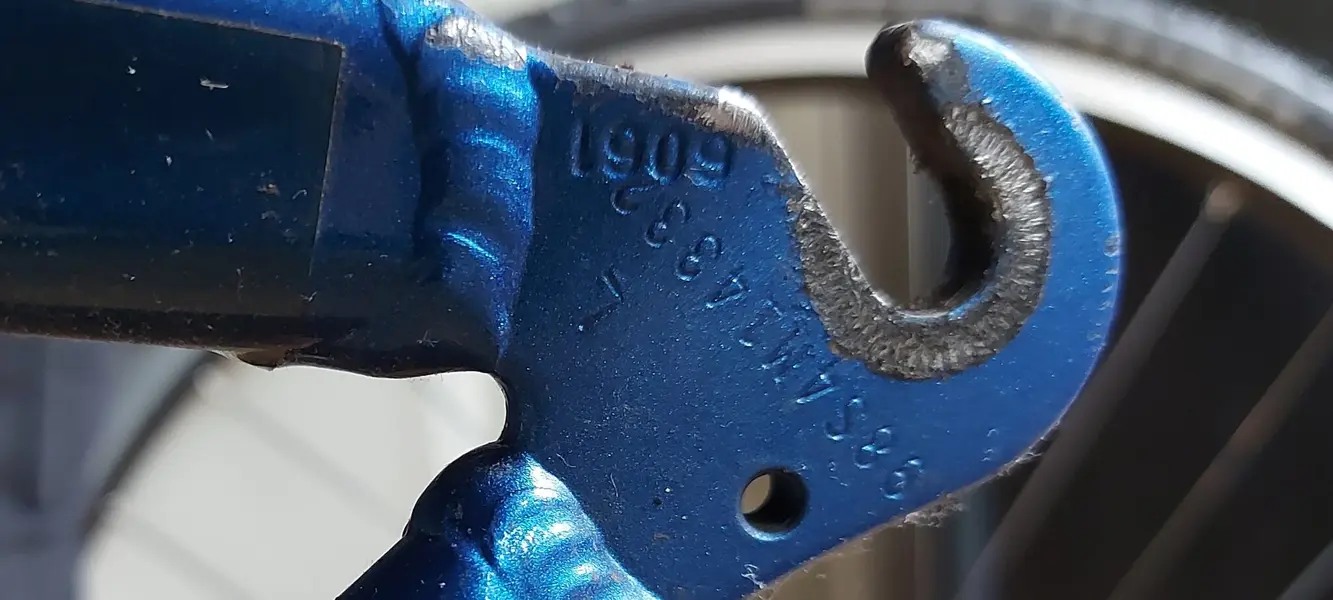

1998 Stumpjumper M2 Comp, 15.5” — 98S4M14332 L

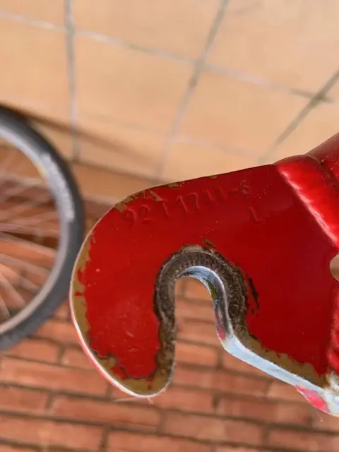

I have an S-Works M2, red with yellow decals. Never thought to check the serial number to date it :). Serial is 92T1744-6 L
Hi BCNBiker,

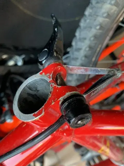

It appears you have a 1992 or 1993 M2 Team. Is the seat collar rounded or does it have sharp edges?
Hey Neko,
Here's a pic of the seat collar:
Btw, thanks for the post..interesting stuff! And to think that I almost sold the bike a few years ago for thruppence :eek:

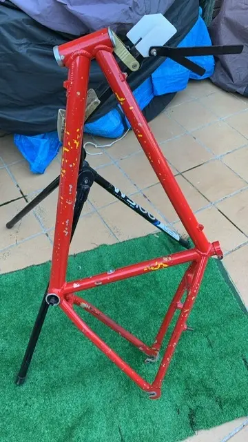

A pic of the frame. Pretty battered! Some original (?) components I've still got: Suntour 3x8 crankset, Specialized seatpost and saddle, and a 3T Forge Ahead stem.
The crankset and seat/post would have been original. The bike came with a threaded headset. It’s a 1992 S-Works M2 Team.

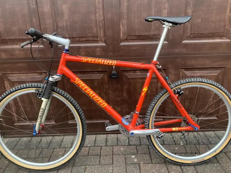

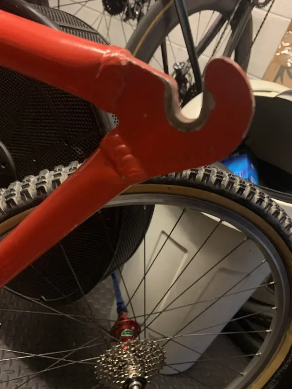

My retro stumpy best I can read on the serial number is 91101661?
Wow! That’s one of the first 500 Team Edition M2’s. It should be a 1992. I am still not sure what is different between these first 500 and the later 1992 Team’s, but the cable guides on the earlier ones are riveted, like a 1991 (which would be consistent with the 1991 SN). That build is clean too!
