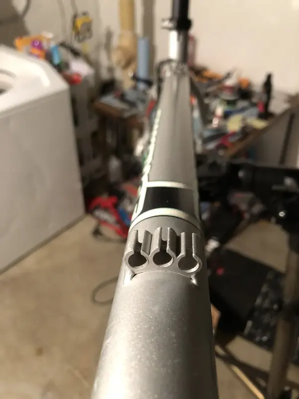

I’ve a 2000 Kona Pahoehoe that has two cable guides on the top tube. Each guide has three allocations for housing, one of which is for the rear brake. The other two allocations on each guide have stops allowing for segmented housing routing, but the one for the rear brake does not have a stop as to allow for a hydraulic hose to be routed through it. I’ll be using v-brakes and would like to segment the housing - what specific products have some of you used? The diameter of the opening is ~6mm and I’ll be using 5mm brake housing.

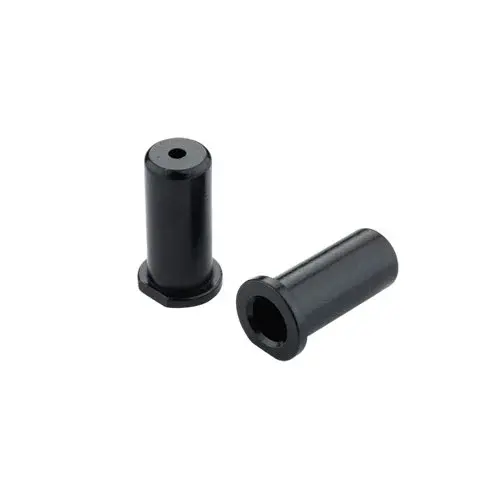

I’ve come across alloy housing stops from Jagwire that’d fit the bill perfectly in theory, but I don’t know what their OD is and am unsure if they would fit. None of my local shops have them in stock (or anything similar for me to try/measure), I’ve also contacted Jagwire to no avail.

I had a bag of those Jagwire stops and they are HUGE. They might be too big for the cable guides on the Kona.
ProFlex stops or the re-pop Yeti stops may fit. (good info here from andym999: https://www.retrobike.co.uk/threads/andys-proflex-856.452006/page-2)
wadsy might have some of the ProFlex cable stops in his spares bin.
Good to know! Funny enough, I called a shop a bit away from me and they told me their catalog stated the Jagwire stops have a ~7.30mm outer diameter if I recall correctly. Far too large.
I checked out that thread - great information! Thanks for sharing!
