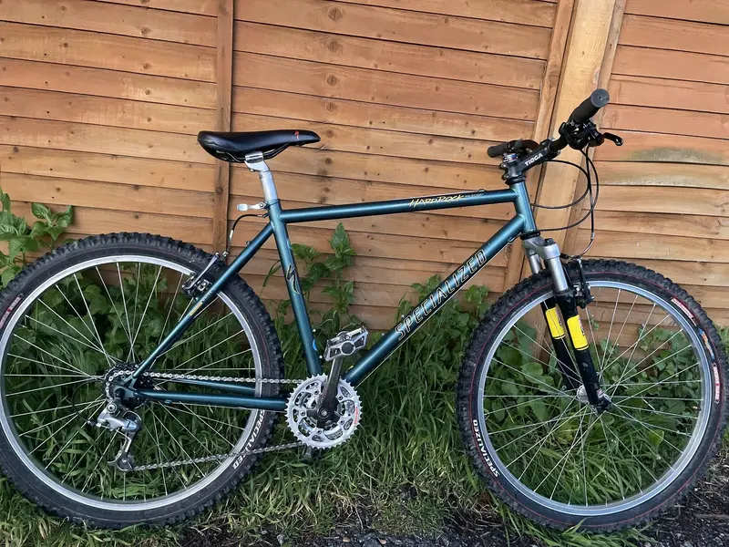

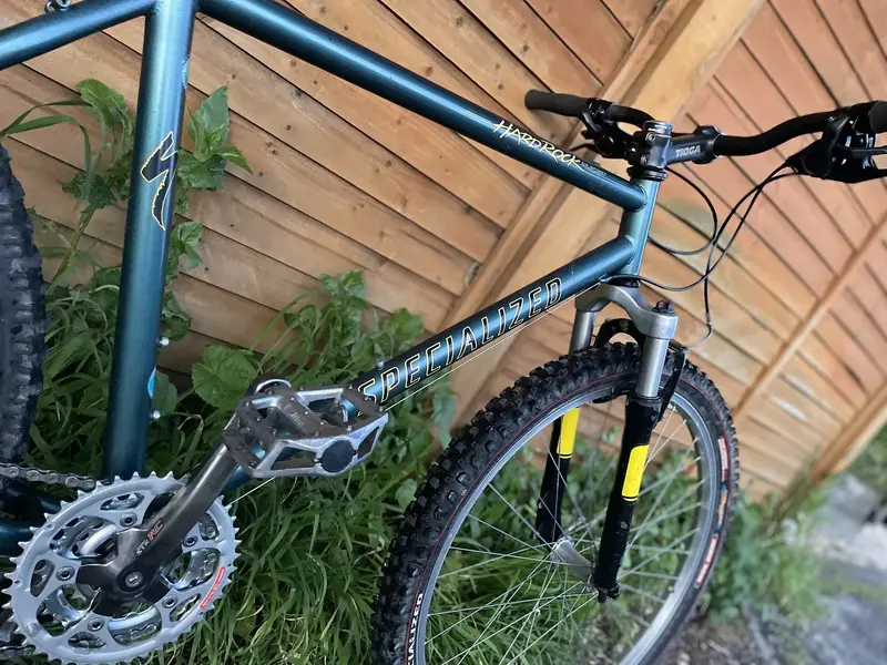

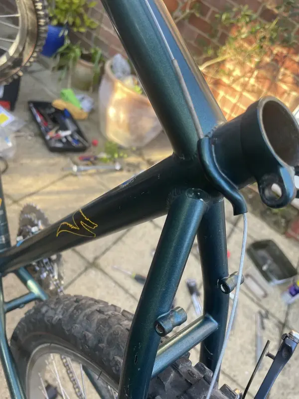

Not sure of the correct term for this but I wondered if anyone could suggest a clip on cable guide/stop type thing (or something that will do the job) for a frame that doesn’t have one. It’s a 1996/97? Specialized Hardrock gx sport and I want to put v brakes on it, it just has this little noodle guide. Cheers!

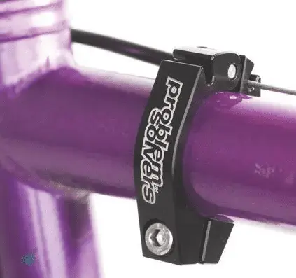

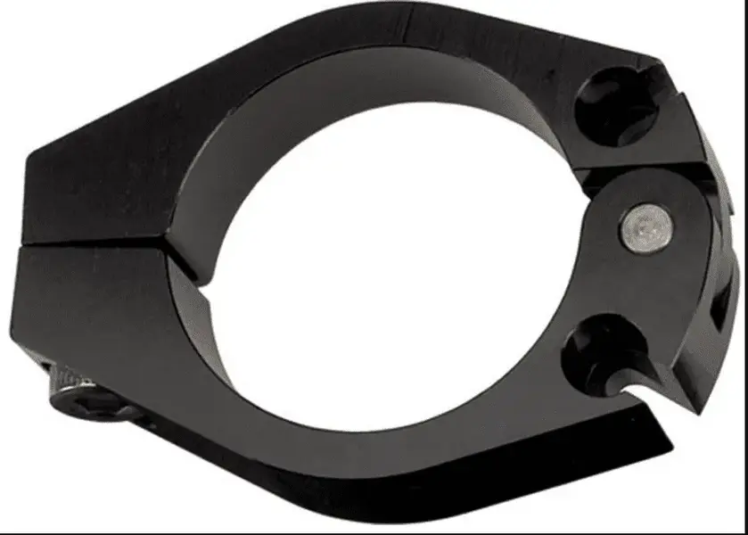

1. Top tube clamp on cable stop turns your top tube into something more familiar to a v brake cable run. May not look amazing but will retain the frames originality as someone might want to go back to canti one day
2. Same as above really but a Kona dog collar style version which are usually much more svelte in looks.
3. An adaptor that clamps to your seat post clamp bolt and extends down to provide a floating cable guide.
4. Step down cable ferrule? What's the diameter of the current guide? Could you use a stepped cable ferrule with the thin end in the guide and then the other end into a short run if outer cable to your brake?
5. Similar to the above but wonder if a v brake noodle would work? Perhaps even use a short flexible one? I do have some twp things that they designed to replace the noodle, basically a fixed curve within a light bit of alloy for the inner cable.
6. Pulley roller like the noodle idea. Would get the cable out in a much better position for the run to the v brake.

I used some plastic clips and zip ties from Amazon. I had to use a full length housing because the v-brake noodle was on the wrong side. Works great; brake returns with a snap.
I would start with full length housing zip tied on. You can initially protect your frames paint with some electrical tape. Use the bike for a while and if you need to move forward to a different solution you will have a better idea of what your needs will be at that point. Worst case in this scenario is you bought an extra bit of brake housing and may need to get a new brake cable in the future. In terms of function I think this will perform better than bolting a stop to your frame (that could crip tube or slide with force on the cable) or trying to use the existing noodle with a tighter curved v brake noodle. only downside I see is aesthetics.
