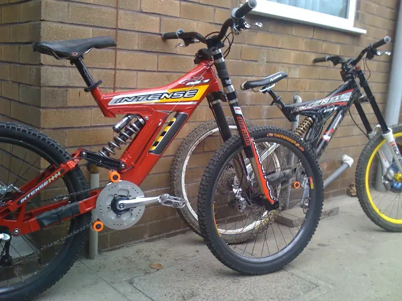

Had a few M1's but never really paid much attention to the serial numbers so not much use to you there. The frame though is the 01/02 model, 03 changed design and was built to run the 5th Element shock. Not positive on shock length on this version but think it was the 8.75 x 2.75, memory is not what it was.
Shot of my 03 along side the earlier. You can see the difference in the frame design, the 03 has longer/bigger gussets around the shock mount and a smaller and different shaped gap in the frame itself. Your frame being the same model as the black one.
Great info, thanks! The pictures have me pumped to get it built too, the bikes look awesome. I actually thought about running a Dorado but I had one on a VPfree I built a few years ago so have checked that off my bucket list!
That's an '00 or '01, i.e the first gen of FSR M1. The '02/'03 both included the 5th Element shock and revised shock mounting boomerang gusset per the pic of the red one above. ETA that the later frames also came with a significantly thicker head tube with less relief cut into the recess as the earlier ones had a nasty habit of ovalising. I stuck a CK Steelset in my '02 when I first built it up as a result of the reputation the earlier FSR frames had and regretted it as it was such a nightmare to get in, and of course wasn't ever coming out.
