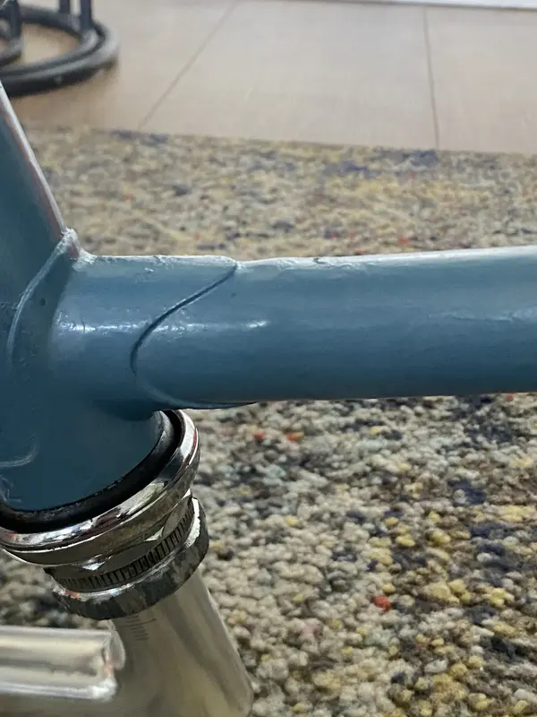

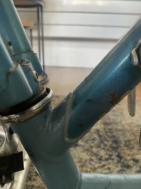

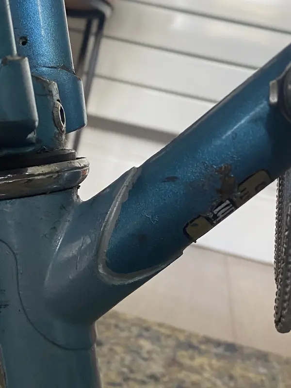

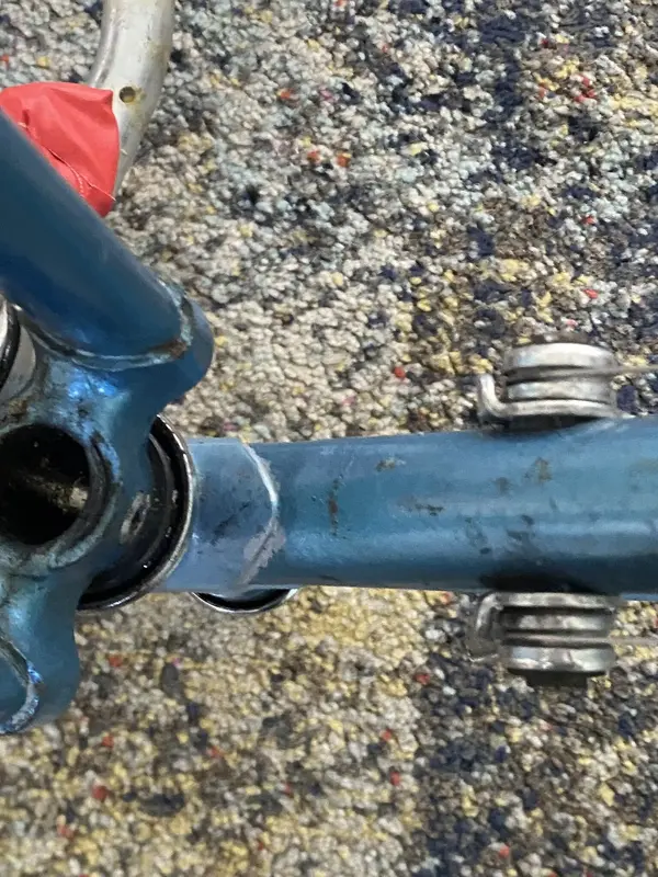

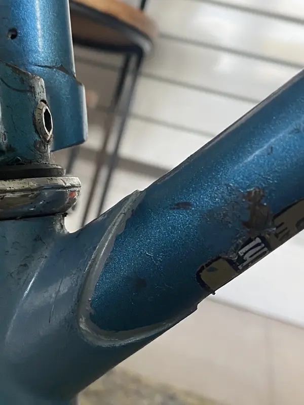

Thanks for clarifying. There is definitely a small bump on the underside of the top tube behind the head lug. Very small, could be rust hidden under the paint? The bottom tube also has a tiny bump and there is play in the headset. Is this sort of thing repairable or should I be returning it to the seller?

Sam, The bike has had a bump and he head angle has gone up 2 or 3 degrees. Still perfectly rideable, but the frame geometry is not as original. If it feels OK to ride negotiate with the seller. Many on here will say its not rideable and dangerous, but it looks useable, although
I cannot say without seeing it.
Does depend on how the seller listed it.
Keith
I wouldn’t want to be riding that full pelt down a technically challenging hill where you need good handling skills… hitting medium bumps over time would also risk the frame giving way….
You’d need to remove the paint to see what’s going on properly but I’d certainly not be risking riding it not knowing the previous history & at the end of the day you want come home Safety to your family & loved one’s..
