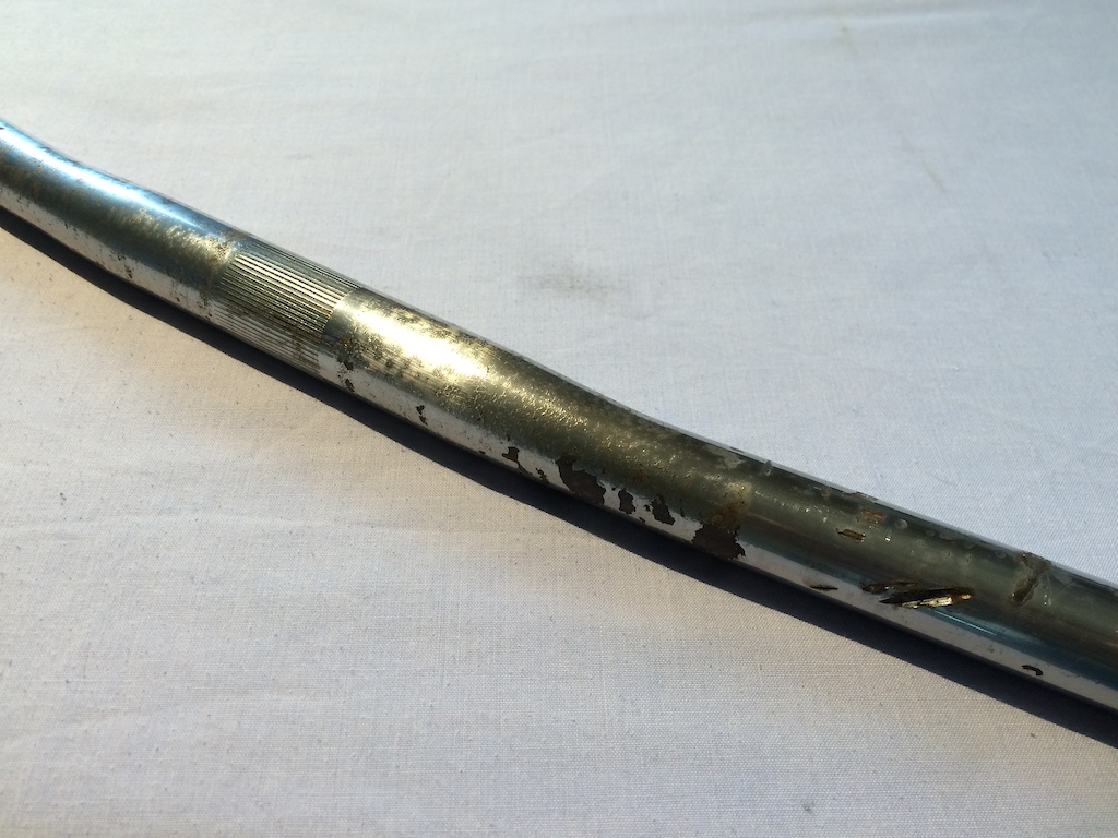

Bars on the other hand can go in the bin now :facepalm:

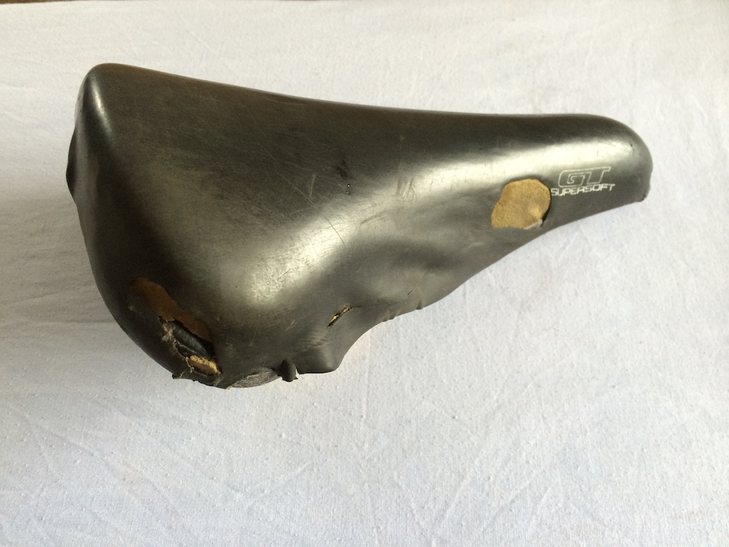

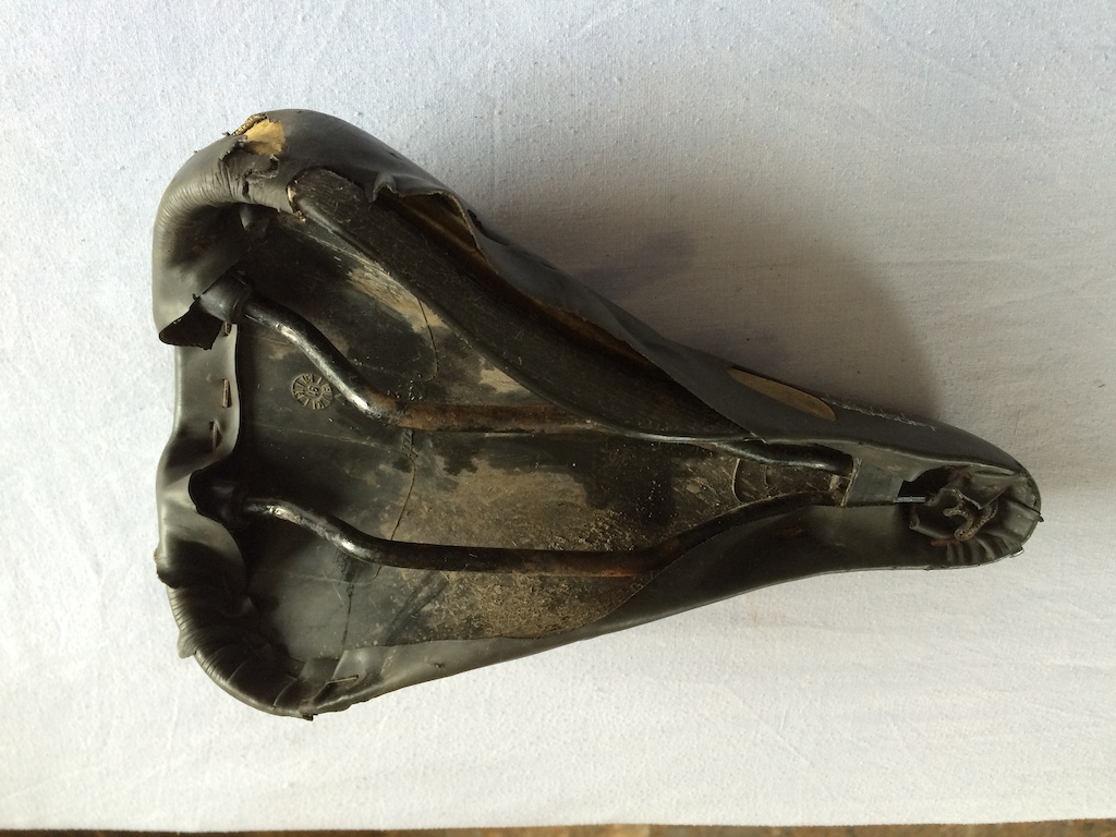

Still not sure I'm feeling this one but have already spent more than it's worth so I guess I'll see it through. Wheels are definitely not original (nutted axles, screw on freewheel and Quando front hub) and seat is toast as the padding was shot but I may have some spare foam somewhere (guess I'm really just looking for an excuse to buy that Brooks :oops: ). Somebody stop me! :facepalm:
