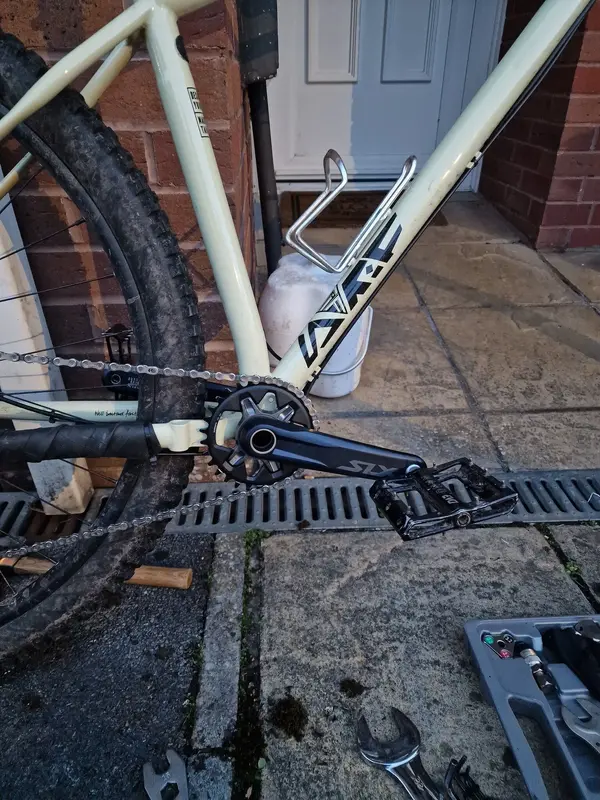

023 - you might find this helpful. I can’t track down the original study, which I read at the time - where they used experimentally 145 to 180 cranks. But this is a good summary of the main findings. They found little difference regarding power output and impact on energy in the joints, which is very important. They did recommend going from 32 to 30 front to up the cadence. In the original study, there was a long discussion of the kinetics of rotating your legs. If you are tall and therefore have large leg mass, longer cranks (the old assumption) means you have to rotate all that mass through a larger circle, with more hip rotation. Smaller cranks reduce this effort, which is biodynamically far better. Very interesting, Hope have looked at all of this and are promoting 155 cranks...for sure if you have pedal strikes then shorten cranks - this indeed made a massive improvement on my Ragley, which with 170 cranks tore up the local landscape with pedal strikes...165...very much better
Forgot to take a picture out on it, but 15 miler today. Very nice. Feels normal straight away. Very good climber. Low bottom bracket and short chainstays really shoot you out of the turns.
few pedal strikes, technique needs adjusting a bit. But very happy.
165 slx cranks on. Hoping to get-out for a decent ride Sunday see of 1cm cranks make difference
Hey...nice
As I mentioned, moving from 170mm to 165mm on my Mmmbop made a world of difference re strikes. And that was only 5mm. The reduction in leverage, the change in position when standing, and the increase in cadence all felt very weird for the first few hours, and now I do not notice these things AT ALL on the bike.
Raise the saddle a bit, drop a gear, up the cadence and all's well....
Do post up your experience....
