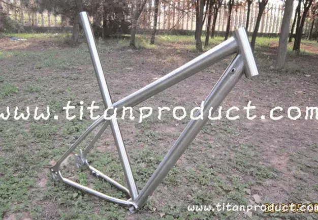

Hey guys.
I've done my research into getting a custom Ti hardtail frame made. Lots of choices in China and many more elsewhere but my budget doesn't allow for that right now.
In the end I have gone for a frame to be made by Titan. I intended to order a frame a few years back and didn't get round to it but paid my deposit yesterday and looking forward to updating you guys on how the frame comes out when I get it.
I have opted for an integrated seatpost this time. No real reason other than I like the look of it and never tried it before.
The total price will end up being about $1200 which includes, both sets of interchangeable dropouts, the Ti seatpost topper and shipping to the UK which is about $260 - so in terms of cost, if the frame lives up to what I expect, then it will be great value. My rides are mostly tarmac and paths because the majority of my mileage is commuting I don't ride so frequently on my days off although when I do, its mostly in the New Forest.

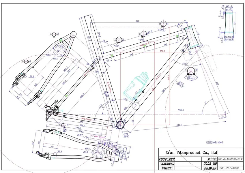

Anita sent the frame drawing. Overall, I am happy but there were a few things I have asked to be changed:
Move the bottle cage on the downtube upward and put rivnuts onto the seat tube so I can have two bottles.
Asked to have eyelets on the chainstay and seat stay bridges so I have the option of full mudguards in the future.
I've also queried the ISP length. My saddle is at 740mm from the centre of the BB to the top and the drawing shows the ISP as 400mm. I imagine that should be okay once the seatpost topper is in place but best to check.
Also the ISP is 34.9mm, so that is gonna be quite stiff. I don't think that'll matter for the riding I mostly do though.
:eek:
Should add that I've oredered 2 custom Ti frames in the past so know how much agonizing goes into all the details, so sorry if I'm not helping here... I'm sure it will be fine with a nice supple rear tyre.
:eek:
I've used 34.9mm posts in the past on hardtails. I can't remember those times well enough to say I remember it being that stiff, or noticeably stiffer than my usual 27.2mm posts. But i guess since this is an ISP, the rigidity will be noticeably higher. My saddle has some squish but i mostly ride on the road so I think i'll just need to see what it is like when i get it built up.
