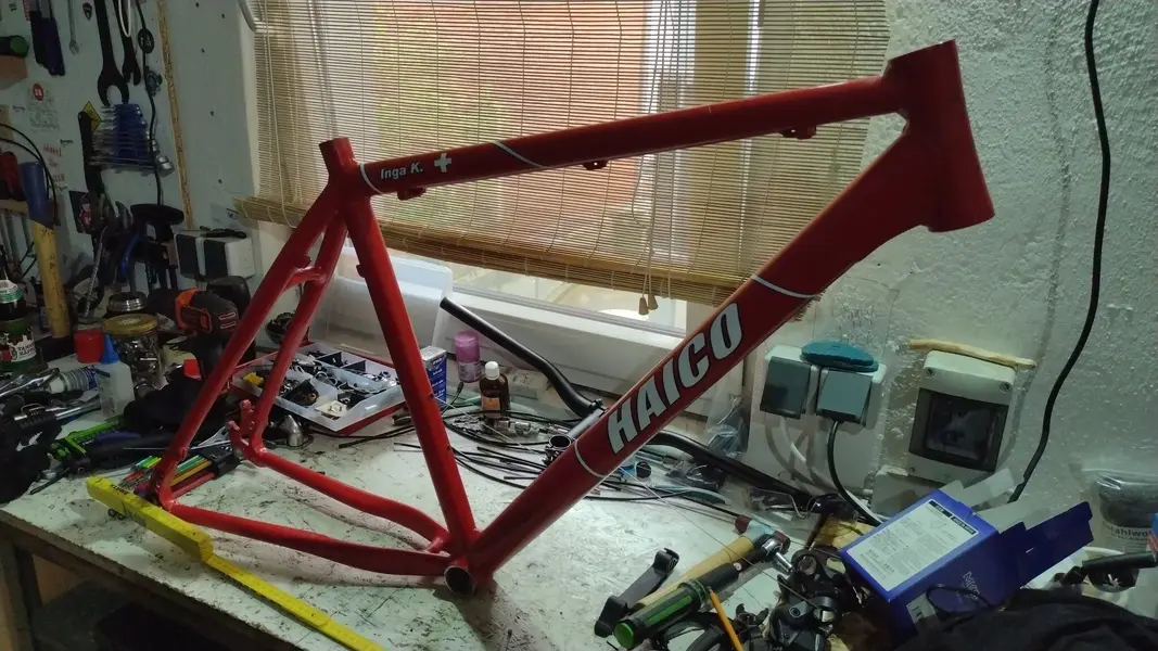

My lightest frame is a Haico Custom size 51cm c-t that comes at 1.695g and thought that was good... IMG_20230502_113815.jpg IMG_20230502_113455.jpg
That’s not bad at all Kay…

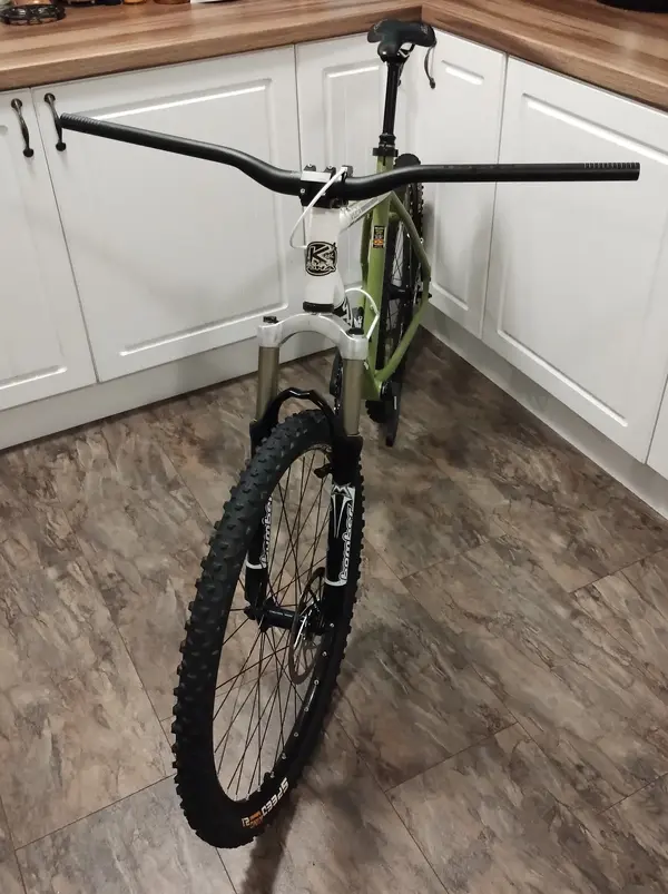

Some great progress on the Kula recently with some parts arriving - I really love it and have been able to sit on it now the wheels are on and it is ace. Perfect fit and feels like I'll be able to chuck it around, and the Hope hub sounds really nice.
I was able get the original forks back on, with a low stack height stem and a different headset. Very pleased to have the nicer ones on. And with the cranks and wheels, with the old knobbly version of the Conti Speed King tyres, it is taking shape! Looking forward to riding it, and not too many bits left to go now.
