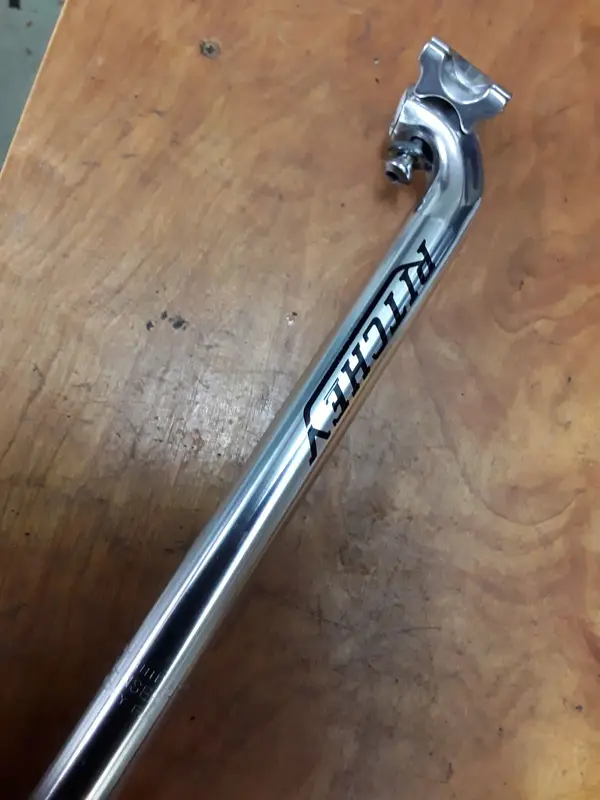

Seatpost sorted thanks to @wadsy ......cheers for divesting some of your fantastic quality stash.
Nicely in keeping with the original marin styling.....but long enough for me to actually use 🤣.

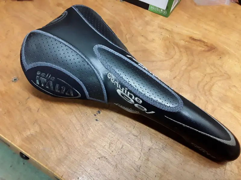

Going with a good old favourite saddle to. Flight gel titanium. 30g heaver than a normal flight, but 50 miles more comfortable!
That saddle seems to be in very good nick. I had one of these (and still do somewhere) on my last 90s race bike and remember it got pretty shreaded/worn quite quickly. Never had any comfort issues with them, although I haven't ridden one in quite a few years now so not sure if my bum is as Flite compatible as it use to be 😜🤣
I always thought that it was just lucky that flights fit my butt......
Then I realised its the other way round.... 30+ years of riding on them has MADE my butt flight shaped.🤣
