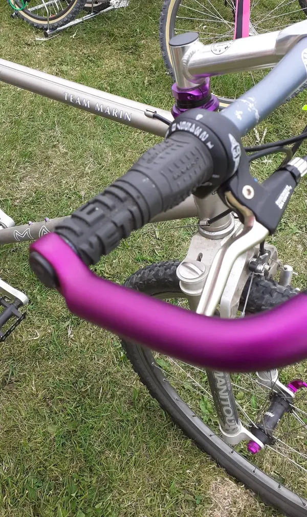

Hi I have just got a Team Marin 95
It has some Manitou Mach 5 forks in it they are not great and to be honest Im not a fan of suspension forks, I used to ride a Marin Bear Valley zoltane paint finish when I was younger bought it brand new and was the best bike I have ever had, lovely ride ( was stolen many years ago)
I want a ridgid fork for the bike, (yes I know the Team Marin had lighter forks 730g I think) and I know they would be really hard to get a hold of, just wondering what my options are? The bike I have would need a respray. Never built a bike before but I am pretty good diy and maintained bikes before etc.... Not opposed to the bike not looking stock, quite open as to what look it will have, probably sticking with a 3x8 drive on it.
Thanks in advance for any advice.

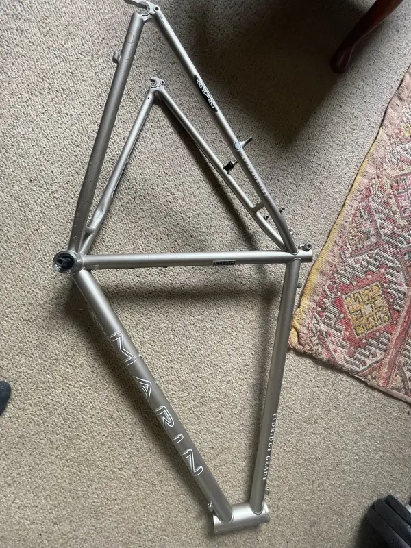

Hope OP doesn’t mind me joining in as I have a similar question! How do marin measure frames? I’ve got a 1995 eldridge grade that I’d like to get some forks for , it measures 19’’ centre of the crank to top of the seat tube. Not sure if marin measured them like this though?

That would be a 17.5 in Marin sizing :)
Sure, marin published sizes from centre to centre from 1990-1995 steel frames. Aluminium half an inch differently.
Indeed, you have a 17.5" marin.
For riding, there isnt much in that size and 19". You still have a face down race geometry. Things got different by 1996 but still, a low rise stem was the factory fit.
Anyhoo, enjoy what you have. These frames are easy to get built with plenty of 90's LX, sugino and no awkward sizes for headset and seatpost.

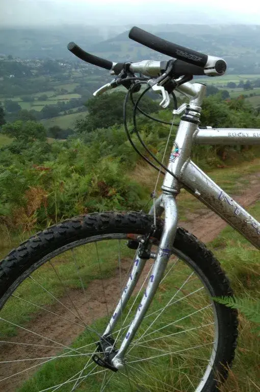

On a previous setup. I put these very silver forks.....
On this very....err champagne silver team. Fit well with a low stack ritchey headset.
The colour thing didn't bother me. 13 miles through Yorkshire mud and it all looks the same.
The 750g rockstar forks, did just about weight 750g....but only in 15.5" size...😂.
By the time you got to 20.5" xl frame they are well over 900g....
