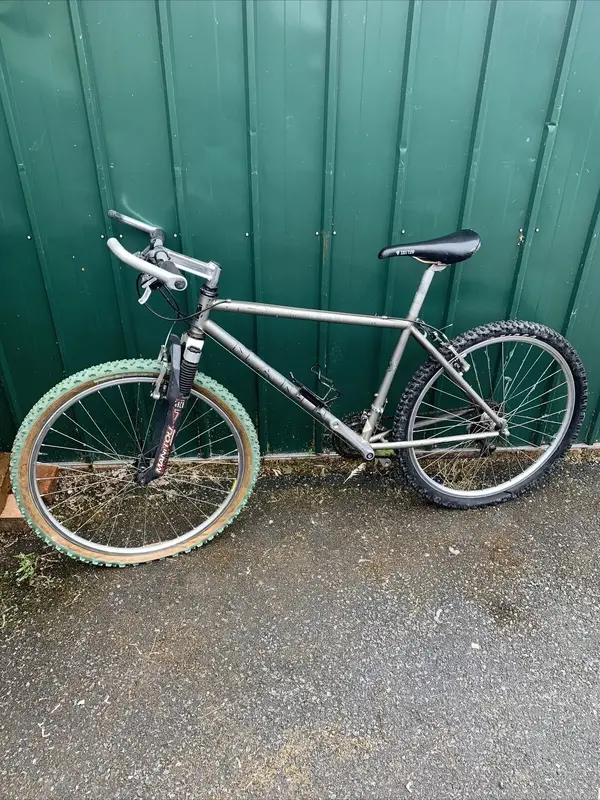

Good to know, I think it was a 1990 bear Valley that I used to have it was totally standard but great, I know this will be different, Newer frame and higher spec, what BB did you have? (if you changed from original that is) I will be running the same XT crankset or possibly fit a White industries that I have, I am currently slow stripping the bike down, I wll get it resprayed the piece it back together, will keep it 8 speed, possibly upgrade to XTR 9 speed if I feel the need to that is
Thtas what I got, needs some work but not too bad very solid and to be honest the rust and scratches aint too bad s-l1600.jpg
They are 68 x 107mm. Thats a certainty for white industries. Ive also run 110mm without issues.
Generally i hold out for XT un71, 72. Can be picked up for less than a 20 quid lump of un55, just to pick on a bottom bracket!
Ive stuck with 3 x 8 as, sram gear is just so suitable. Sram 9 speed chains work nice on 8 speed set ups. Sram cassettes are plentyful, cheap, light.
